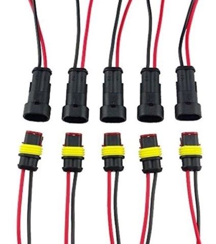

The connector (BMW 8366275-02 ) seems impossible to get at a "sensible" price so, unless someone has a better idea, I'll resort to "surgery" on my existing leads.
I always like to be able to put back the originals, so my plan is:
1. Buy a handful of 2-pin waterproof connectors in male/female pairs (available cheaply in UK).
2. Split the existing leads (near the connector) and insert a male-female pair in each.
3. Reconnect for normal use and wait for new nozzles to arrive from China.
4. Replace connector on the new nozzles with longer wires and the new type of connector.
5. Swap over to new nozzles by disconnecting old nozzles at the new split.
Slightly less tidy as each lead will now have a short "adapter" section in, but it will all be under the cover over the wiper motor. And no "empty" connectors.
Being lazy (and not good at crimping) I've ordered pre-wired connectors with reasonable tails on; they will just need soldering and a heat-shrink wrap.
