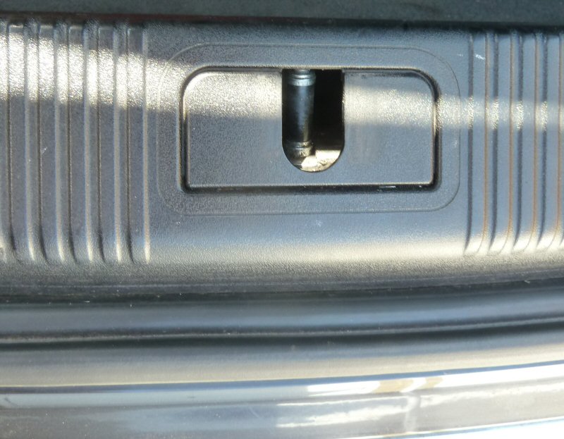

Sorry, I don't understand what you mean by the soft close motor.
The boot motor and cable that open and shut the boot are fine; my problem is that when the lock mechanism in the boot door comes down to meet the locking plate, there's no longer a motorised 'clunk' as the lock 'wraps around' the locking plate pin.
I'm hoping that someone can tell me what triggers the motor activation and what could have failed on my car.
Thanks & Regards - Julian

Old 20th April 2018, 07:19 PM
I think there's a micro switch in the latch part of the lock (your first picture). I had the same problem and sprayed copious amounts of WD40 in and it's worked ever since

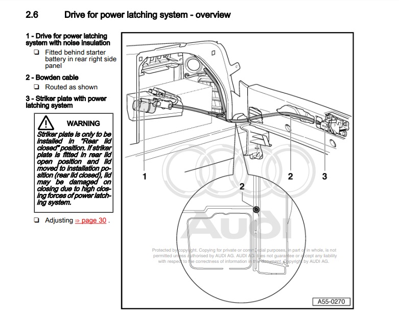

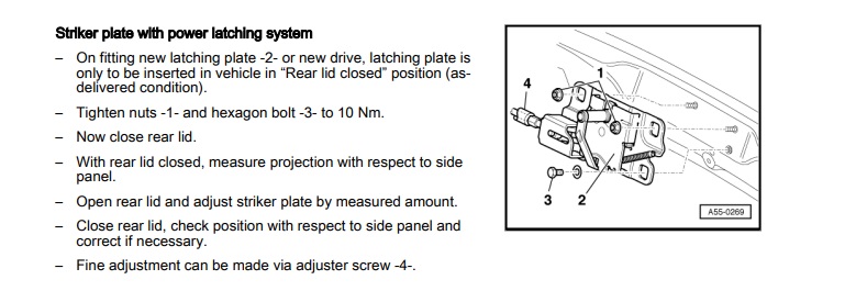

Its called "Power Latching System" by Audi and has a bowden cable going to a small motor - see pictures attached.

Old 22nd April 2018, 08:40 AM
Posts: 2,341
Julian,
There are two motors involved.
The one that Neil has pointed out is on all cars and is the one that locks the boot.
The other motor is the optional one that powers the boot lid up and down. This is for idle folk like me.
