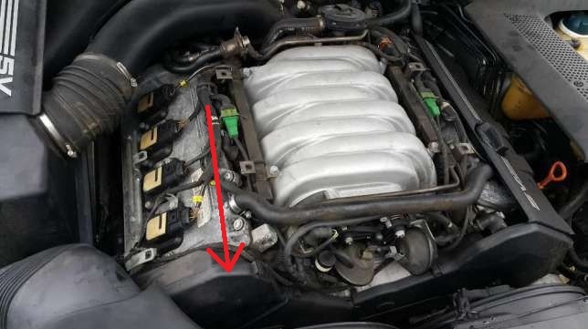

well , got round to ordering the G40
being a tyro I have no idea where the top of the timing belt cover is !!
presumably I have to take the cover off the engine and the timing belt cover is right there in view on the uk drivers side
tried to find a picture but no luck !
Old 16th November 2018, 03:10 PM
Behind this cover:
You'll need a T30 Torx bit to remove the sensor. Torque is 10Nm.
