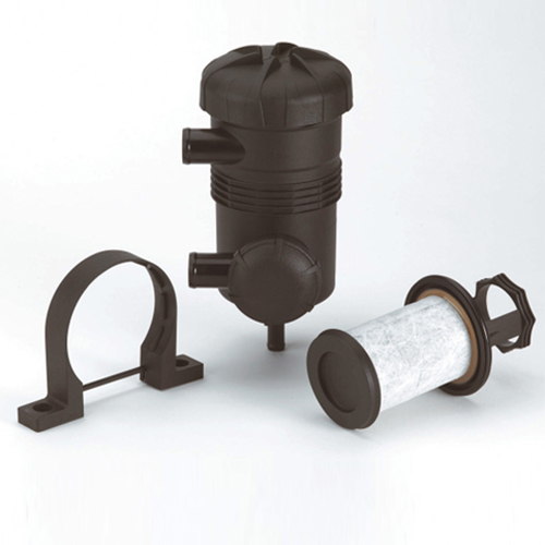

It seems I am mistaken on this as the FSI engines don't have EGR, contrary to many threads on the various forums. Lots of people call the secondary air valves 'egr valves' since they're in a similar arrangement to EGR valves on diesel engines, but in fact they work completely opposite to EGR. It appears that the FSI engines are in fact no different to the port-injection engines in this regard so all the crud that builds up is purely from oil vapour! Colour me surprised.
In that case, a catch can may actually help, but only if it removed all the oil vapour, which can be quite a challenge. Looking at the SSP for the 4.0TT it seems Audi have gone to much more trouble to achieve this separation than in previous engines to try and solve the problem. There is an aftermarket device which is commonly used on marine engines called the Provent, made by Mann & Hummel, which is also quite popular with the TDI crowd. If there's any space under the bonnet of a D3 S8, this might be worth investigating:

This may be one of those instances where I might just try it myself, and see what the results are like. Having watched countless videos of oil catch cans in use, I don't see why anyone would want to see this crud being fed back into the engine, if they had a choice. Fair enough, it isn't standard equipment, and then becomes a serviceable item, but if it helps reduce the build up of crud over time, then it might be worth trying.
One of the names I came across for 'quality' oil catch cans was Mishimoto, and emailed them a while back, with a recommendation from them on which of their models to choose from. I'll have to do some more reading on the ProVent, but a quick Google shows them as costing around the same £120 mark.
Since the S8 doesn't get used much, I might even put it in the 4.2 D3, as it's more of a daily use car. If it functions and manages to trap a significant amount of oil, then I can contemplate adding it to the S8 as well.
