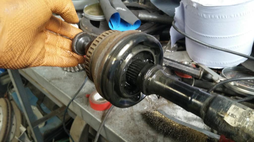

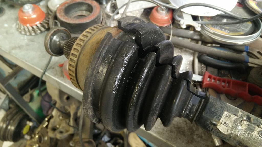

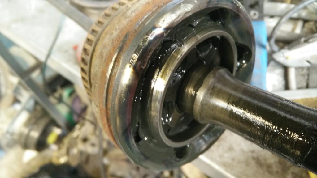

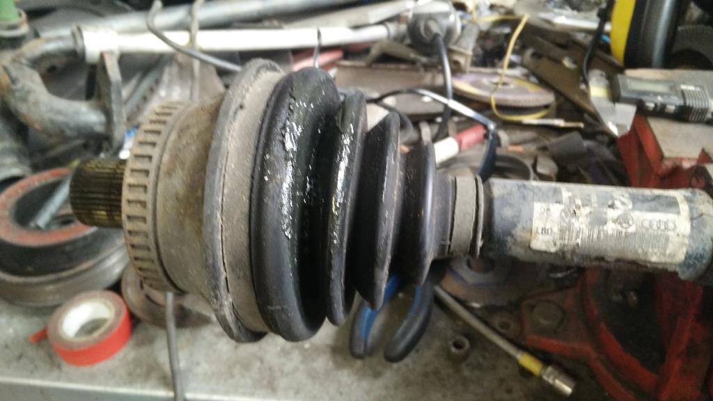

Both CV boots needed replacing
Clips removed
Cut the boot in half and remove it
A sharp whack to the centre of the joint with a chisel and lump hammer will pop it off the circlip

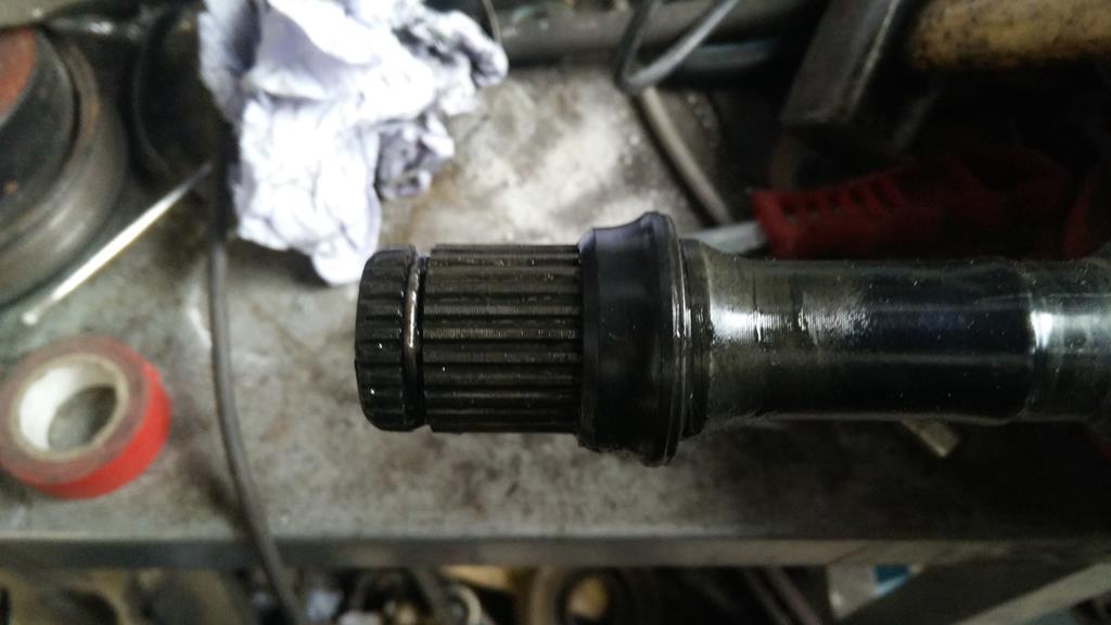

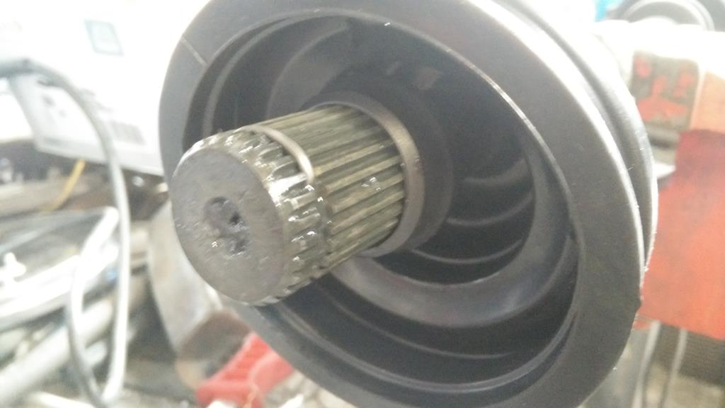

Slide the joint off the splines
The circlip is on the left. The plastic bushing and cup-spring on the right hold the joint tightly on the splines. These all get replaced
With the hardware removed, I put a plastic bag over the splines so the boot slides on without getting caught on any sharp edges

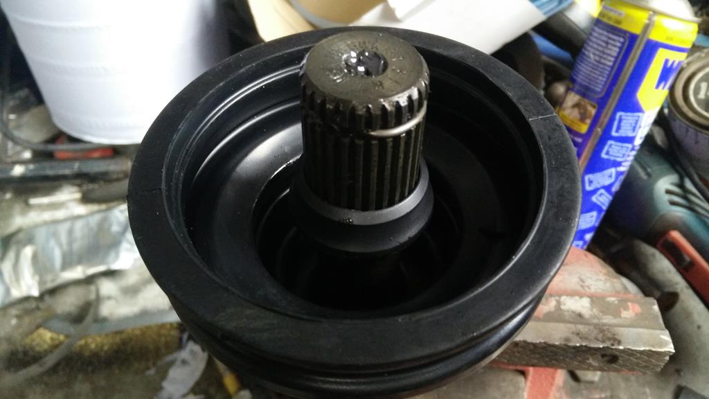

New circlip, bush and cup-spring
Rotate the shaft to vertical for the next bit

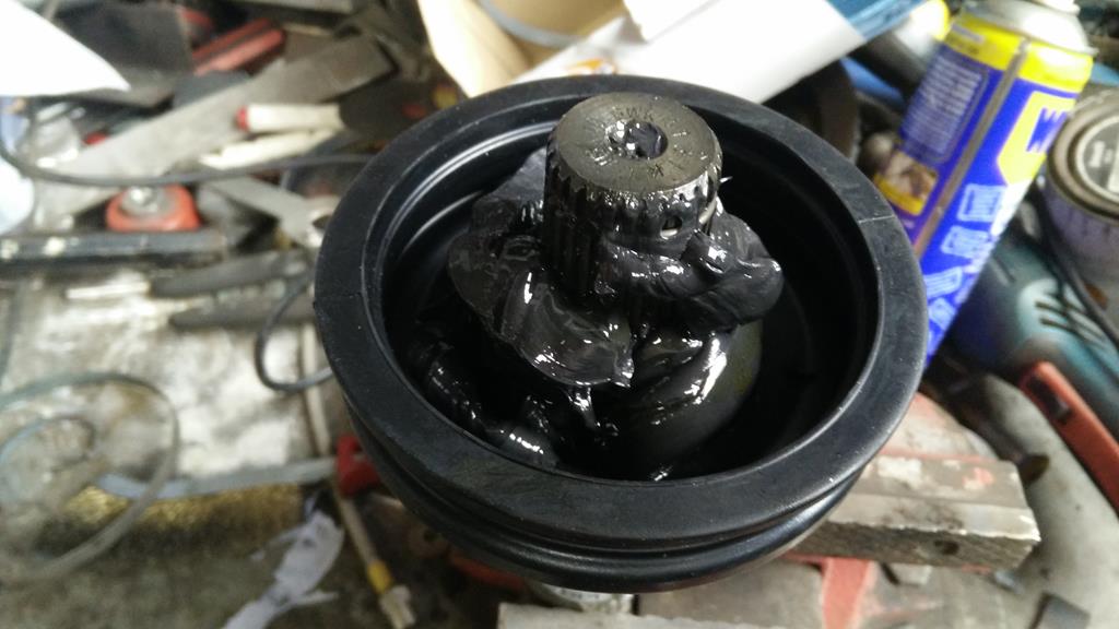

New grease
The joint is just sitting on the end of the spline now
Put a spare bolt in the end of it to use as a drift
Another sharp whack with the lump hammer knocks it over the circlip and it's locked in position again

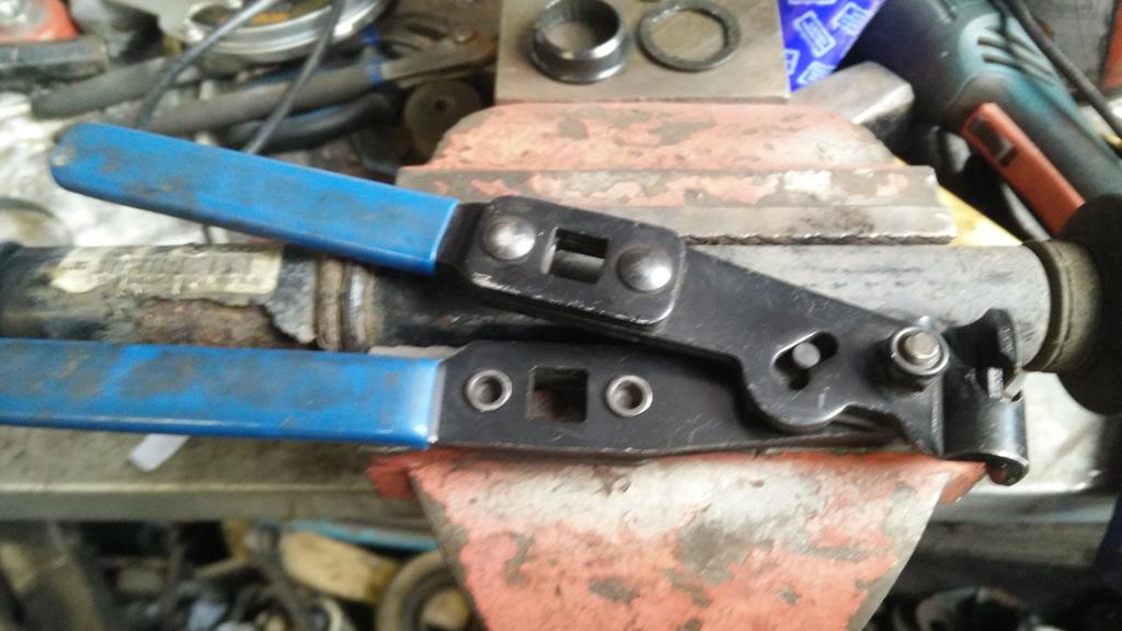

The new boot is held in place with the proper crimp clips. Any mechanic who uses cable ties on CV boots should have his tools confiscated
This is the proper tool for crimping the clips
On to the other side. Not only was this boot held on with a cable tie, but whichever donkey had messed with it had beaten on the outer joint with a hammer and not bothered to to replace the bushing or cup spring so the joint was loose on the spline I assembled it properly of course. It is trivial to do this stuff properly, and a OEM GKN Lobro CV boot kit is £10. Why bodge it?

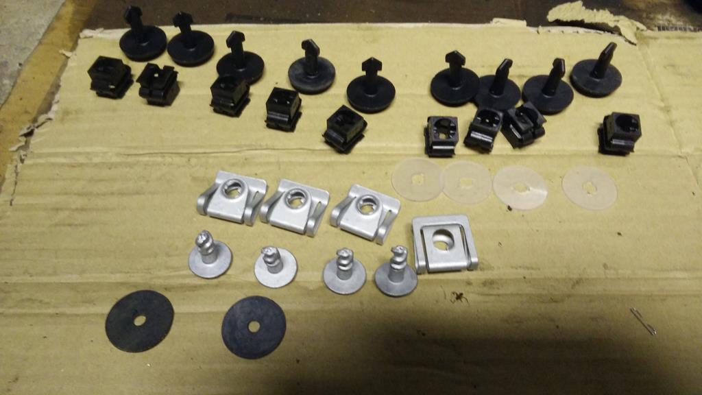

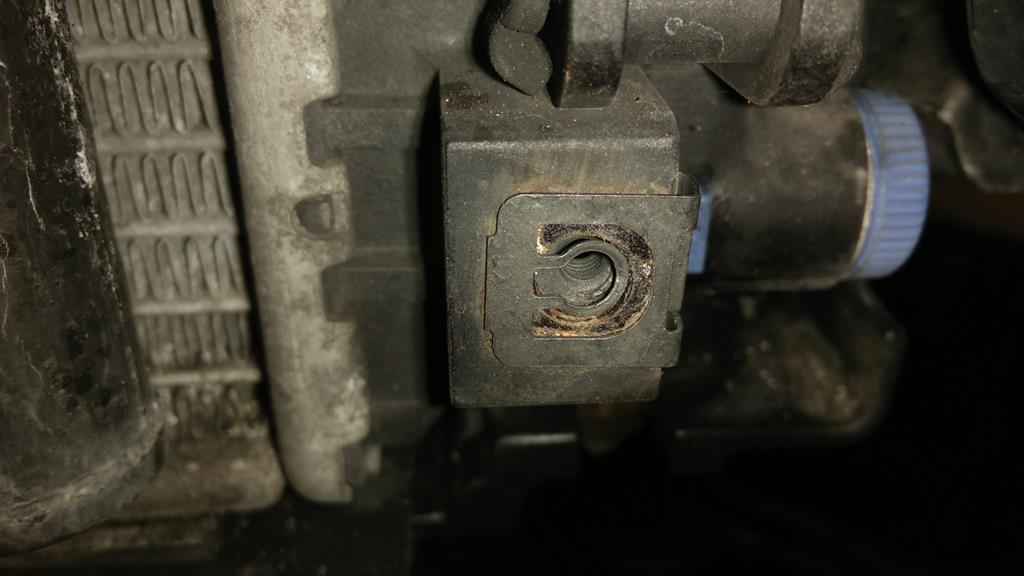

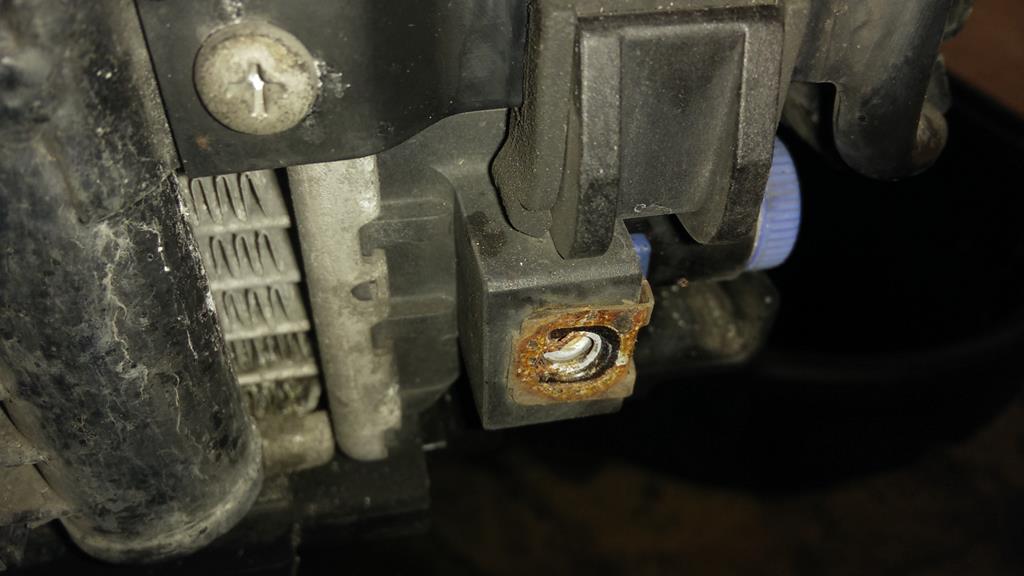

When I pulled the front panel I noticed that the radiator air guide speed-nuts were getting pretty crusty:
I keep these in stock so replaced them
The undertray hardware was missing, broken or bodged so replaced it all with new genuine hardware

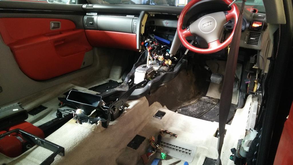

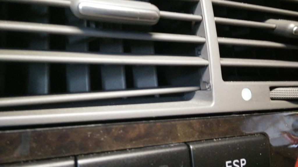

Interior stuff again - the centre vent was broken
The pin had broken off the end of the slat

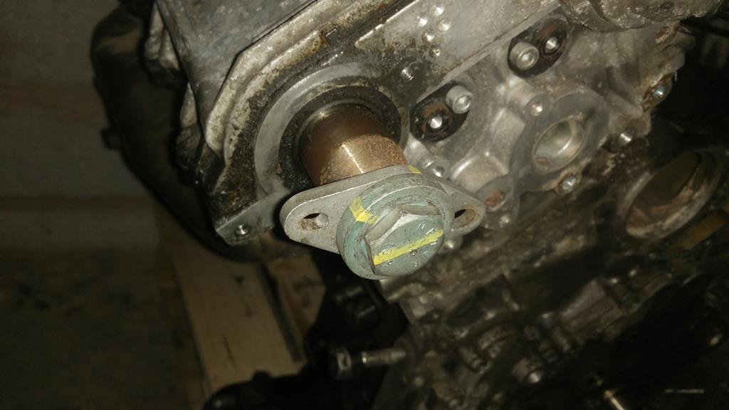

Cam stuff:
This is the cam sprocket attached. As noted, its a taper fit on the cam so held on by the torque of the bolt.
This is the locking plate. Both cams have flats milled on to them such that the locking plate only fits one way round, and its sandwiched between the sprocket and the washer under the bolt head.
This is the locking plate and bolt in place without the sprocket. The locking plate is loosely pushed on to the flats on the cam and then the bolt holds it in place
The right hand bank 1 cam will happily just sit there with no belt or sprocket. The left hand bank 2 cam though will rotate clockwise with very little provocation (especially on the V6), but generally won't move when you just take the belt off so its simple enough to dismantle everything to do the belt without it escaping. But, as soon as you loosen the inlet cam and chain tensioner, it will jump round on its own thus I keep the bar in at all times except when removing or refitting sprockets, the belt, or the water pump (because the bar gets in the way). Its not that important when only doing the belt though.
The engine in this pic ^ is sitting on a pallet with no timing gear and both cams are still lined up. When I pull it apart to do the tensioners, that's when I'll put the bar pack in
