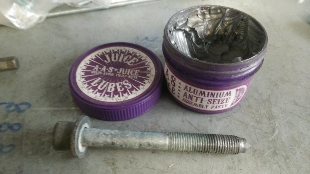

Not sure if I've shown this before? On most cars you would use copper anti-seize grease with steel bolts in to steel nuts. Not so with aluminium threads in the D2 though, as the copper will accelerate corrosion, not protect against it. Instead, for the D2 I use aluminium anti-seize in certain places. The front panel to the chassis legs for example, the subframe to body bolts, or here for the main bumper bolts. The aluminium grease stops corrosion because it doesn't set up a galvanic reaction. There are some places where steel nutserts are used (the battery junction box for example). These do use copper grease, so its important to know which is which.

Surely i'm not the only one that raised an eyebrow at the name of the Anti seize paste.
AAS Juice - Helps avoid tight nuts
