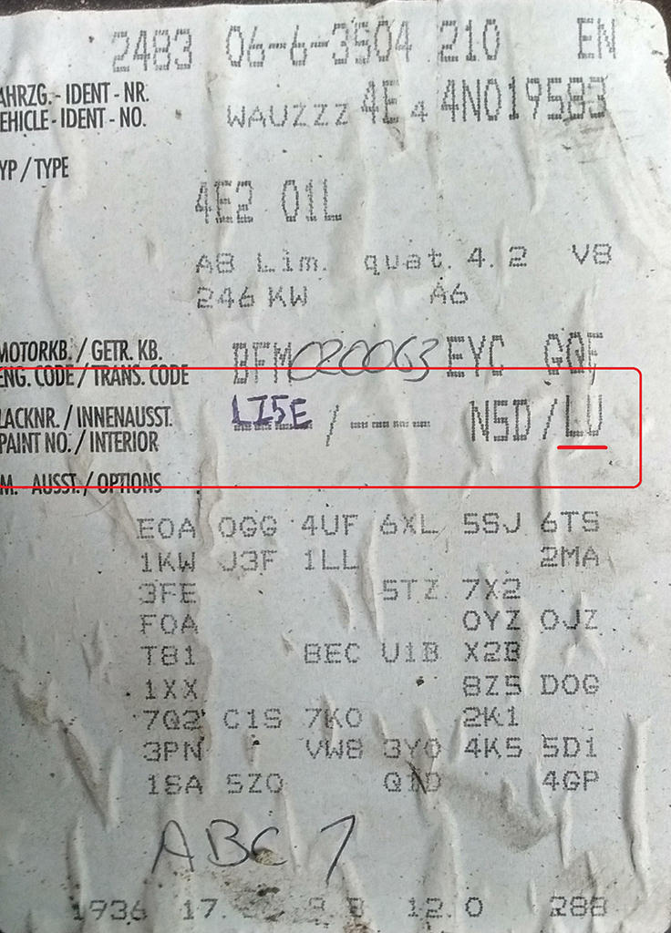

According to ETKA, there only appears to have been four (standard) colours available for the floor mats. These are:
Soul (black) - 8A6
Indigo blue - 8B7
Light platinum (grey) - 8C8
Torrone (beige) - 8D9
This would also match what it shows in the brochure. Check out pages 44 and 45 of this document (A8 - May 06.pdf) in the D3 Tech Dump thread.
One final check is to look at the build sticker in the boot. Go down to the section marked 'Paint No./Interior', and at the far right should be a two character code. Cross reference that with what is on pages 44 and 45.
Assuming of course that the mats haven't been changed at some point, then you should be able to identify the correct colour.
