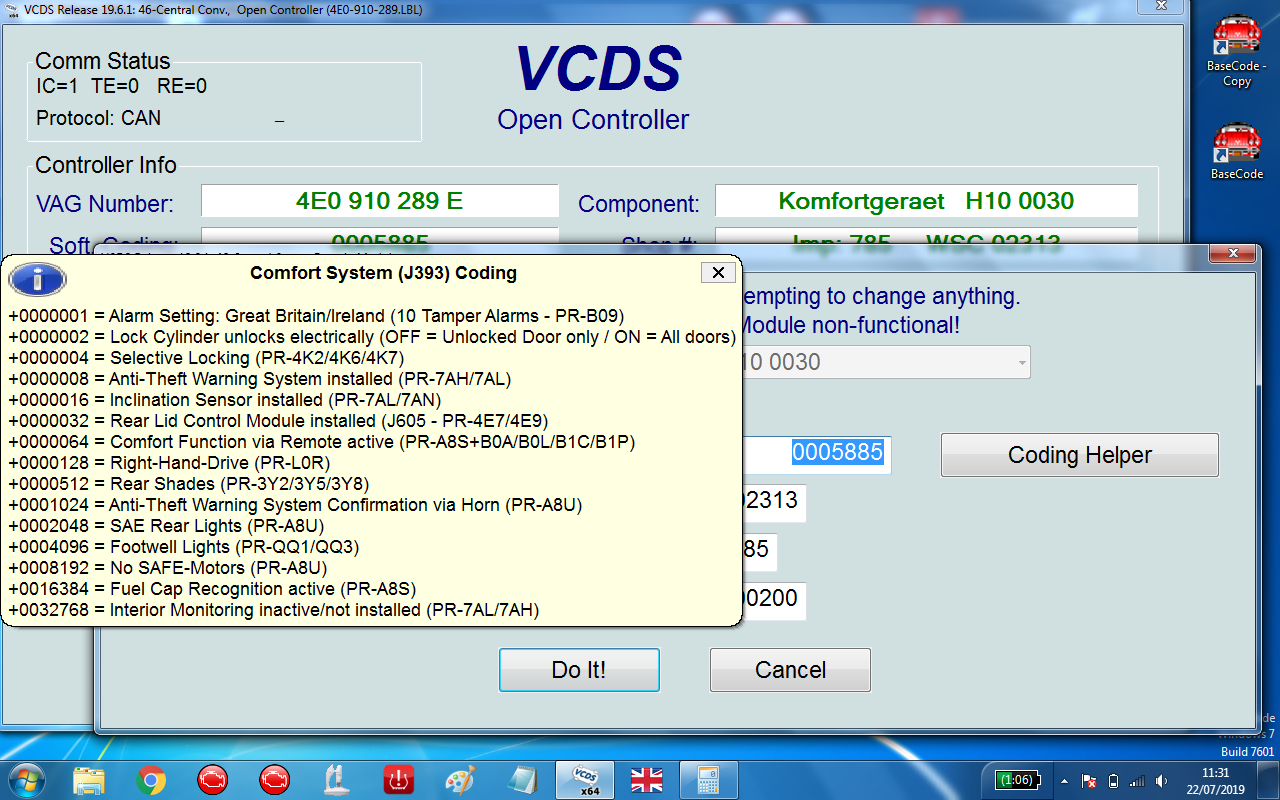

You can do it, but you will need access to VCDS (Carista or ODBeleven may work, but I can't confirm).
Within VCDS, go into module 46 - Central Convenience. Click on Coding, and you will presented with the following screen, as well as a pop-up hint window. Make a note of the existing value you have (e.g. 0005885 in my case, which has it enabled), and then add 1024 (Anti-Theft Warning System Confirmation via Horn) to it. Then click on 'Do It!', and then exit out of VCDS as normal.

IIRC there is no chirp on the D3 A8 - it's a short horn toot or no horn toot.
Happy to be corrected.

It does chirp, well beep really as I’ve done this with mine

It is a chirp from the alarm sounder, not the horn you use when driving.
