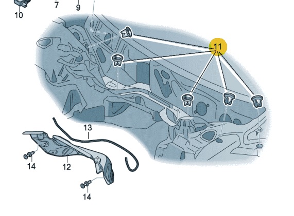

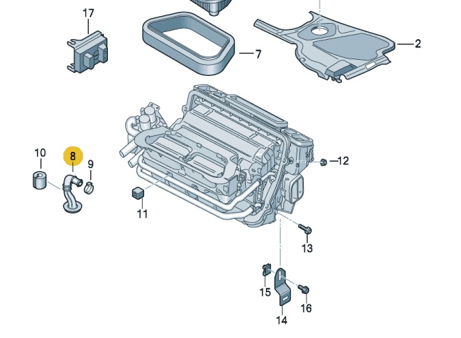

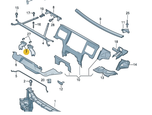

Old 20th November 2019, 06:35 PM
Posts: 3,238
Originally Posted by H-M3 View Post
Any diagrams of the drains peeps?
I wasn't sure if you meant for the D3 or D4, so I've provided both sets. The sunroof one looks identical in both (the illustration only shows two, but they're mirrored on other side).
