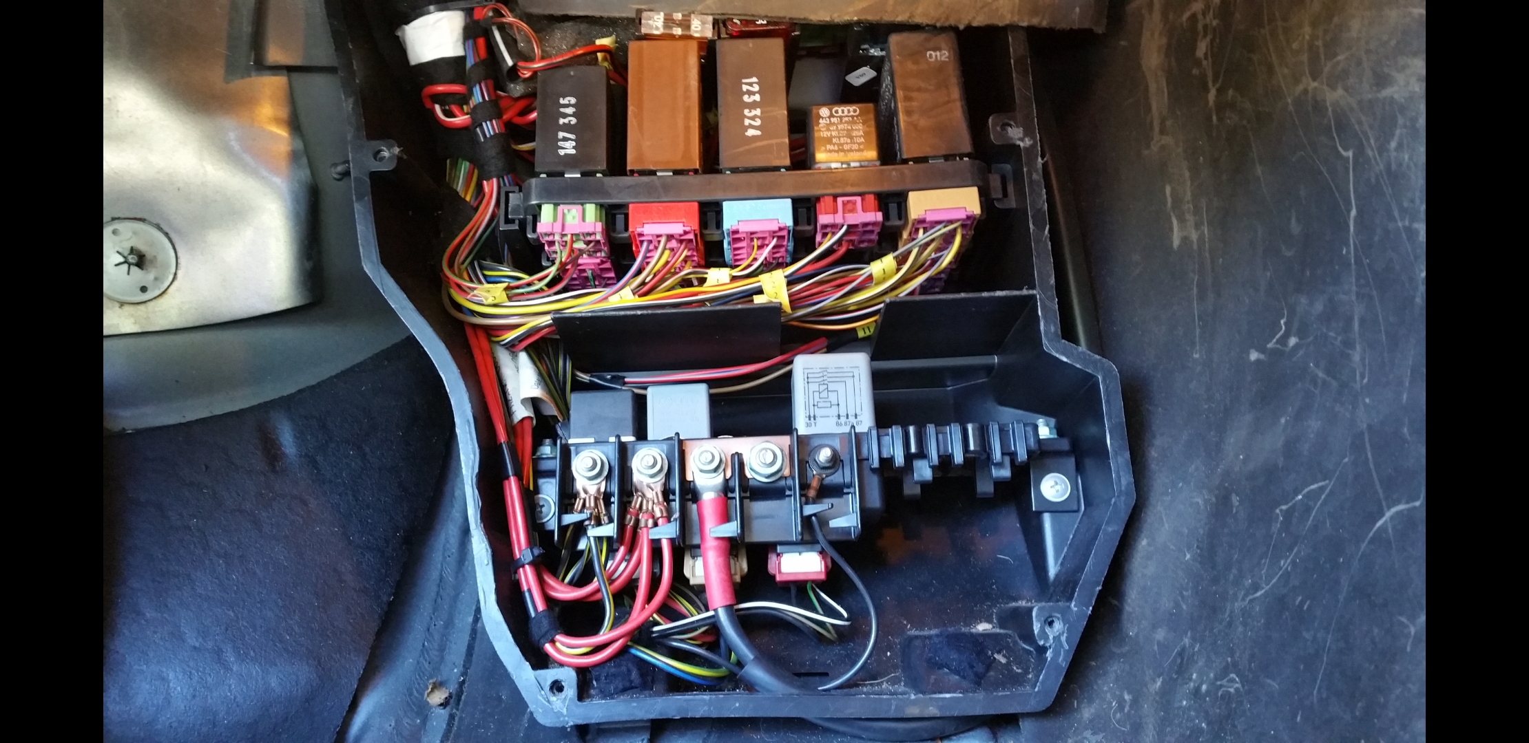

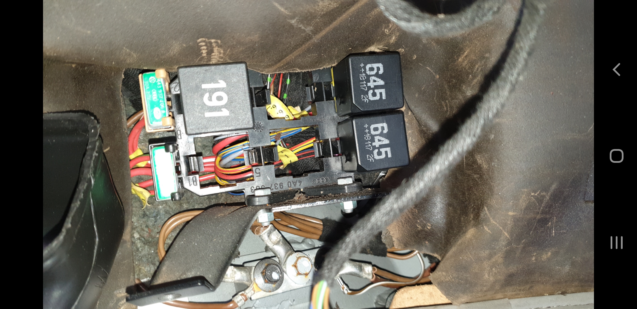

Not sure if any of these pictures help but someone in the know may be able to describe your relay location.

Useful pictures, many thanks for those, hopefully someone can point at the exact one.
I'm just wondering if it could just be that the relay itself is faulty?
And is this what would be known as the starter relay (as opposed to the starter solenoid that activates the starter motor)?

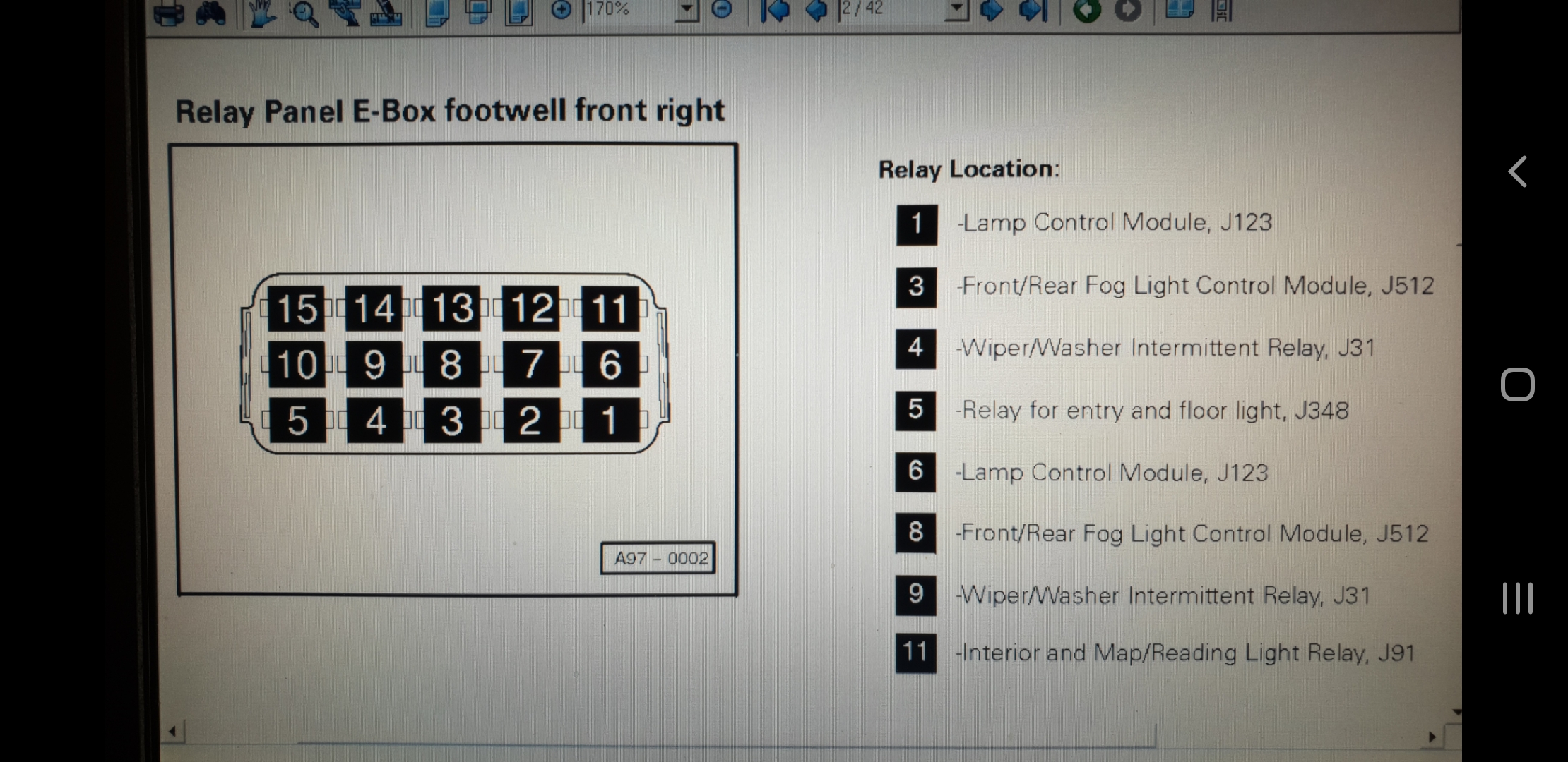

These illustrations may help out as well. One is from the current diagram PDF with a reference to J207, and the second is from ETKA showing in which board it's located in the footwell. I've included the part number in the illustration to confirm the correct relay, which a quick search seems to show it as a tall black relay with 297 stamped on top.
Sean are you sure about the ETKA illustration?
That gives a part number of 443 927 351 B which it describes as "Control Unit for Gearshift Lock". Isn't that the thing that stops you moving the gearstick unless you put your foot on the brake?
And what A8Parts are selling is "Audi A8 D2 Shift Lock Control Relay 443927351B" which isn't exactly clear either. Or did this all change between PF and FL and it's the same relay doing a different job?
Didn't MJ say earlier something about it not being where it was documented? Yes:
I don't appear to have a photo of it unfortunately. Its J207 which Elsawin claims is top left in the relay panel in the footwell. I remember it being more in the middle of that panel tbh.
You could be right! Maybe I was picking up on an earlier comment I'd seen here or on another forum.
Or maybe you are, remember I don't have ETKA.
I looked at the wiring diagrams I have in the Bentley manual and for FL cars the solenoid on the gear stick is controlled directly from the TCM, there is no relay.
The relay listed by A8Parts is identified as coming from a PF model, where a number of things were quite different.
Anyone know for sure if it is a 443 927 351 B that I have controlled by the F125 to inhibit my starter? I'd have a look if the weather was better.....
