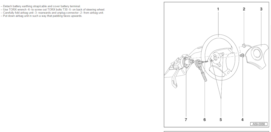

Also great information. Thanks very much! Not being overly experienced with Audi's - or cars in general- I have been accustomed to relying upon the repair manuals - ELSAWIN in this case.
I guess I am a little spooked at the prospect of the airbag going bang in my face. Thank you for your reassurance, ainarssems.
