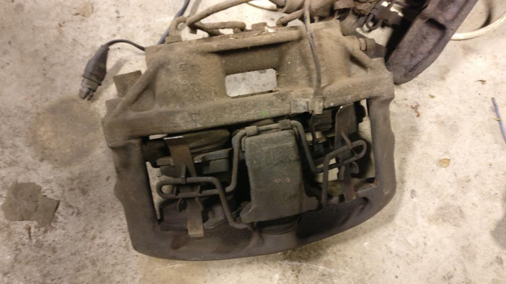

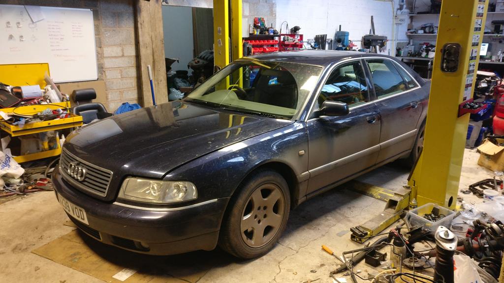

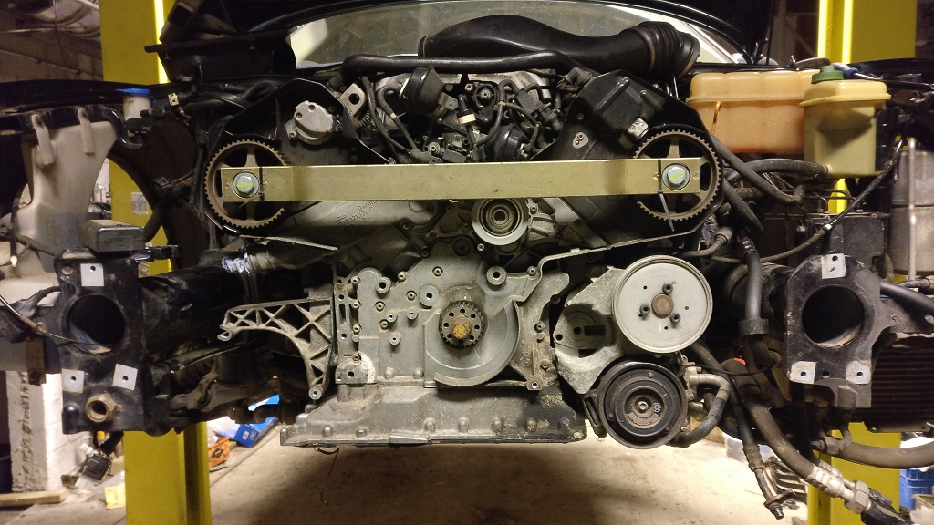

After doing sterling work as a loan car / daily driver, General Vod is back in the workshop for some pre-sale maintenance before he goes off to live with Bert
He needs a bit of a bath too, after bimbling around the lanes of Devon for a couple of months!

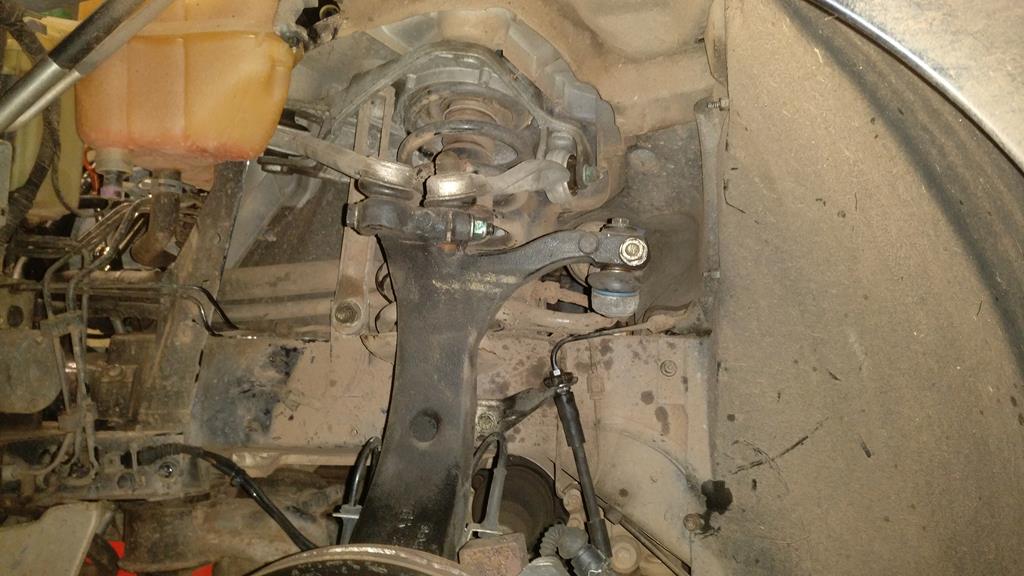

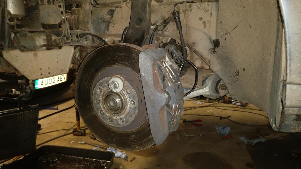

The first job was suspension (which creaks) and brakes (which squeal). The original calipers were pretty crusty and one of them was partially seized which explains the squeaking.
Mike came over to help and between us we swapped both complete front corners from Sergey's 3.7 as this was all OE parts in excellent condition. As Vod had a groaning bearing, and Sergey's front setup was the steel hubs from the 20" cars, we swapped the whole lot - all the arms, tie rods, uprights, bearings, discs and calipers. The only parts to stay were the springs and dampers as Sergey's was a sport and Vod isn't. As a daily for wafting around the countryside on 17" wheels and balloon tyres, there's no need for sport suspension Vod's factory sport recaros and comfort suspension is a lovely combination.

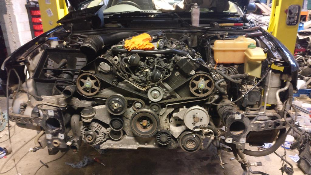

We got the suspension finished just after lunch so pulled the front end to do the timing belt.
Last done in 2010 - he's done 60K miles since then. As with the rest of the car, everything in here is in really good condition and was fitted properly by someone who cared about the quality of their work. Off-brand parts though, which will be replaced by INA.

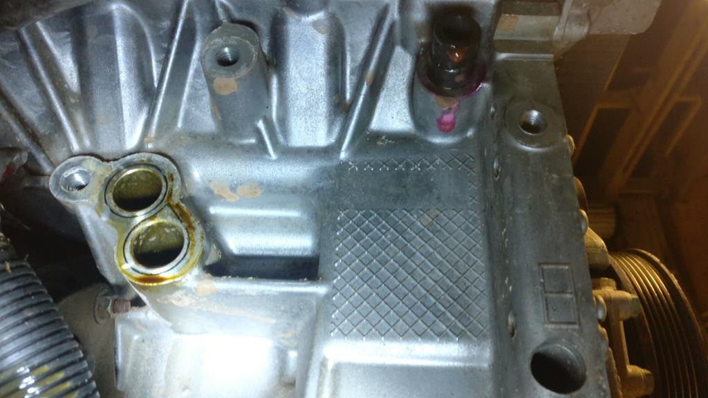

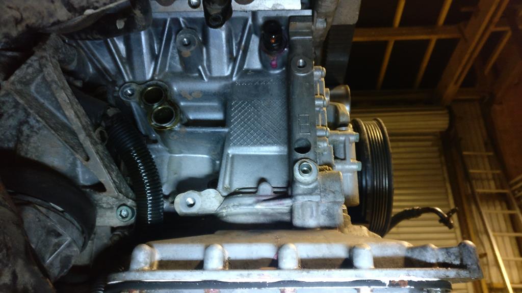

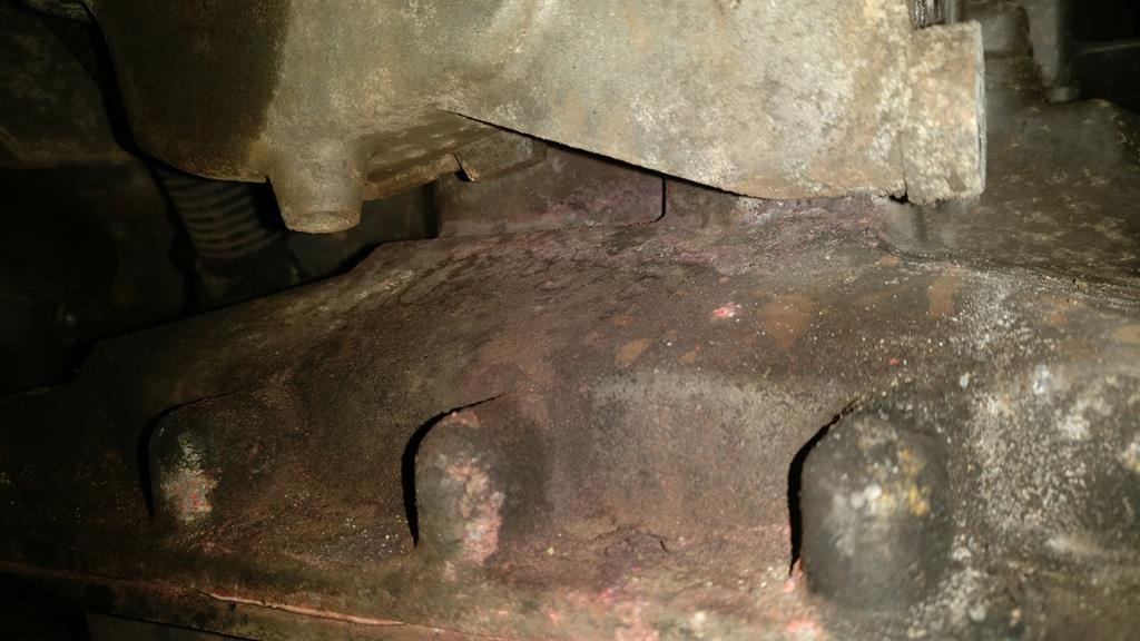

The first time I got Vod on the lift I could see the telltale pink stains which are indicative of a failed oil cooler pipe
Unusually the pipe was still intact, but it was leaking around the o-ring in the block. You can see the pink stain again here where its been dripping
Finished here for Saturday night
Is it worth doing this whilst doing the timing belt change, even if the existing pipe is not leaking? On the Audiworld site, it says it takes around 7 hours, which seems an awful long time.
O-rings? The pipe has four grooves, but the Audiworld site seems to only show two being used on the pipe and one on another part. It also mentions another o-ring they suggest replacing.
This is the bit that has me confused:
3 each O rings, part #077-121-437.
1 each oil seal/gasket, part #077-115-441.
I've provided a link to the page in question below:
http://www.audipages.com/Tech_Articl...reinstall.html
Where do you get the o-rings from? I'm finding dealer prices of £7 each, so was thinking of just buying a metal pipe with o-rings provided instead, like this one:
https://www.ebay.co.uk/itm/273203362499
  #35
Old 12th January 2020, 02:30 PM
It might take 7 hours as a standalone job if you stop a lot for tea and biscuits, but once the front end is off its less than 2 hours extra work, most of which is selecting the right combination of hex bits and extension bars to get to all the bolts. I do this pipe as a matter of course on an engine-out service since it's simple to get to.
A word of warning trying to do it with the engine in - the bolts have shallow socket heads (simply for the schadenfreude - there's no technical need for it) and while they are not done up to massive torque, they do have a considerable amount of stiction. On the engine stand I will always give them a sharp tap with a hammer before taking them out, otherwise they have a tendency to round off. If you rounded one in the car then its game over and engine out to recover it. Its almost impossible to hammer the hex key in to them because the chassis leg is in the way so I either used a long punch or an extension bar to just shock the top of each bolt, before tapping the hey key in gently. They all came out that way without too much of a fight.
The factory plastic pipe has a single o-ring at each end, and the water pipe which connects the cooler to the back of the engine has another of the same o-ring. The metal one has two each end. Your link is the same one I have in my grey S8 btw. I buy the o-rings 20 at a time from a bearing shop for pence each rather than paying the silly dealer price.
The oil cooler seal isn't available on its own any more. You can only buy it as part of a kit (077198405) which is four times the price and full of stuff you don't need.

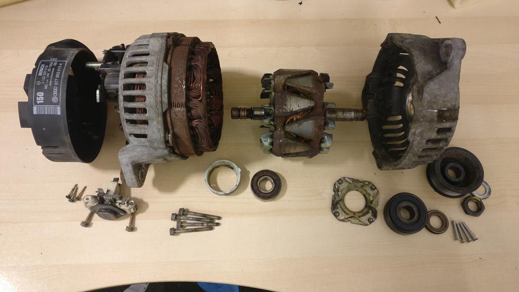

Not much progress today as I'm waiting on parts. Got the oil cooler back on and the timing gear off.
The rest of the time was spent dismantling the alternator to replace the bearings as they are very noisy, but I didn't get any photos. More tomorrow.

The alternator dismantled and awaiting bearings:
They are just standard bearings which hopefully will arrive on Tuesday.

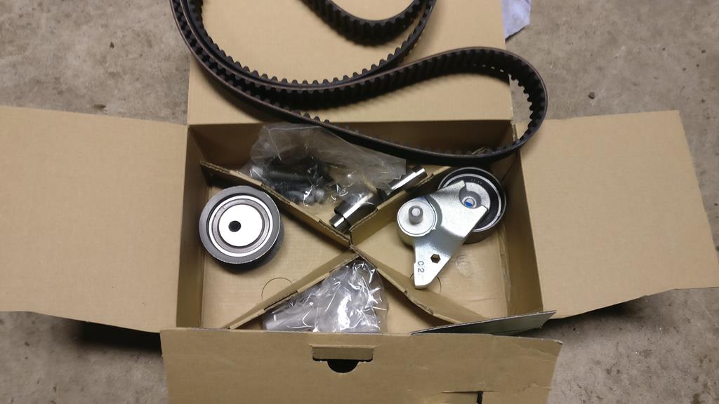

This is the INA belt kit that I use. Part number 530 0452 10, usually around £240.

Old 14th January 2020, 09:23 AM
That's a good price for the INA kit. The parts when ordered separately are (as many will know) in the order of £600.
