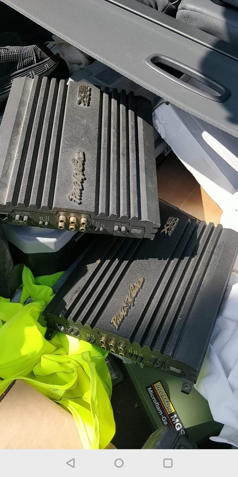

Oooops, someone has been shopping for period aftermarket amps for the D2

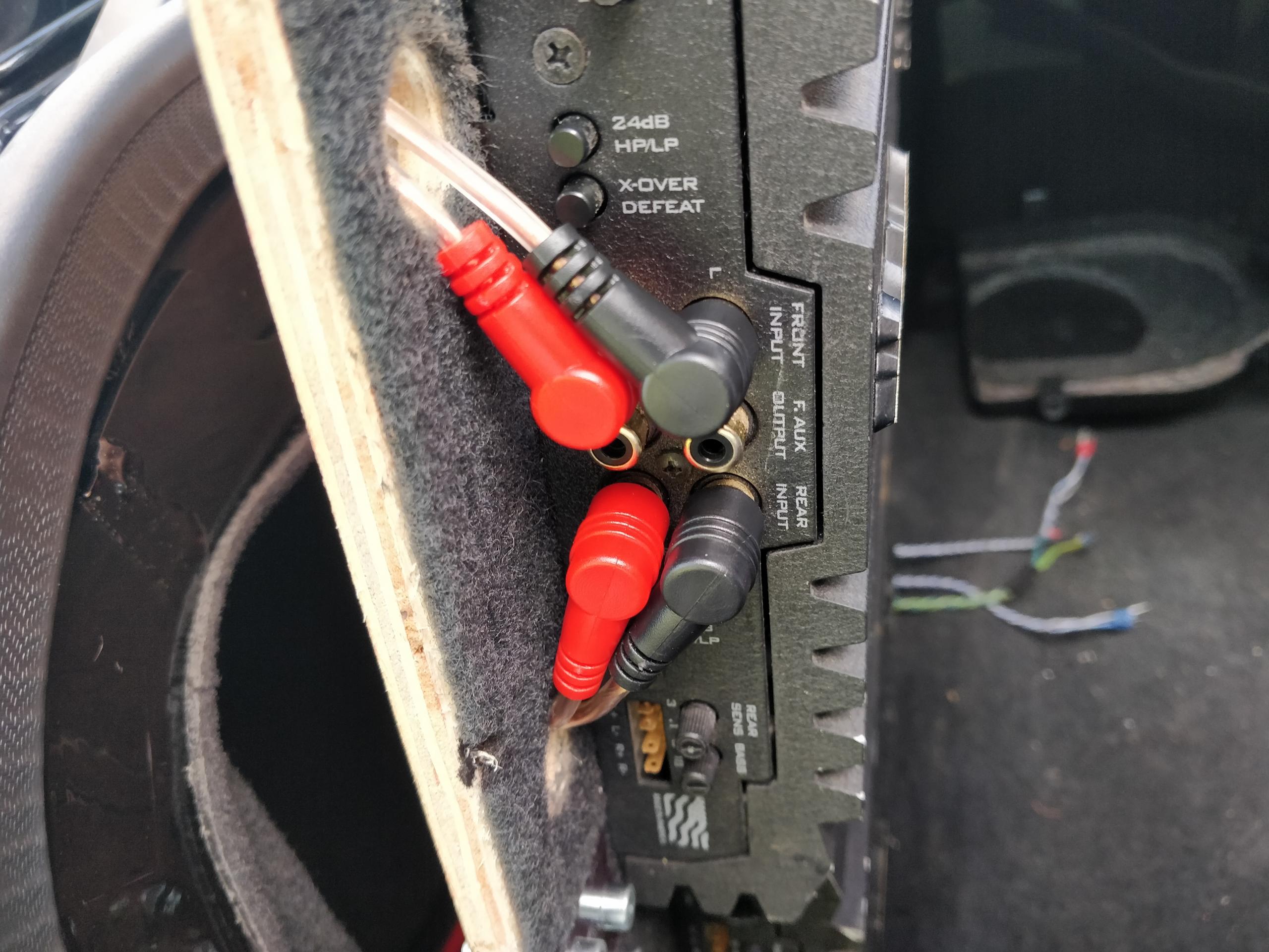

I don't think I'll be swapping the speakers. ATM I'm trying to fit those 2 amps into the original location in the left side of the boot. The original bose amp is a DSP amp which is not really my cup of tea after a few weeks of listening to it.
It's a little tricky but should just about fit. I'll be wrapping the plywood in the same material as rest of the boot and keeping the original door so it will all look as much oem as possible. It will probably take a few attemps to get the measurements right too

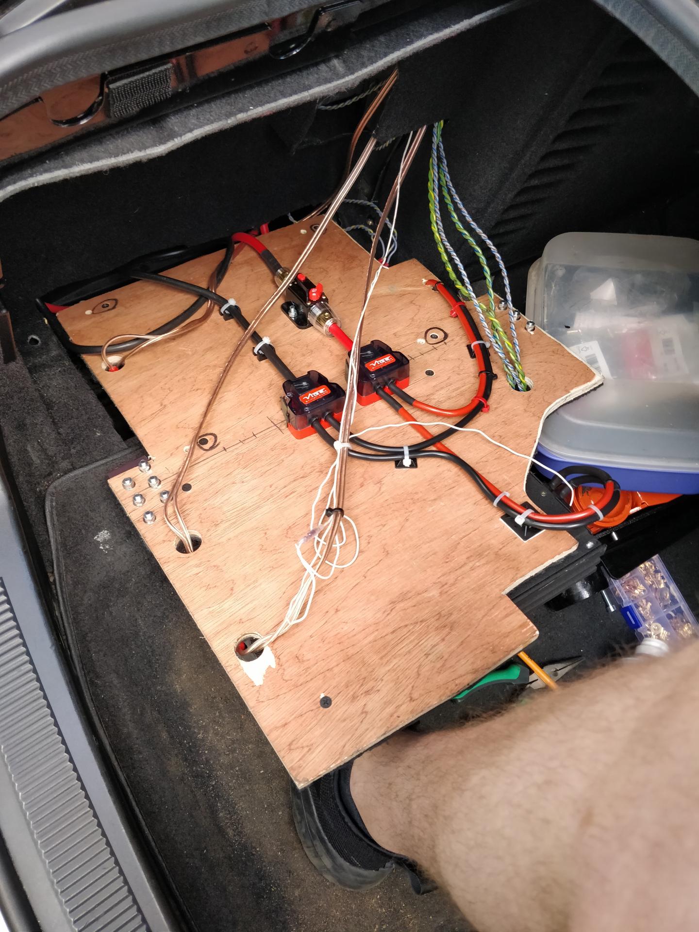

If anyone still cares, some progress has been made. I just have to trace all the phono cables to head unit now which is a PITA to do it properly and remove all the old tv tuner/gps/cd changer loom. It still all looks messy on the back as its a prototpe/wip kind of a thing and I had to do unspeakable things to the left hand side boot liner (have a spare from forum sponsors)
If any of you attempts something similar in the future, you can use the front boot liner that covers rear seats as material to cover any sort of backing boards like mine as its flat and not held with adhesive, it will match the rest of the boot liner perfectly. Mine was only 9.99 from prestige.

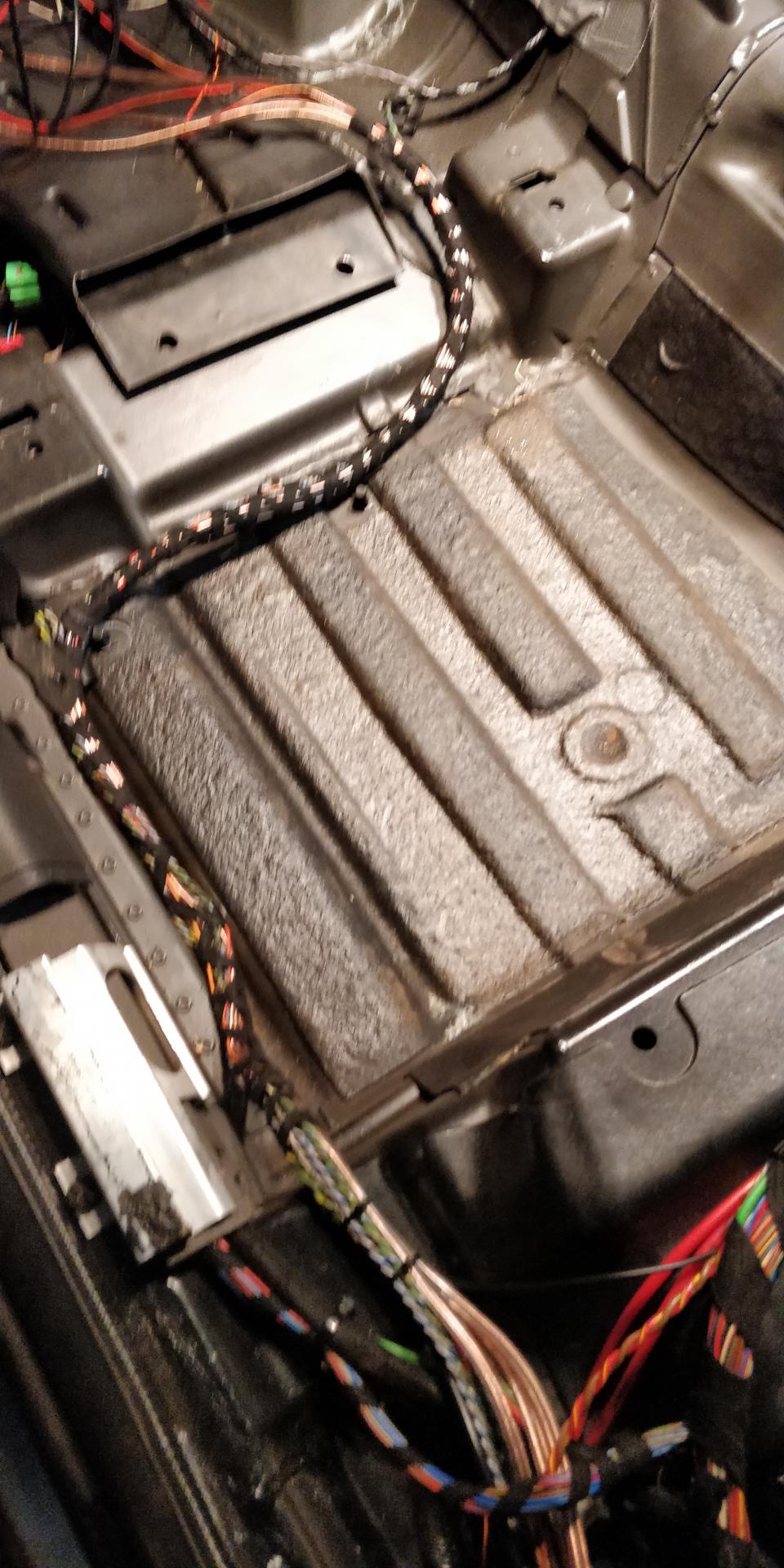

New audio cables ran and sound deadning added because why not

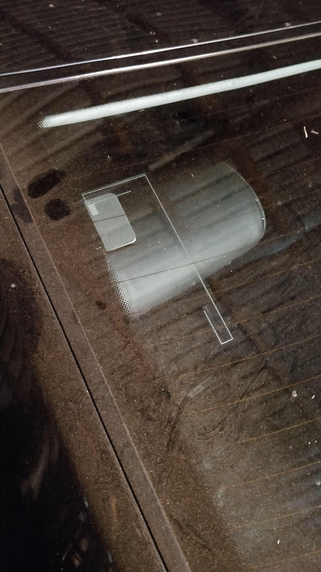

DAB antenna installed along with DAB radio app on the Android HU
