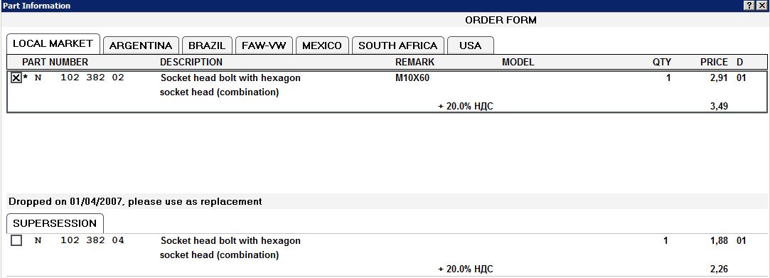

What's special about S8 version? Are we talking about no 11 in diagram? It's been superceded with N10238204 and available on ebay as lot of 5 https://www.ebay.co.uk/itm/Genuine-A...kAAOSwN6ldgWNo

That looks like the bolt for the auto. From memory the equivalent on the manual does not have a socket-head but the slightly odd flat head which locks in to the casting of the bellhousing, and is secured by a nut on the engine side. I'm not convinced that supersession is correct.
The only time I've seen this is on Vera's though, which was a few years ago so my memory may be faulty. I will check a manual gearbox tomorrow

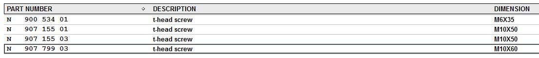

The ebay listing shows a lot of different models. Etka shows Allen head bolt for FL A/S8, multipoint for PF. A6 comes up with the same as 8, A4Q is the t-bolt as in ebay listing. No idea why the difference. Cannot get full model list where they are used, for some reason my Etka is not finding any N numbers in search/ATP
8 and 6 are 60mm, A4 is 50mm but there is the same style available in 60mm as well, don't know what model uses that.
Do 'N 01234567' with two spaces
