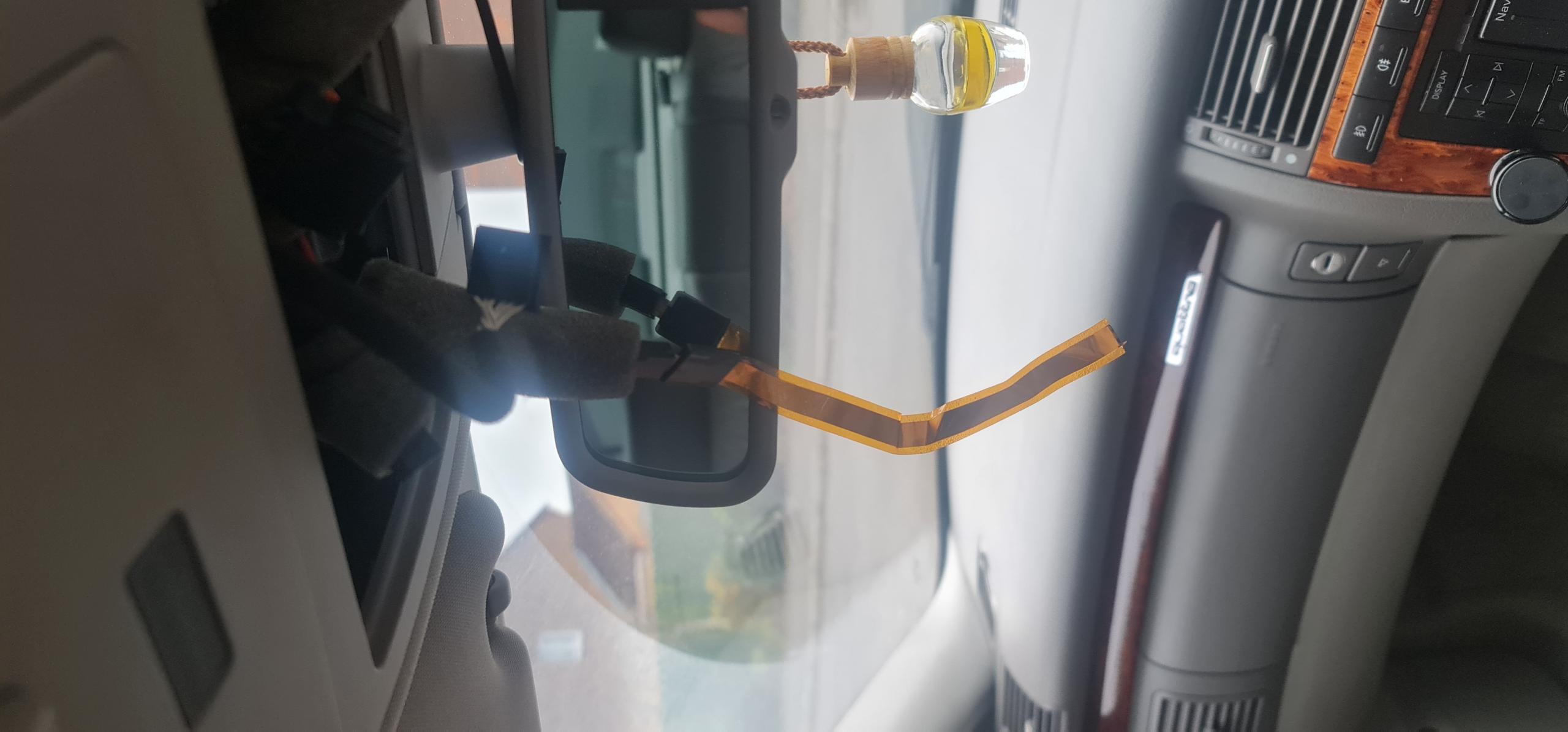

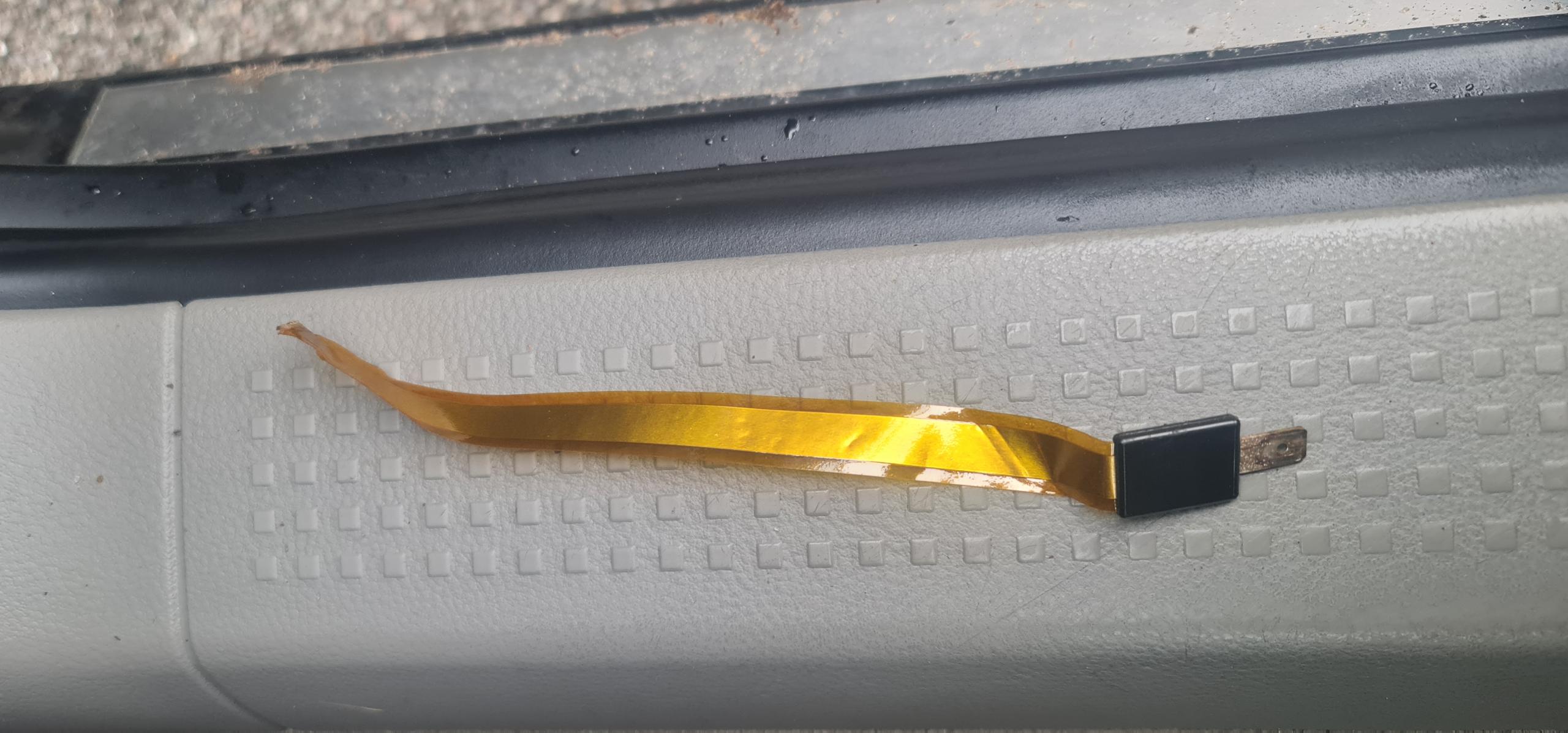

I do hate people sometimes
So I have figured out why heated screen doesn't work....
How does one go about fixing this?

You don't I suspect you have a standard screen in there now as the heated one is no longer available. Those connectors were likely cut off when the screen was replaced.

To me they seem to have been ripped off (or at least that's what I'm hoping for) 0

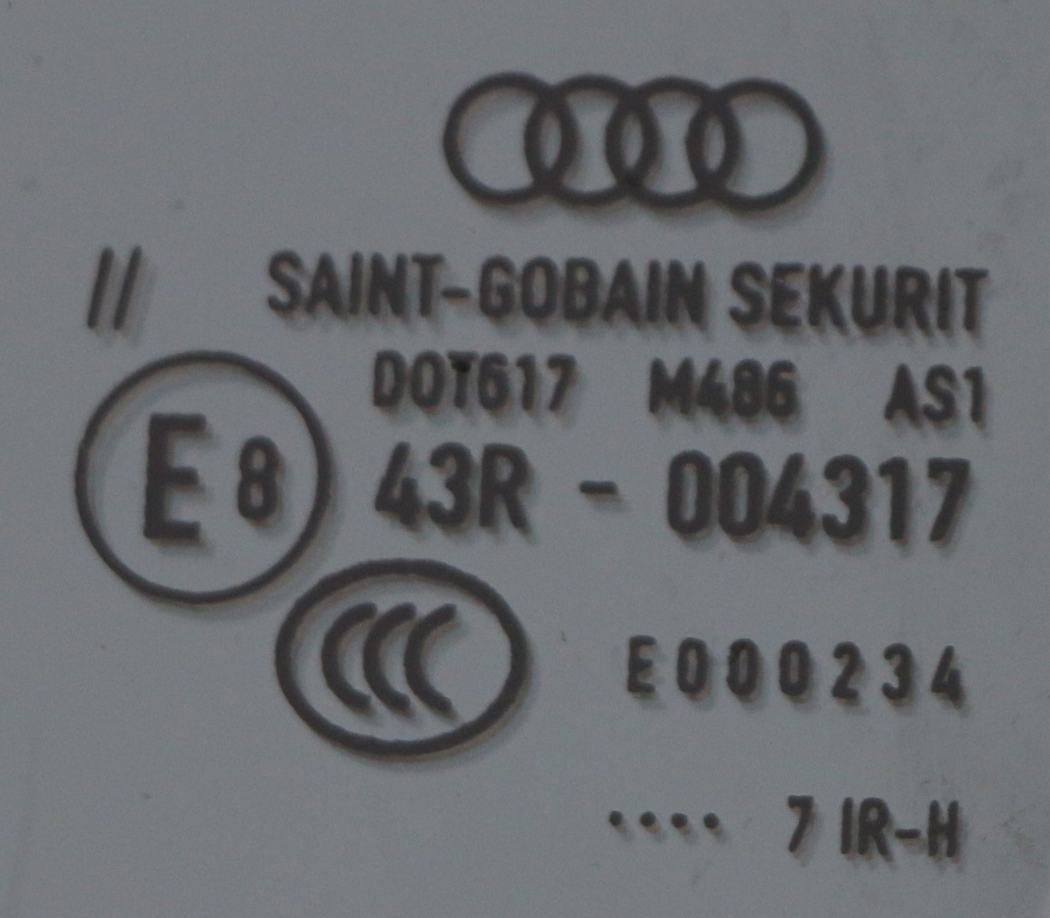

Not sure if it's helpful, but the attached image shows the information on mine. No part number unfortunately.
I suspect the only way to be absolutely sure would probably mean removing the headlining to see where they originally connected to... if it's still the original screen.
