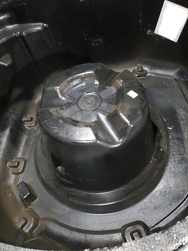

I took a look at my spare tire well and noticed there is a large dome under the spare tire so there is no way to flip the spare tire over and use the spare tire subwoofer setup. This is probably a stupid question but is it possible to cut out that spare tire dome?

Yes really. Just a reminder that I live in America, so this must be for only D2 cars here in the States? I think it's stupid having this dome in there! I knocked on it and it sounds like it's plastic so it's possible it could be cut out?
Here is what it looks like in my car.

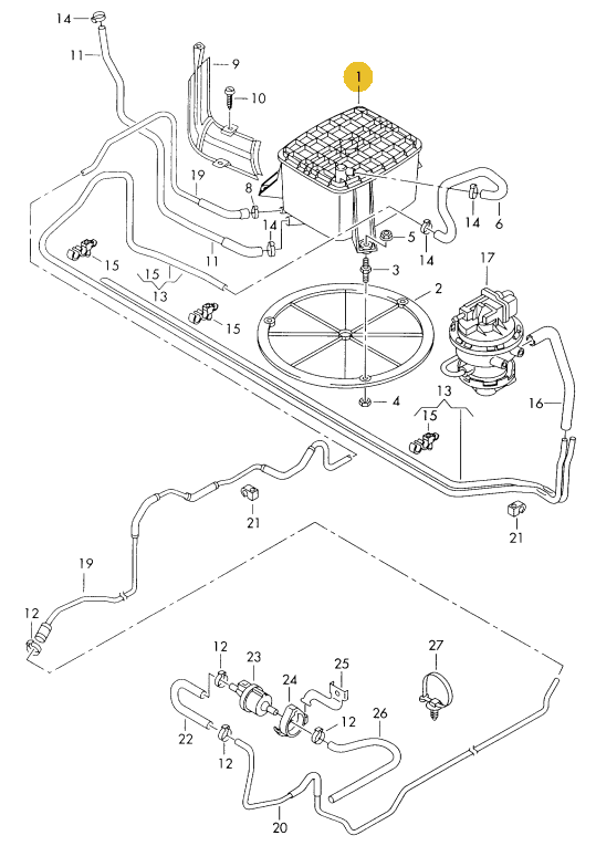

IIRC American models have a load of extra fuel system evap gear in there. B5 and C5 are the same. Best to have a look underneath and see if there is actually anything in there before cutting it out

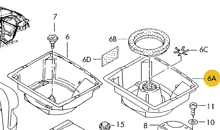

Needless to say, MJ is 100% correct. The bulge hides an activated charcoal container that we don't get in Europe. Images of the two spare wheels available (US on the right) and also the activated charcoal setup.
Thanks for the info. Well that totally sucks!
