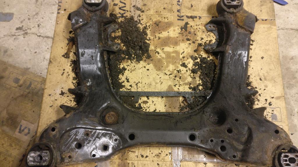

Started scraping the detritus off the subframe - it was half an inch deep in places! Didn't have much time tonight so I'll get some elbow grease on this tomorrow.

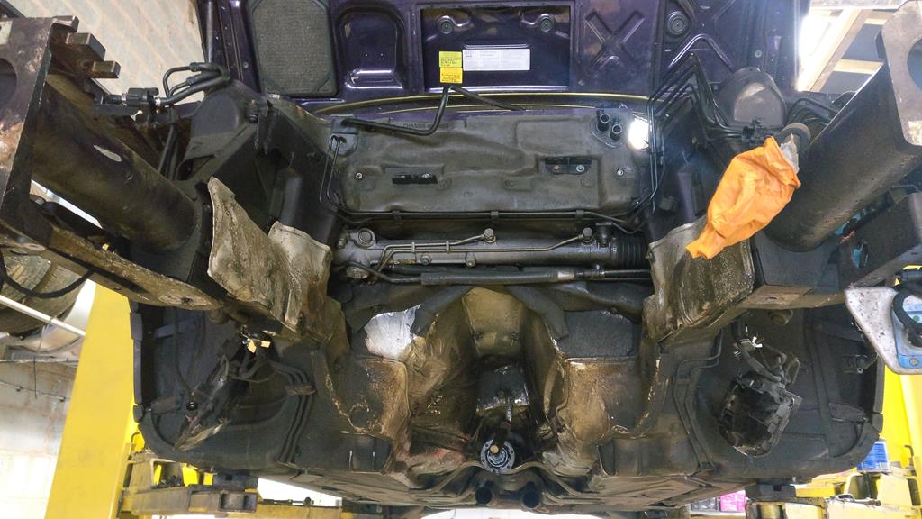

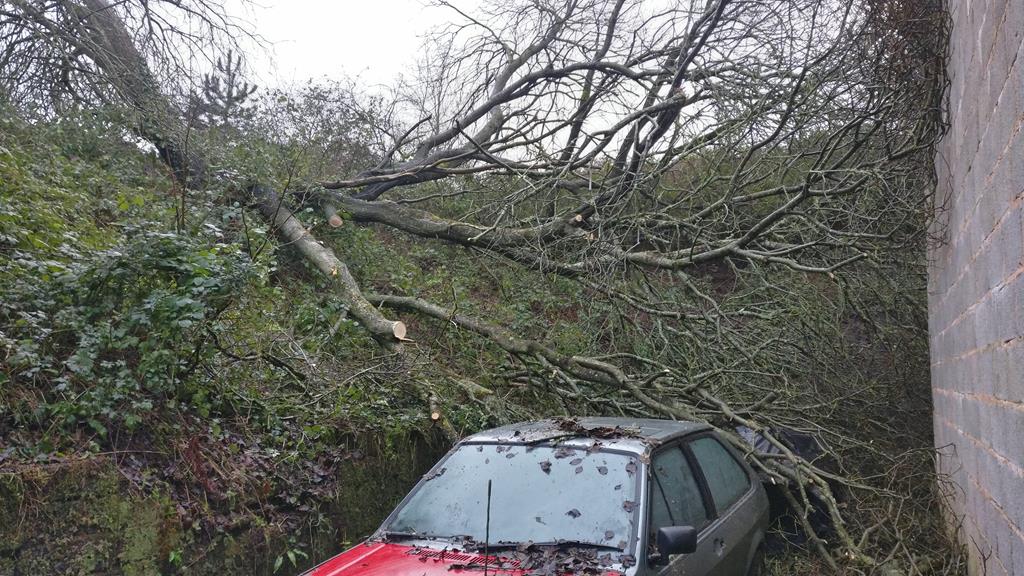

Progress was slowed a tad this week when this monster tree feel down and killed my speedboat Luckily the Polo V8 survived relatively unscathed - a few dents and scratches in the completely ruined paint, but the glass was untouched. When we started, you couldn't even see the Polo! It took 2 days to clear this back as far as the retaining wall.

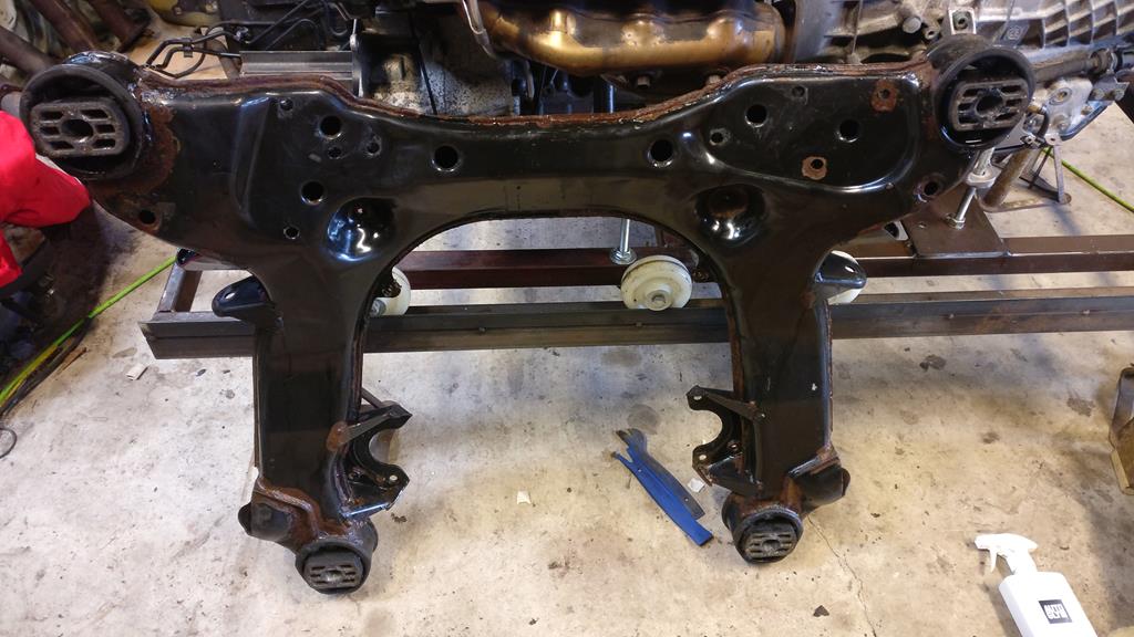

I cleaned the subframe with Elbow Grease and the pressure washer. Its in great condition, barring the dents and bruises underneath where someone has used it as a jacking point. No holes though. I might paint the rusty bits.
On to the engine bay. What new horrors am I going to find in here...?

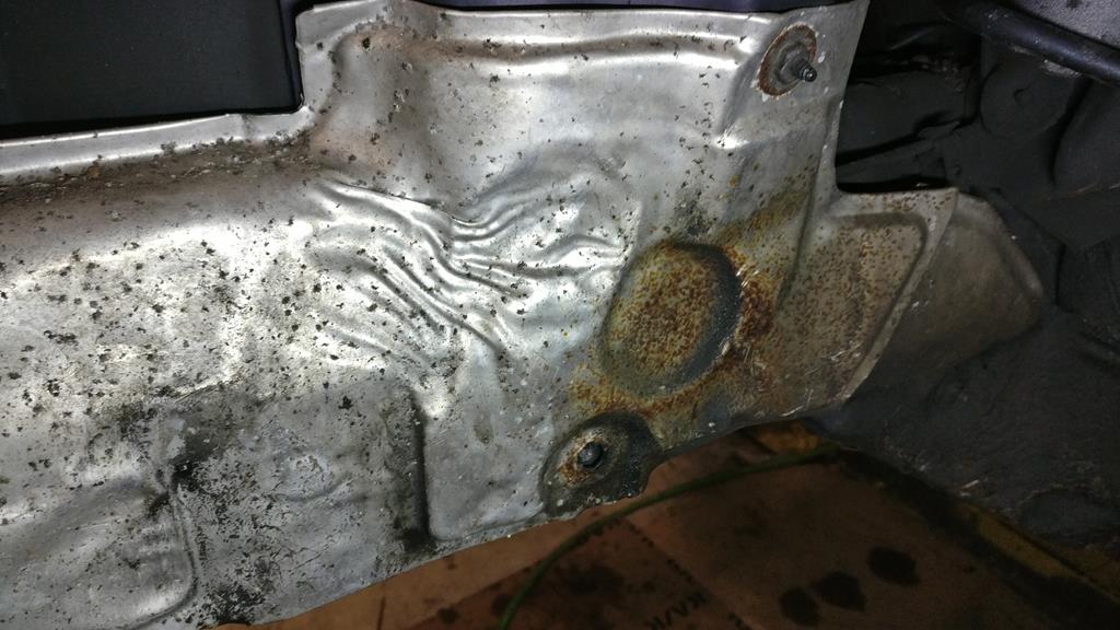

Fairly nasty heat shields. Not sure how an aluminium part appears to be rusty
Many studs snapped off. Replacement stud-rivet things are actually available for these (which I didn't know when I did my grey S8), but the damn things are £12 each!! There are 5 snapped off
The bay is pretty nasty

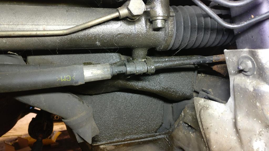

The rack is covered in oil, but this is engine oil from the cam covers

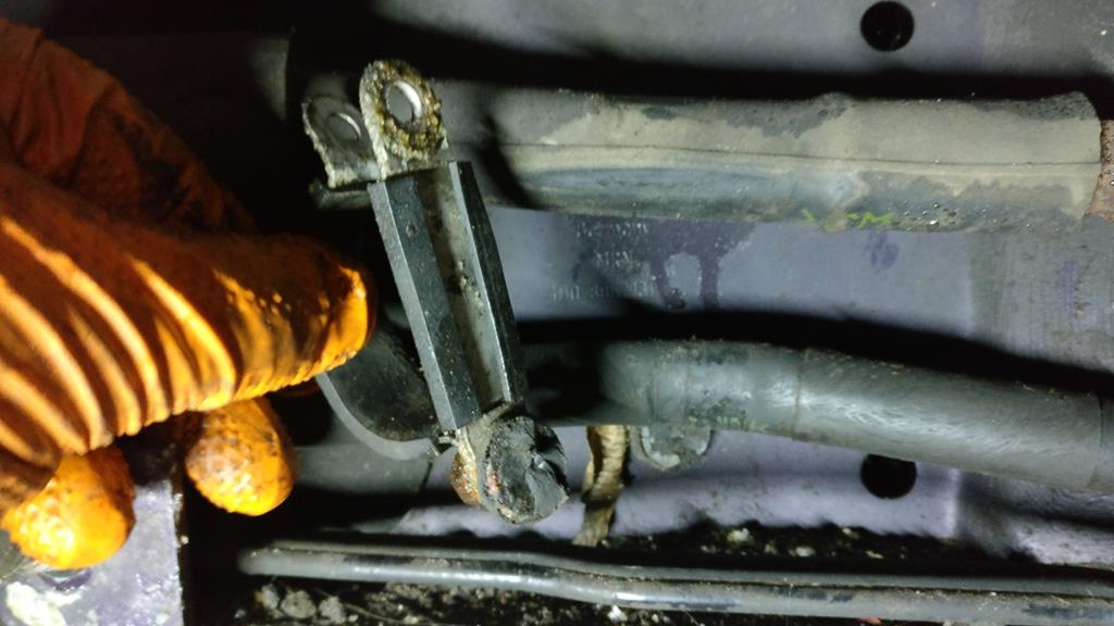

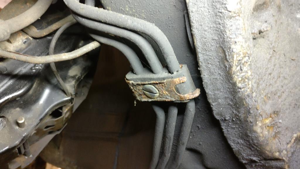

The fuel pipe clips are rusted through. There should be a set of these coming on back-order, hopefully.

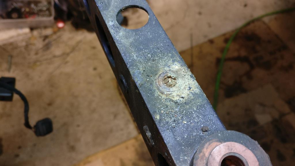

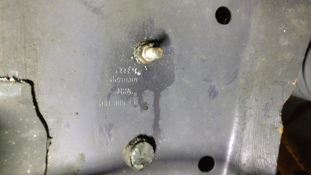

Still got a bunch of snapped rivnuts to deal with

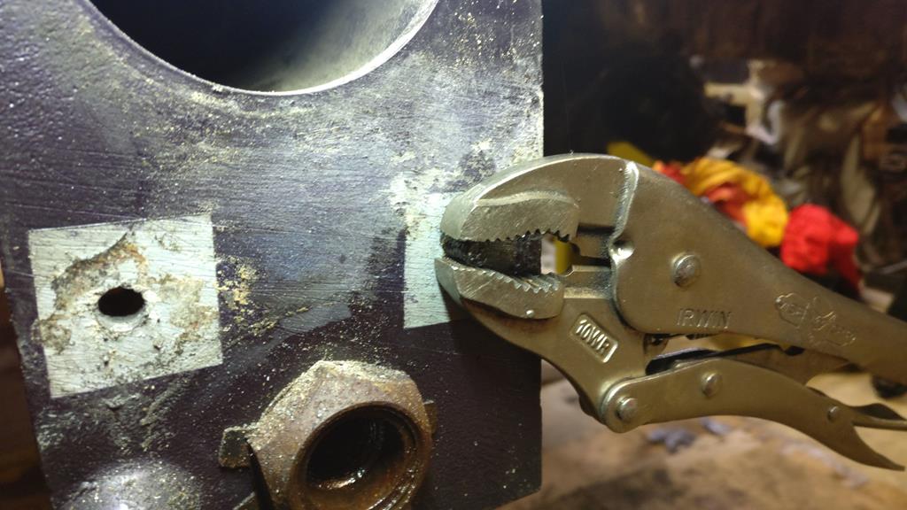

With heat, WD40 and vise grips, the broken front panel bolt eventually came free

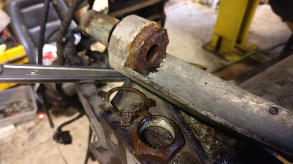

This is why I suspect the PS pipes may have been replaced - the bracket is broken and bodged
The top rubber mount has been replaced by a nut and bolt, and the bottom one is torn off. This is going to be a right pain to remove as there's nothing to grip.
Taking the heat shields off, I'm cutting the nuts to save the studs, since the nuts are only 67p and the studs are £12.

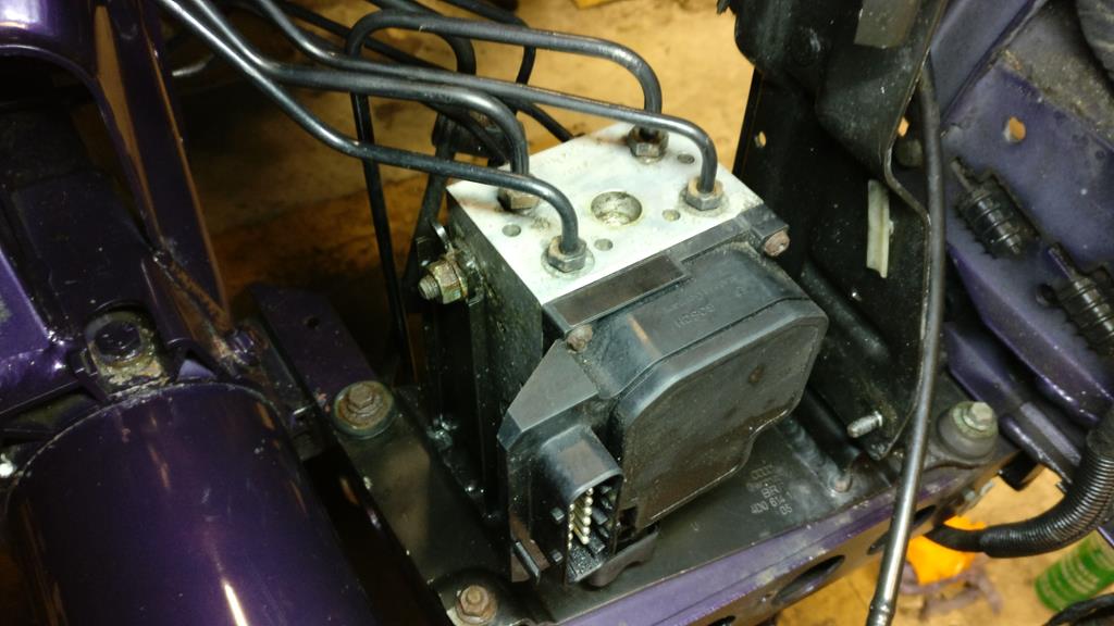

Had to remove the electronics box to get the AC pipes out as all the unions are seized
The whole lot came out in one go. I'll separate these in the vice where I can use heat and more force. The aim is to save the pipes at the expense of the consumable parts - condenser, evaporator etc.

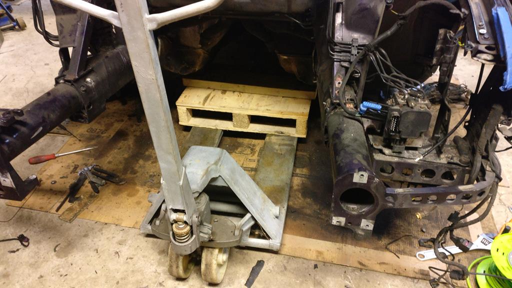

I forgot to disconnect the steering column before I put the car on the lift, so I lowered it on to the pallet truck and pulled it forward so I could open the door. With the column disconnected I could remove the steering rack.

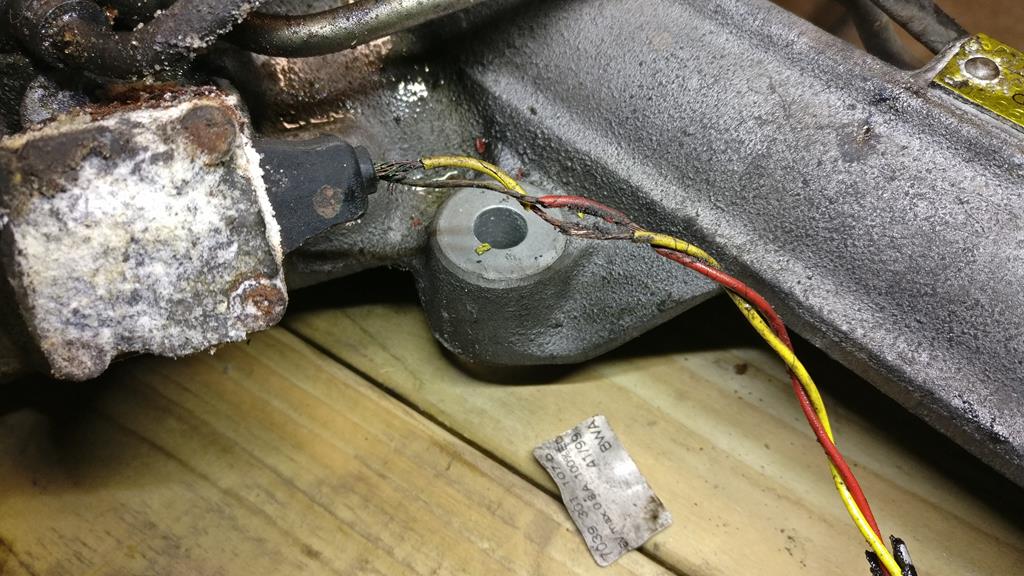

Well, there's the problem with the servotronic. The insulation on the wires is brittle and disintegrates on contact

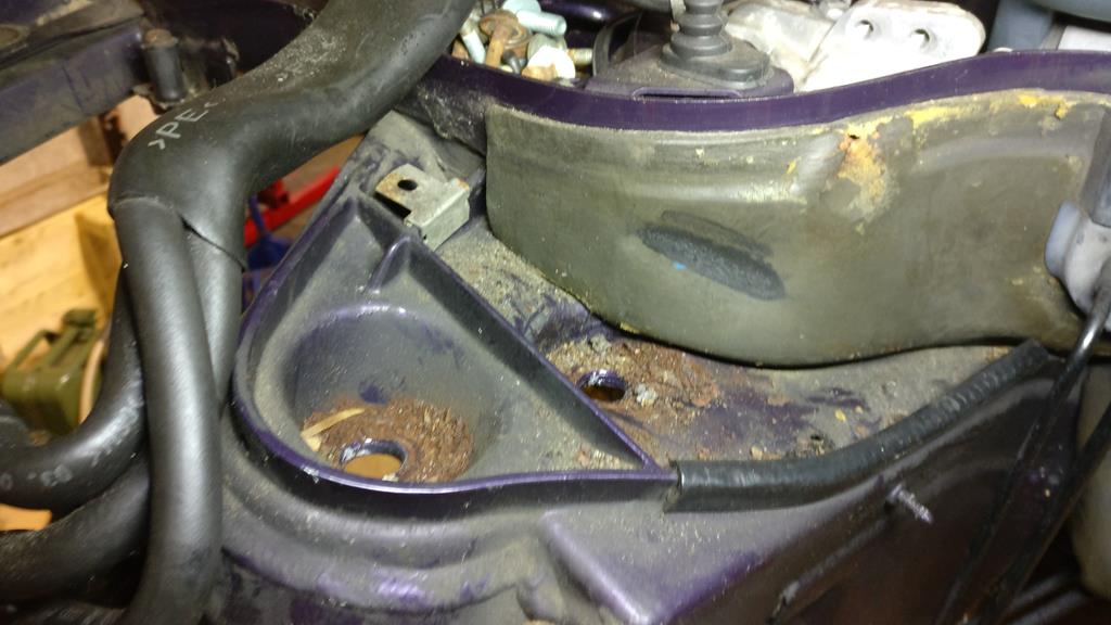

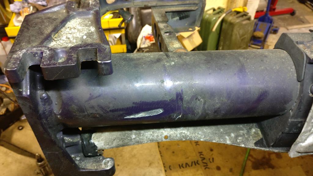

Hard to get a picture, but there is a dent in the right hand chassis leg which I suspect was from changing the oil pressure switch.

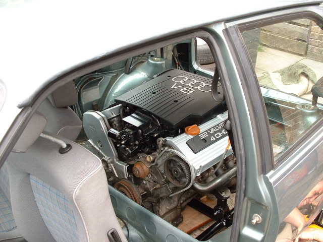

I thought I had mentioned it previously, but possibly not. Its a mk2 Polo Coupe, with a 3.6 32V V8 fitted where the back seat was, on an Audi Coupe gearbox. It was built by a friend back in 2003, but he couldn't work out a flywheel and clutch solution so sold it on. It then went through a couple more owners and ended up in a field in Oxfordshire being consumed by brambles. I found it mentioned on a forum a few years ago and did a deal to buy it. It has had most of its original Polo parts pillaged for other projects over the years but the custom subframe and V8 engine are still there. It was built before SVA rules, so it actually has the proper engine number and capacity on the V5
