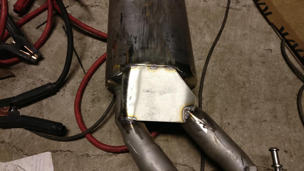

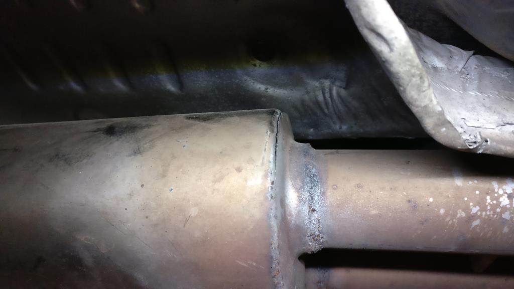

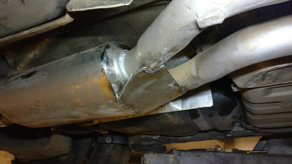

Once the suspension was back together I put the exhaust back on so I could get it back in to shape before welding. I cut the two backboxes off and reattached them with sleeve clamps so the system is more manageable. Funnily enough, a brake block is the exact right size needed to space the two pipes apart
With the pipes spaced properly the crack closed up again so it could be welded
There was a crack on the front as well where it appears to have encountered something solid like a speed bump or manhole cover?
To stop this happening in the future I made up a skid plate from 2mm stainless sheet which was welded in place

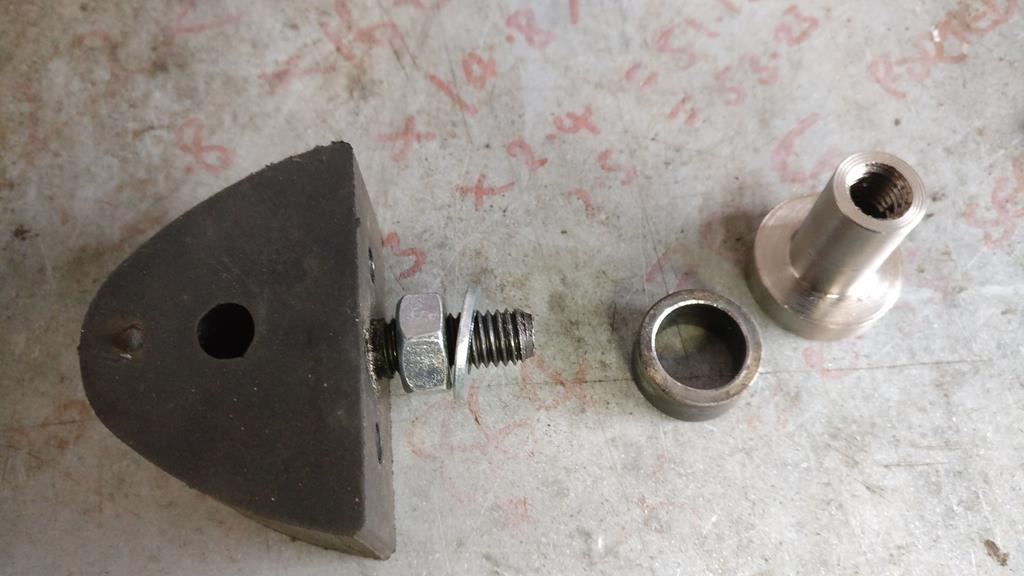

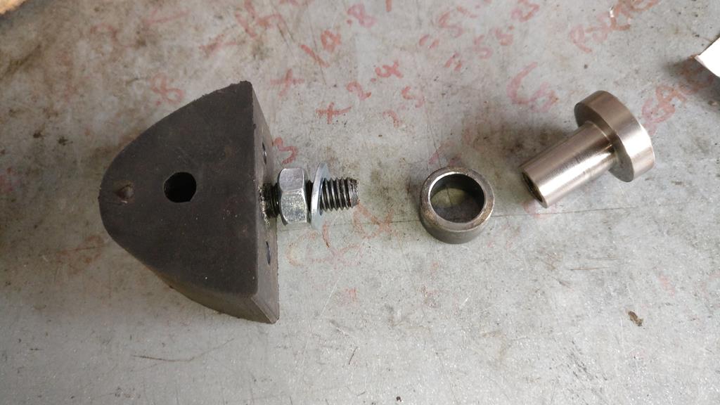

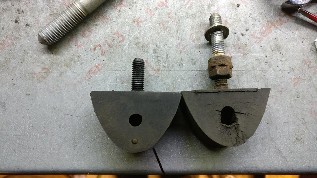

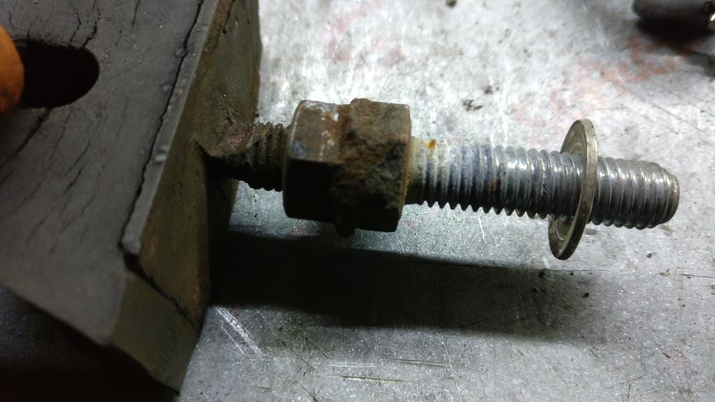

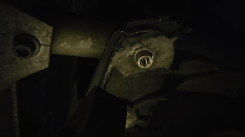

The rear right exhaust hanger was a rather odd contrivance - it appears to be a bolt welded on to the stud on the hanger. The rubber was perished and split so I sourced a new one but decided to come up with a better way of attaching it.
I made a threaded top-hat from bright steel bar, and modified a seatbelt bolt spacer to fit over it. This drops through the hole in the body (which was 10mm from the factory but had been opened up to 12mm by whoever fitted the exhaust), then the spacer slides on, then the exhaust mount threads in to it. The height is adjusted as needed and the nut is locked up which sandwiches the top hat and spacer in to the chassis leg.
This is the top hat sitting in the chassis leg. I couldn't get a good pic once the exhaust was in place because there's an exhaust in the way!

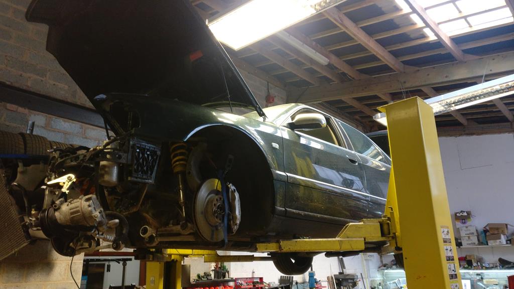

Back on the Green Beast Its been at Mike's for a month or so as it really needs the oil leaks sorting before being put back in to service, so there was no point in it going home then coming straight back.

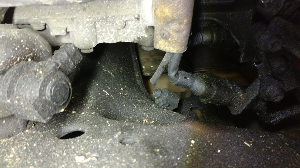

One unpleasant surprise when the front panel came off - it appears to have suffered an impact on the lower right corner which has also damaged the radiator We were assuming that the escaping coolant was the oil cooler pipe, but alas also the radiator too. I'll get a replacement front panel from Prestige, and a new radiator.

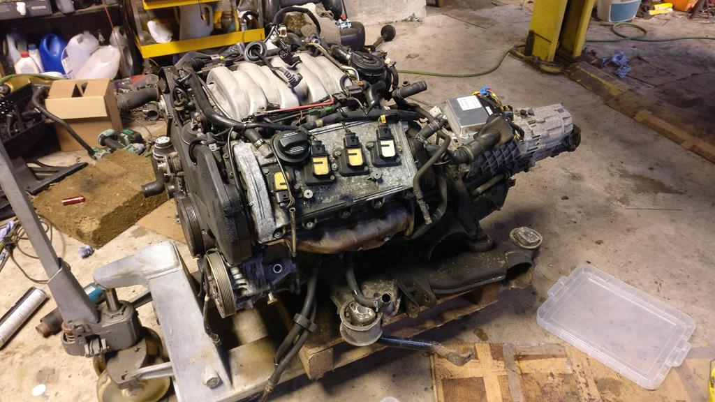

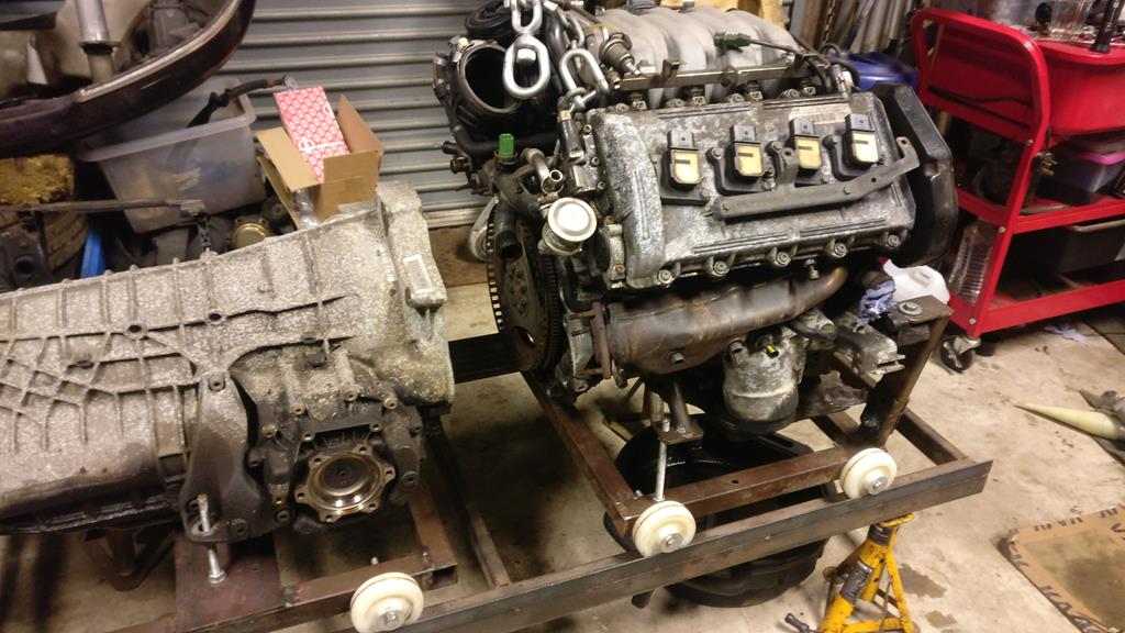

Engine out

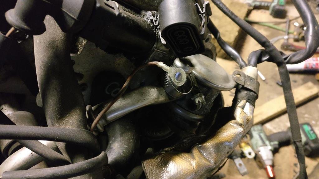

Its been out before, as there are a few tell-tales like wire routing and cable ties in odd places. The sensor ground wire was just chilling out behind the cylinder head!
and the left engine mount wasn't connected. The ECU didn't seem to mind about either

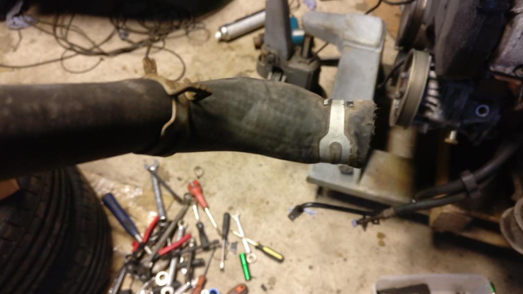

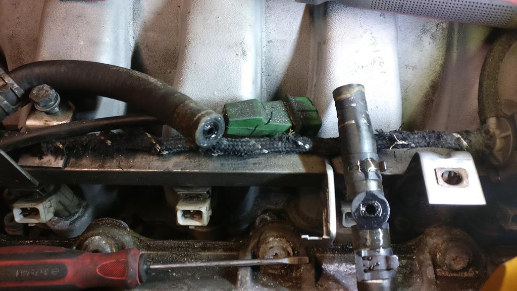

A three-fer here. The knock sensor plugs are toast, as usual. The vacuum pipes are all shredded, as usual. Not as usual though, the header tank t-piece snapped as soon as I touched it. Tbh I'm always pleasantly surprised when these don't snap, so I will replace this with a metal piece.
One of the heater hoses is badly distended. This wouldn't have lasted much longer so hopefully I'll have one in the box of pipes. These are NLA now though.

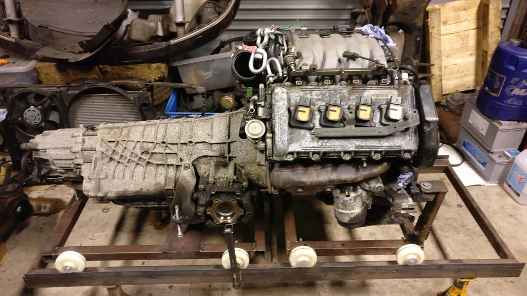

Engine and box on the separating table.
I'll split these tomorrow and start cleaning them up. Apart from the radiator, this one is pretty much all the usual suspects

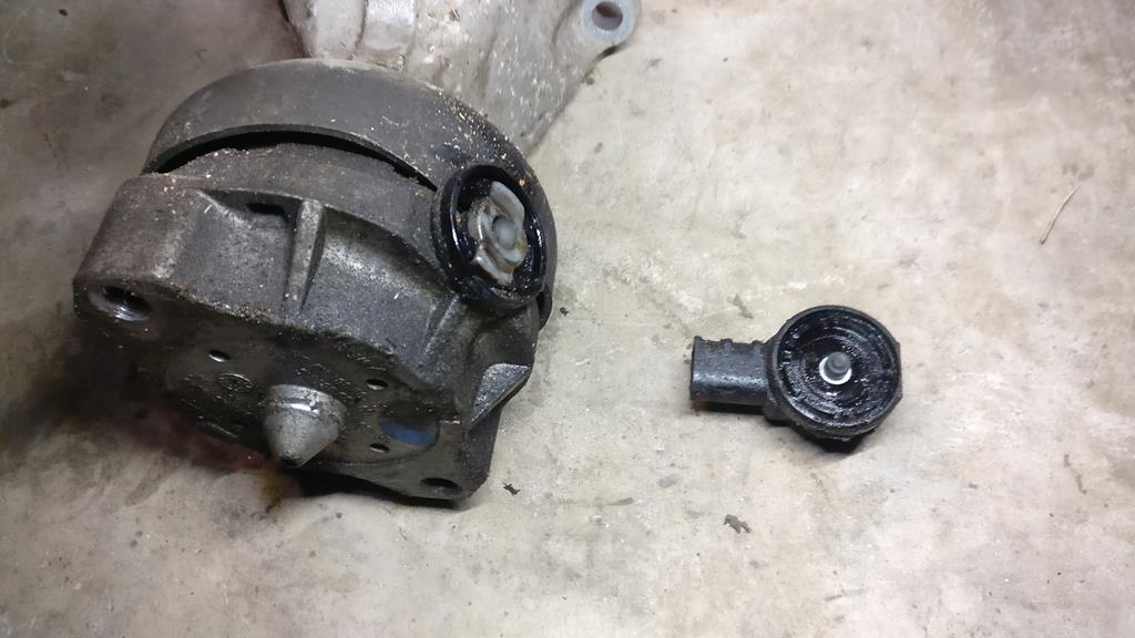

Hmm. I wonder if this is why the left engine mount was disconnected? It fell apart when I touched it.
Got the engine and box split, but thats it tonight. I was going to mount the gearbox on the stand, but realised I had repurposed the M12 hardware I normally use for this on something else recently and had forgotten to replace it
I'll get some more hardware tomorrow and carry on.
