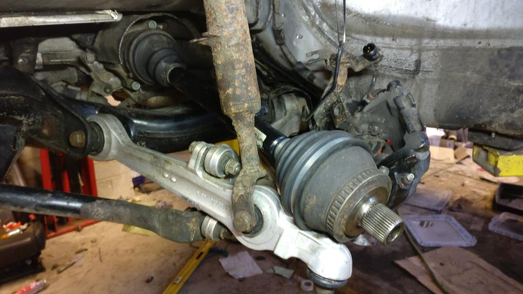

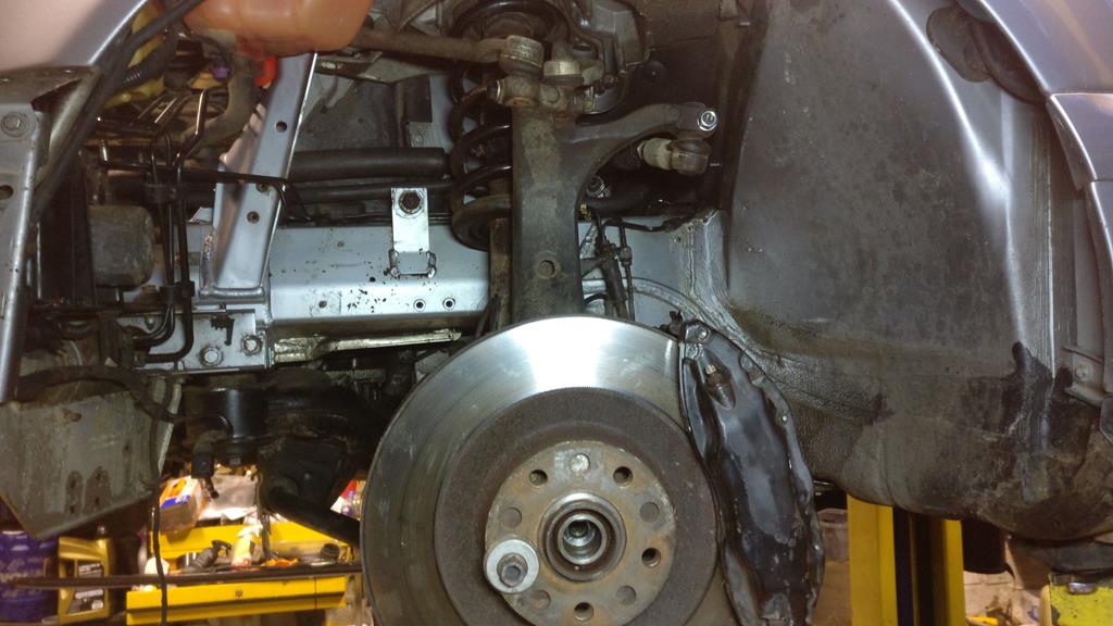

Replaced the CV boot and put the suspension back together:
I'm now stuck on the headlight level sensor as the 20" cars have a different arm to the others, the car doesn't have one, they are NLA, and I don't have any left. This means its probably time to print a new bracket for use with the balljointed arms I've been making...

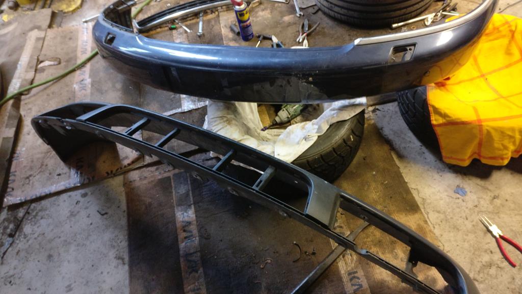

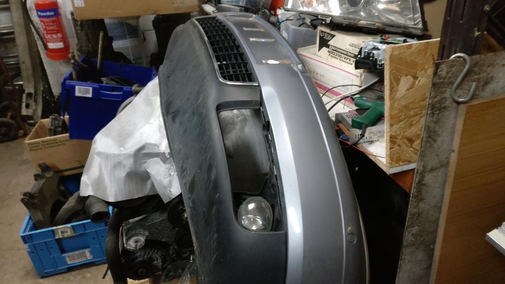

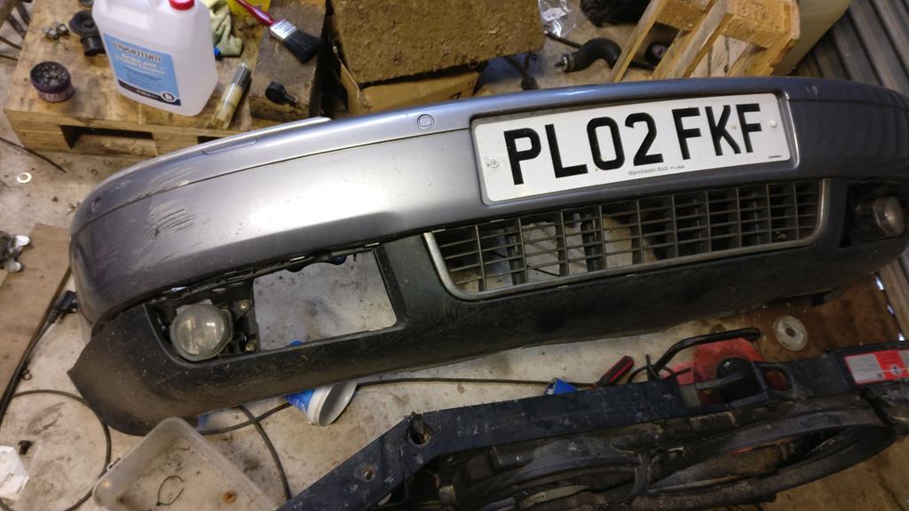

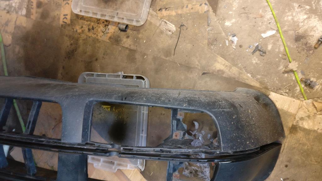

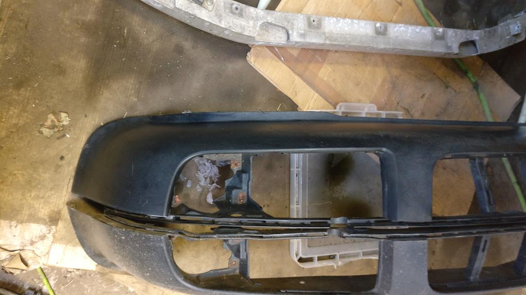

Started on the bumper:
Duff bumper number one (barnfind). The top is badly scratched, the bottom is ruined.
Duff bumper number two (my dead FE). The top is pretty good, the bottom is ruined.
Duff bumper number three (donated by Neil for parts). The top has been drilled for aftermarket parking sensors so is scrap. The bottom is intact and usable though.

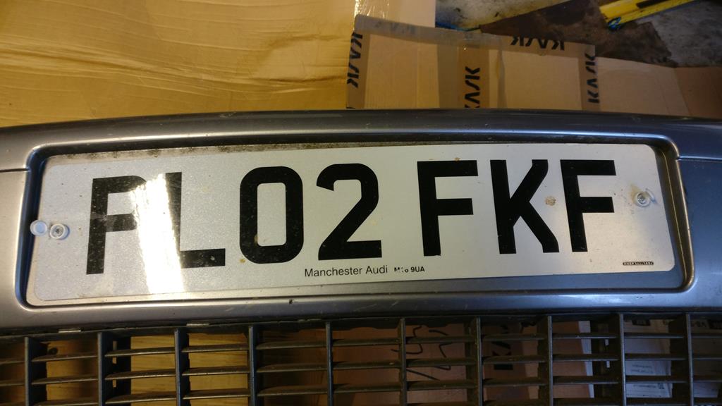

I was hoping I could at least use the number plate from the original bumper, but whoever fitted it didn't drill the holes straight so this will get replaced as well. All I could save from the original bumper was one foglight and three parking sensors in avus
At this point my back decided I'm too old and fat to be playing with bumpers on the floor so I had to stop

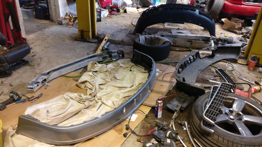

For a long time I have wondered what the difference is between A8 and S8 FL2 lower valances to justify the 50% price increase for the S8 part.
A8:
S8:
The lower lip is removed on the S8, presumably to allow airflow to the brake ducts. It certainly appears, from close examination, that they came out of the same mould and the lip was cut off by hand at the factory! The extra £100 for the S8 part in that case is to pay someone to cut bits off it

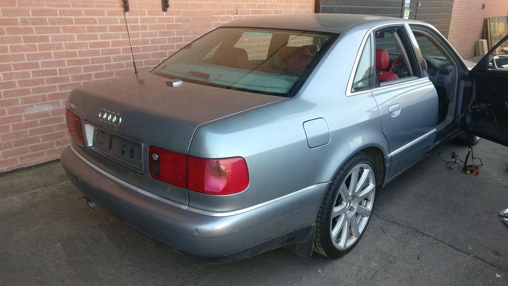

Saturday - Mike helped me swap the bootlid from my dead FE. The paint on this is in better condition and it has the proper GPS antenna
The nasty shark-fin monstrosity from the old bootlid wasn't even a GPS antenna - it was an analogue radio antenna! What the point of that was I have no idea.
The car now has proper FE wheels back on it and is looking much more respectable

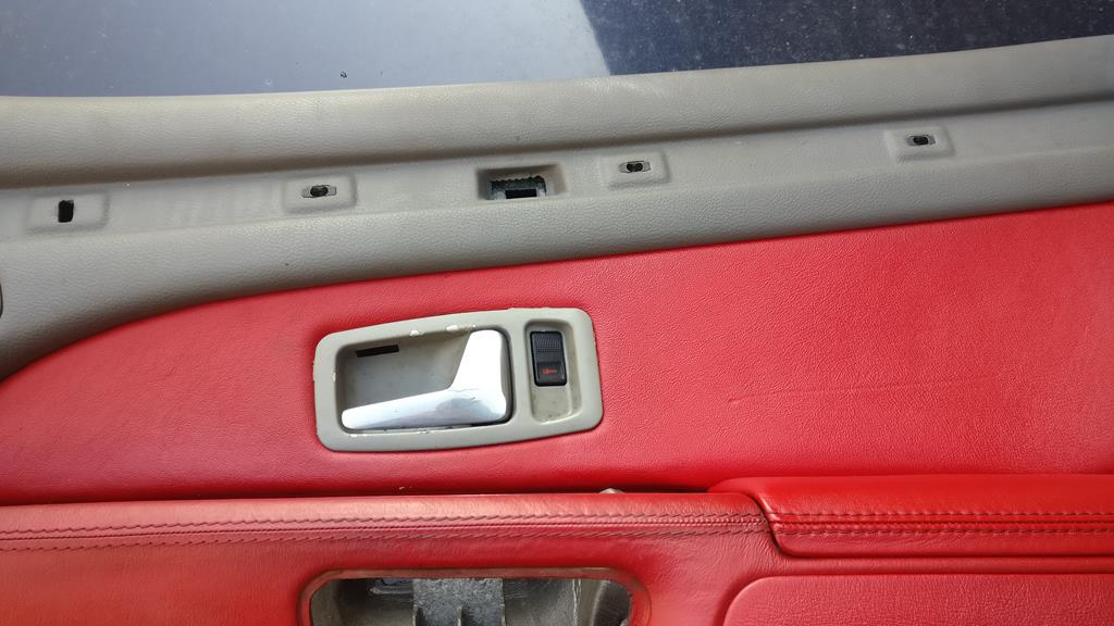

I also removed the driver's door card to replace the window motor. Someone had already had a go at this and failed, breaking the internal mouldings in the process so I'll show the repair of that when I get to it. I made a start on cleaning the leather which is going well. Left is as it came, right is cleaned up.
