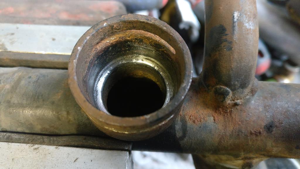

The coolant pipe o-rings were also pretty crusty
Replacement link hose and powdercoated coolant pipe

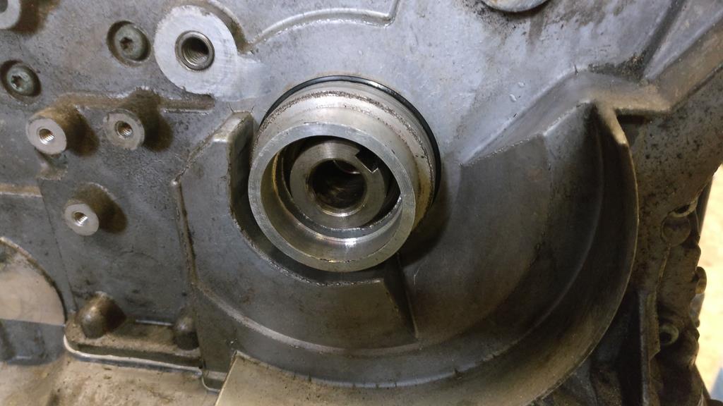

Crank oil seal - this was dried up and leaking
New seal fitted to the bushing
and pushed in place with the purpose-made tool. The manual says to push the seal in place and then fit the bushing, but that is extremely difficult to do without folding over the lip of the seal, hence why I fit the bushing to the seal off the engine so I can make sure its all ok, before fitting both bits together.

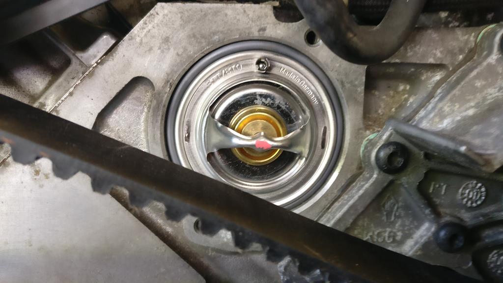

New thermostat in place

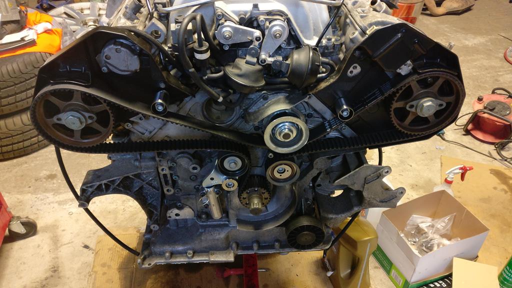

The cover went on without fully removing the belt
Tensioned the belt and finished everything off
Spec here is 5mm +/- 1mm.
