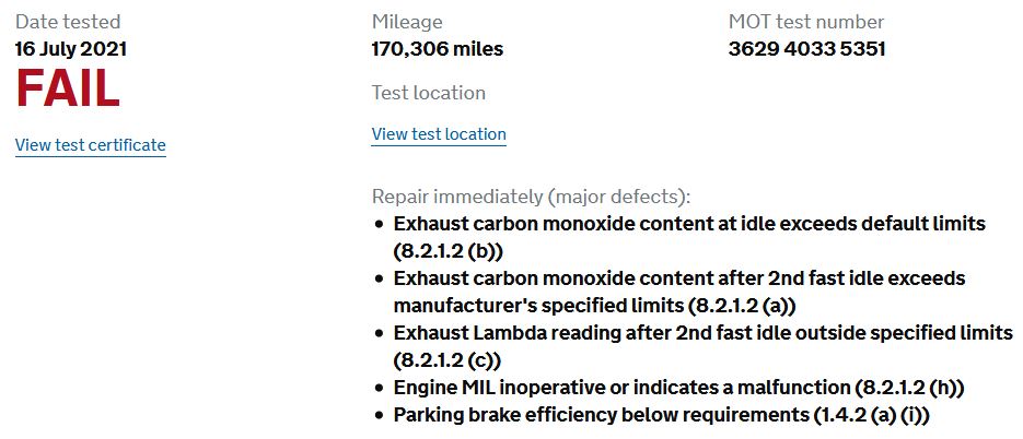

Remember how I said there were no error codes or warning lights?
The bank 1 primary O2 sensor failed on the way to the MoT

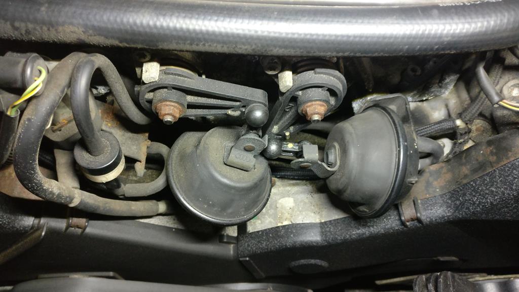

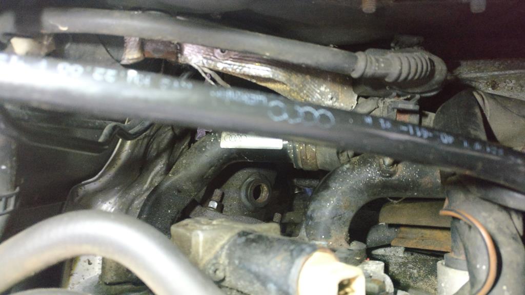

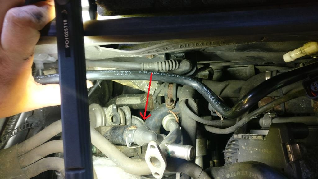

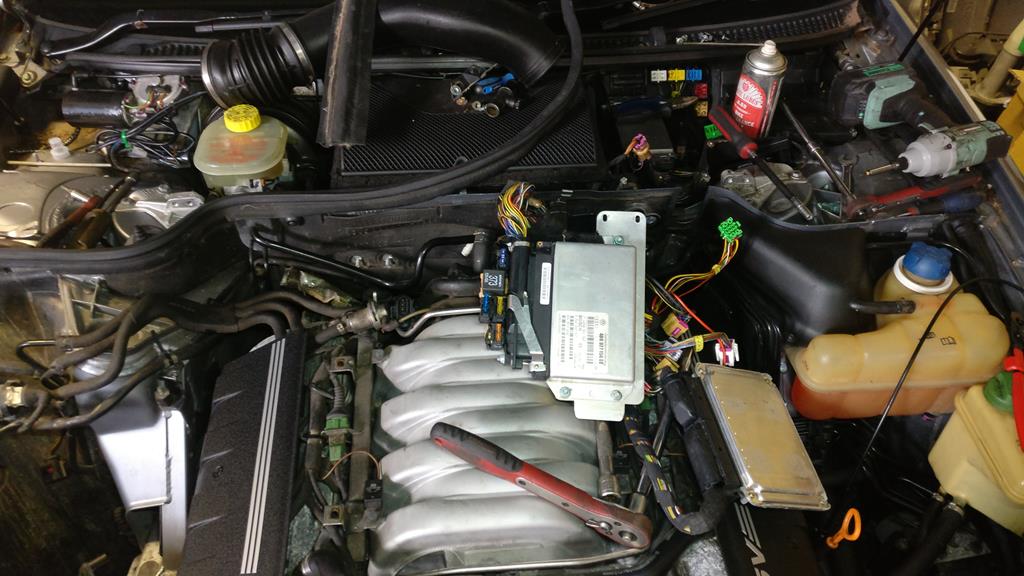

So, today was swapping both sensors. You can see the bank 1 sensor here:

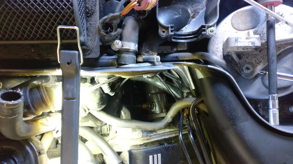

In fact no, you can't because the damn SAI valves in the way. Well, they aren't working anyway because the vacuum hoses are all perished, and you can be very sure that if I have to take them off for any reason they aren't going back on!

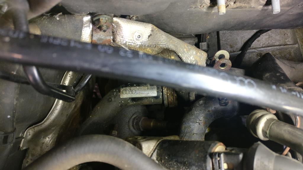

With the valve removed, you can now see the sensor
Bank 2 sensor - this was still working, but at 170k its pointless changing just one of them, and that may result in the two banks running unbalanced anyway which we don't want.
The amount of stuff which needs to be removed to get to the sensors:

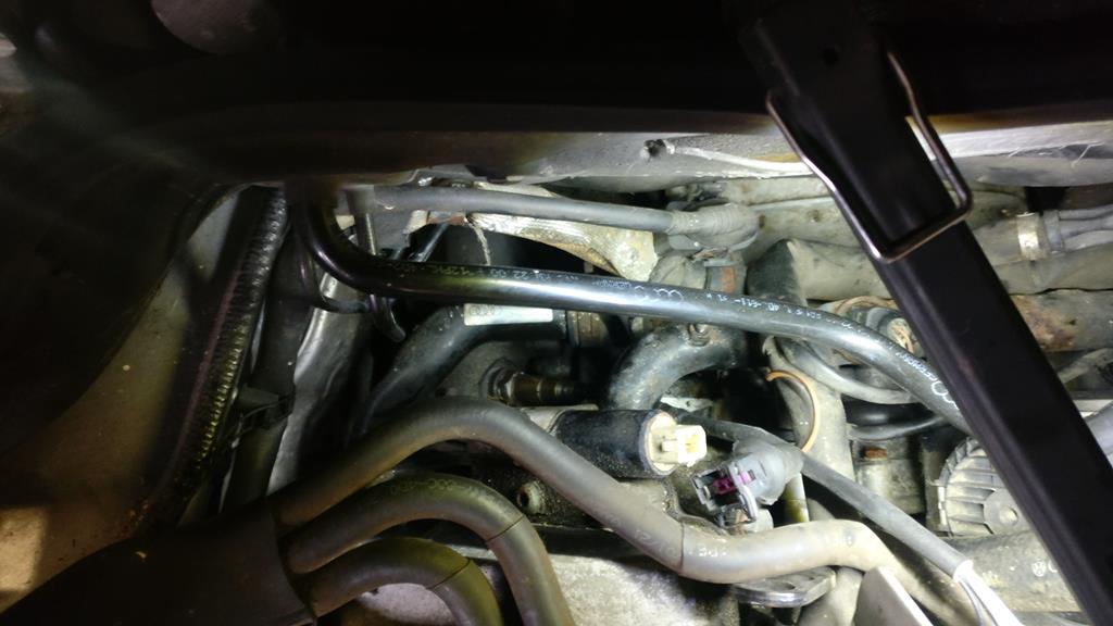

Bank 1 sensor removed
New one fitted, then the same on the other side

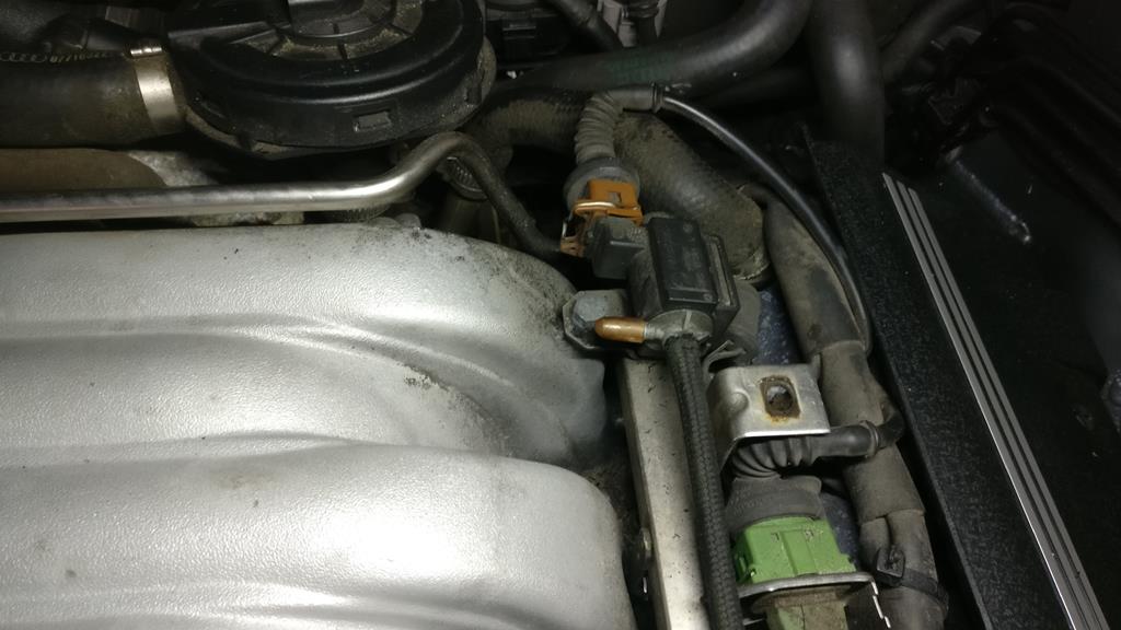

Capped off the SAI solenoid valve. The vacuum supply hose will be removed later.

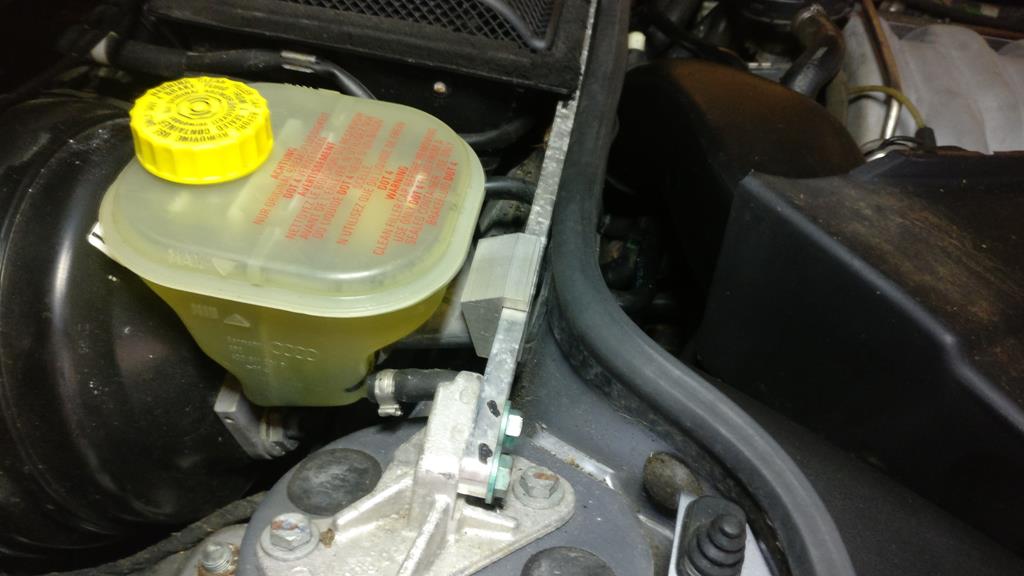

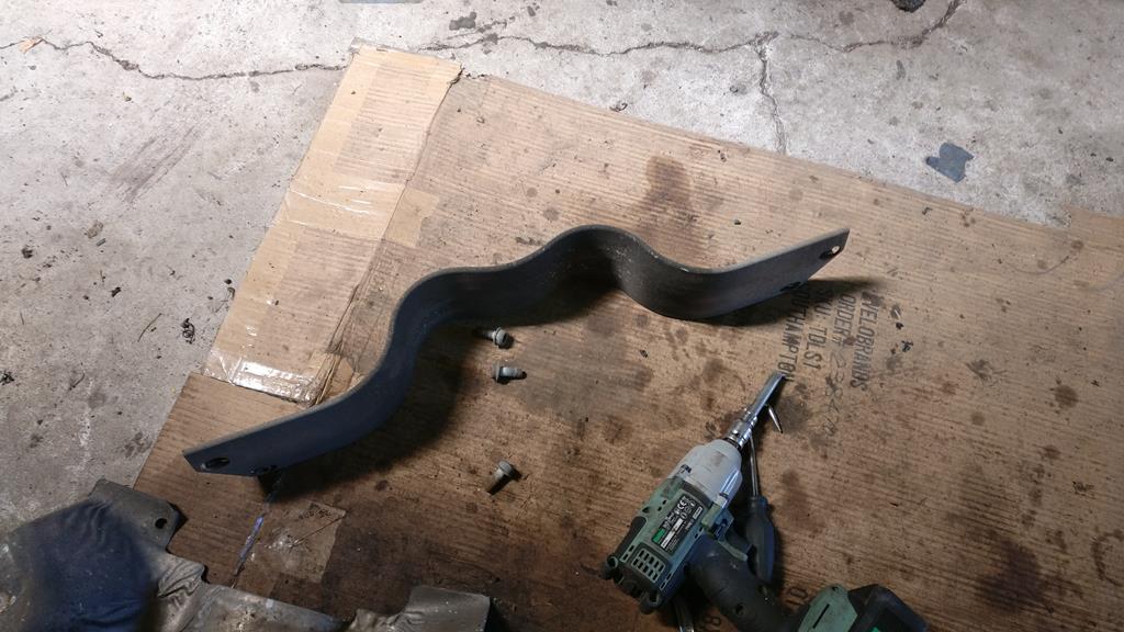

One of the manifold link arms was broken so I replaced that while I was in there
And since I had to take the upper brace out to get the wiring harness out of the way (for the bank 2 sensor) I put a brake block on it when it went back in

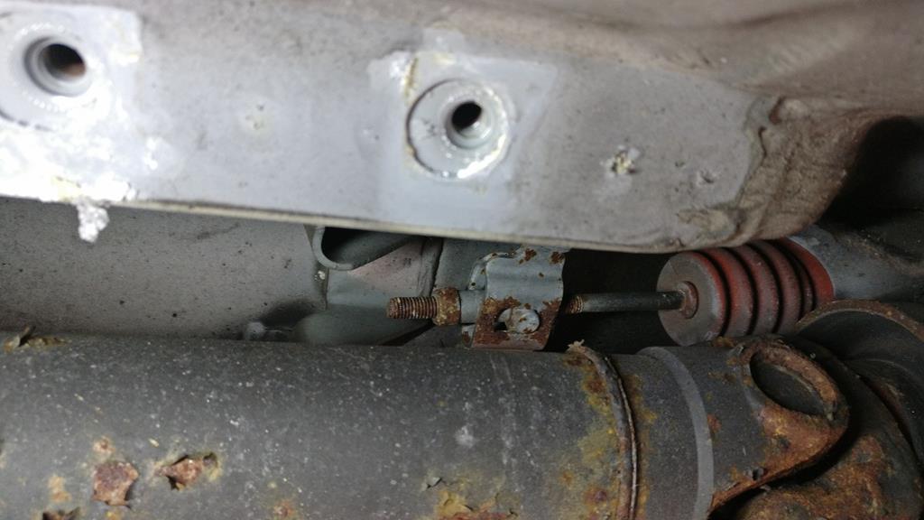

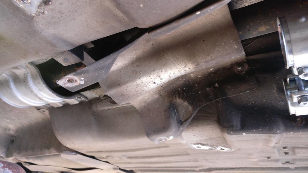

The handbrake adjustment is buried in here:

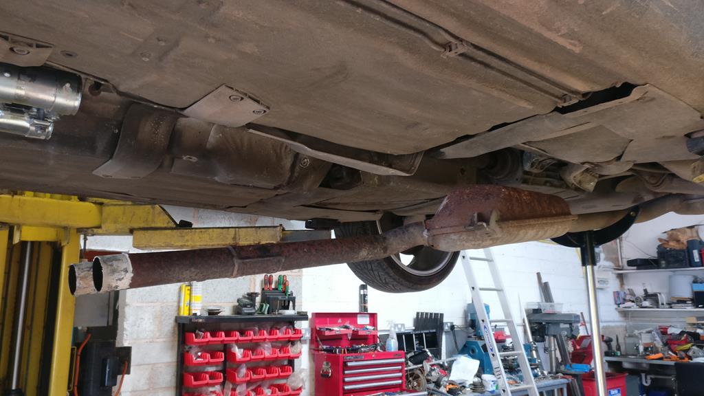

Drop the exhaust and support it with the transmission jack

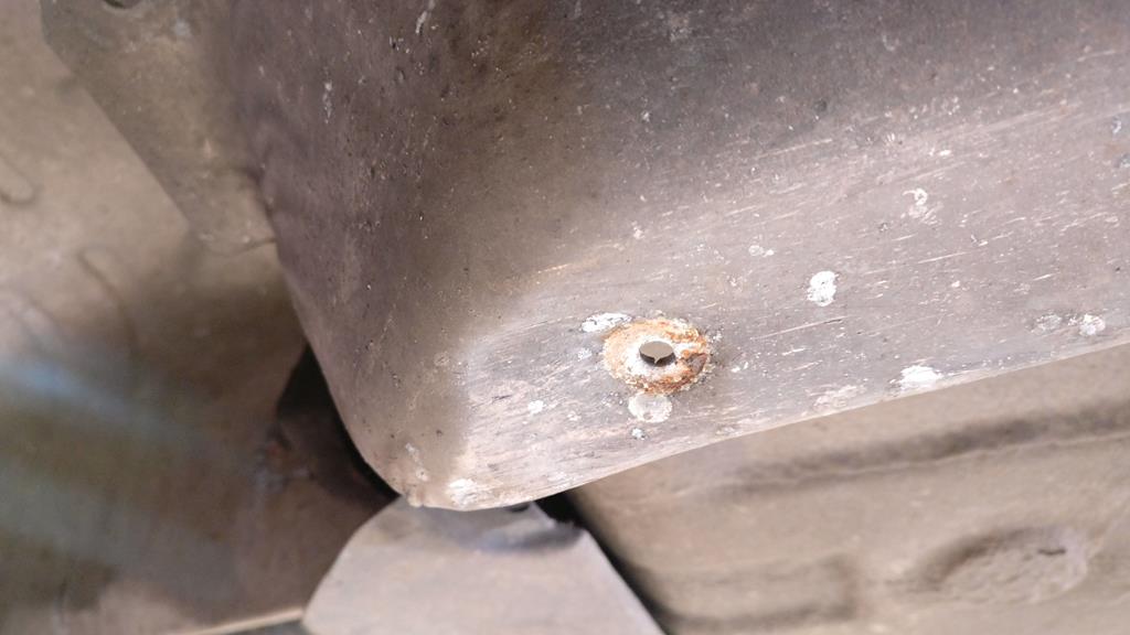

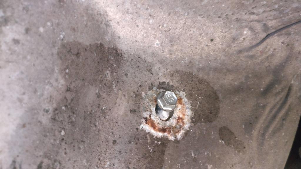

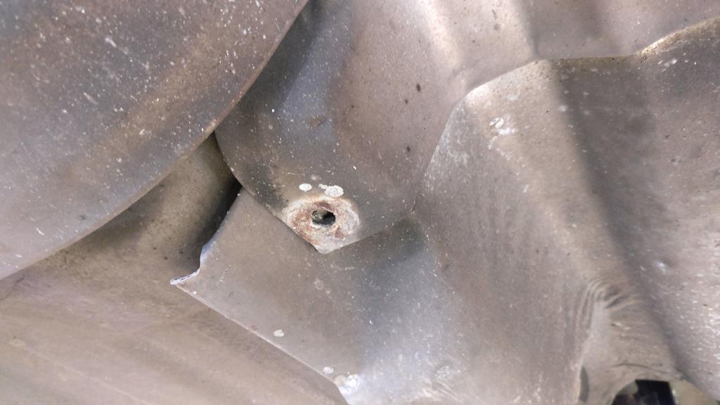

The heat shield studs are mostly broken

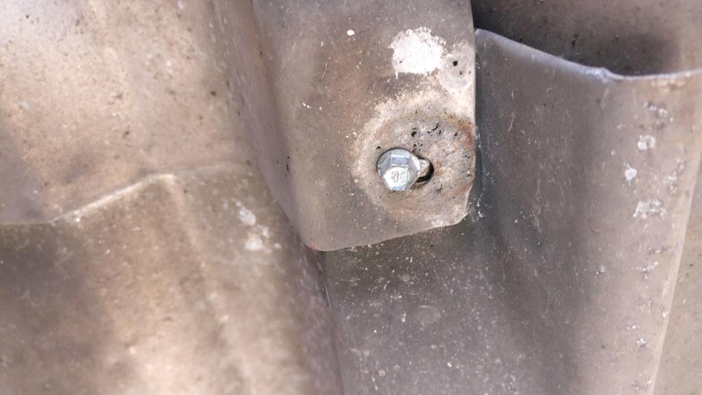

Or held in with self-tappers
Tunnel brace off
This heat shield drops down and then the rear one can come out. The plate at the left if this pic also comes out

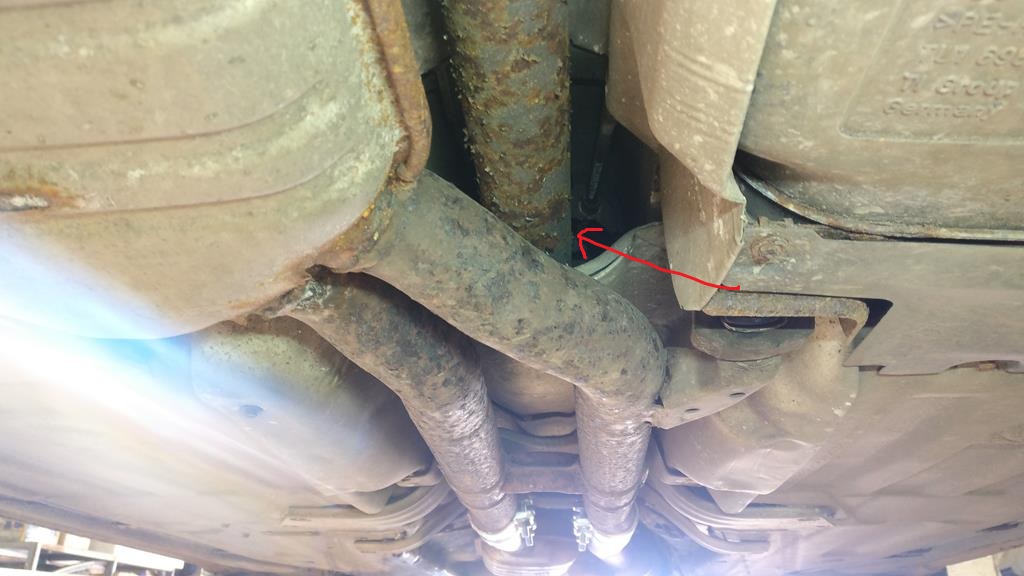

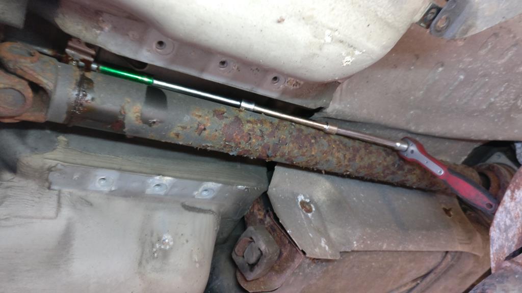

Then you can see the handbrake adjustment above the propshaft

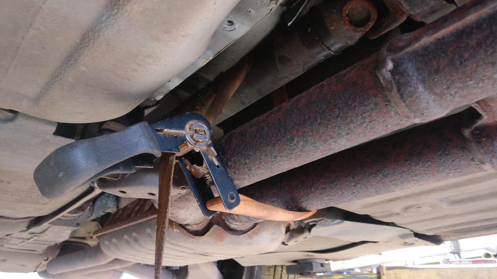

I was able to get to it over the prop with a long extension. I tightened it until the rear brakes started binding, then backed it off a turn. In total it needed about 4 turns.
With the adjustment done I supported the exhaust so I could lower the lift and check the handbrake applied and released ok from the cabin. It did so I put it back together
I don't have a rivnut tool so I temporarily replaced the heat shields using more self tappers. These will do until the engine comes out, whereupon I will replace them with enclosed rivnuts.

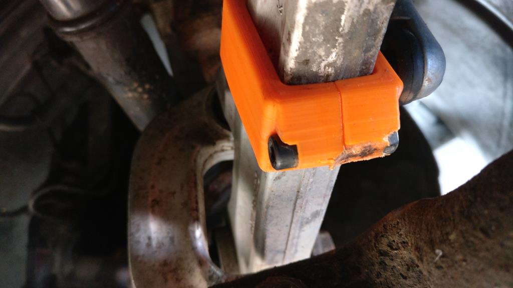

My printed headlight level sensor bracket has been catching on the anti roll bar so I will need to redesign this slightly to make some clearance.
