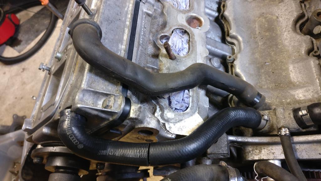

The PF crankcase ventilation hoses are a; knackered, and b; obsolete so I made a replacement from an FL hose instead I still need to make a joiner for this but it'll work nicely

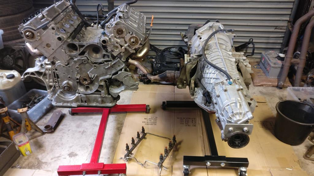

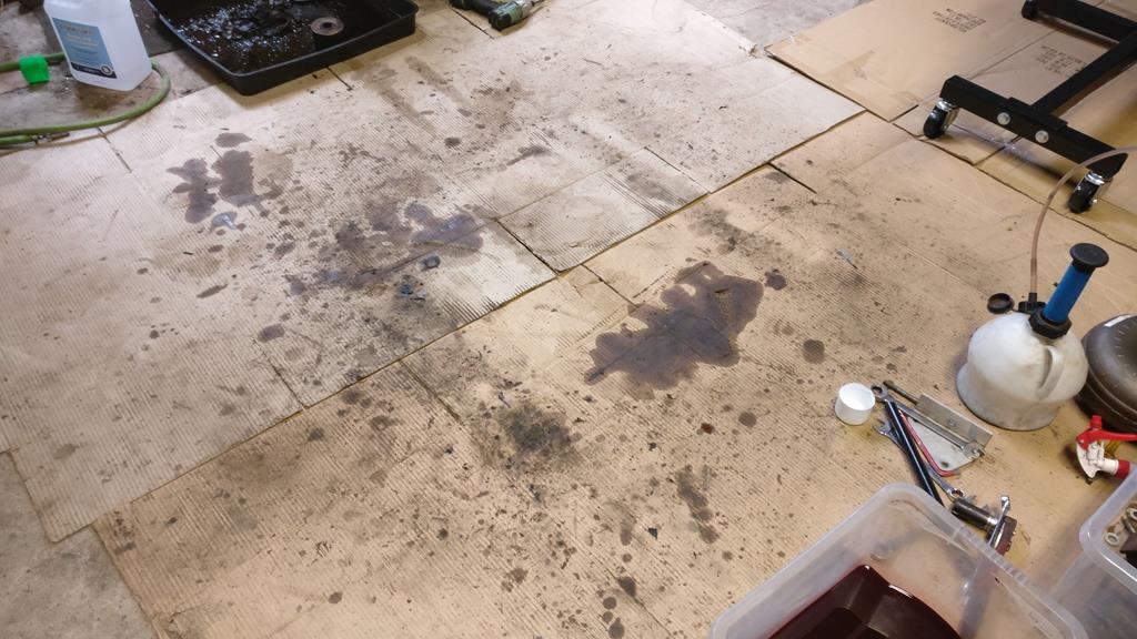

Moved the engine - this is the aftermath on the cardboard protecting the floor!
Engine waiting for parts, gearbox not started yet. MoT on Thursday

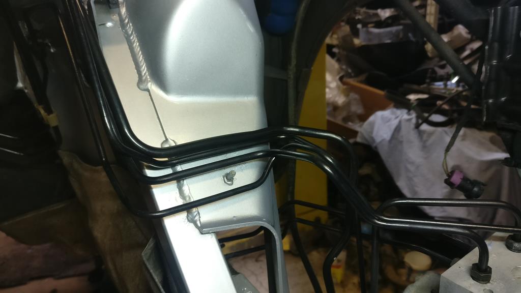

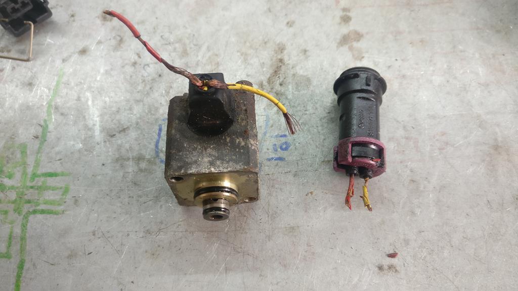

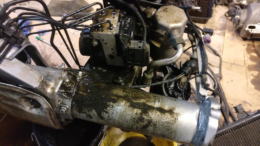

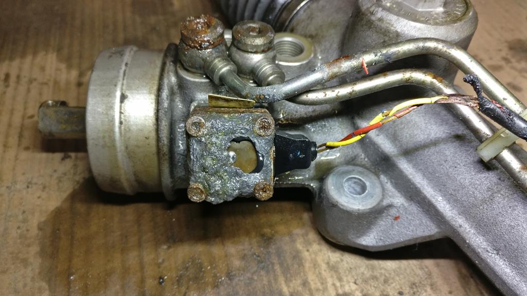

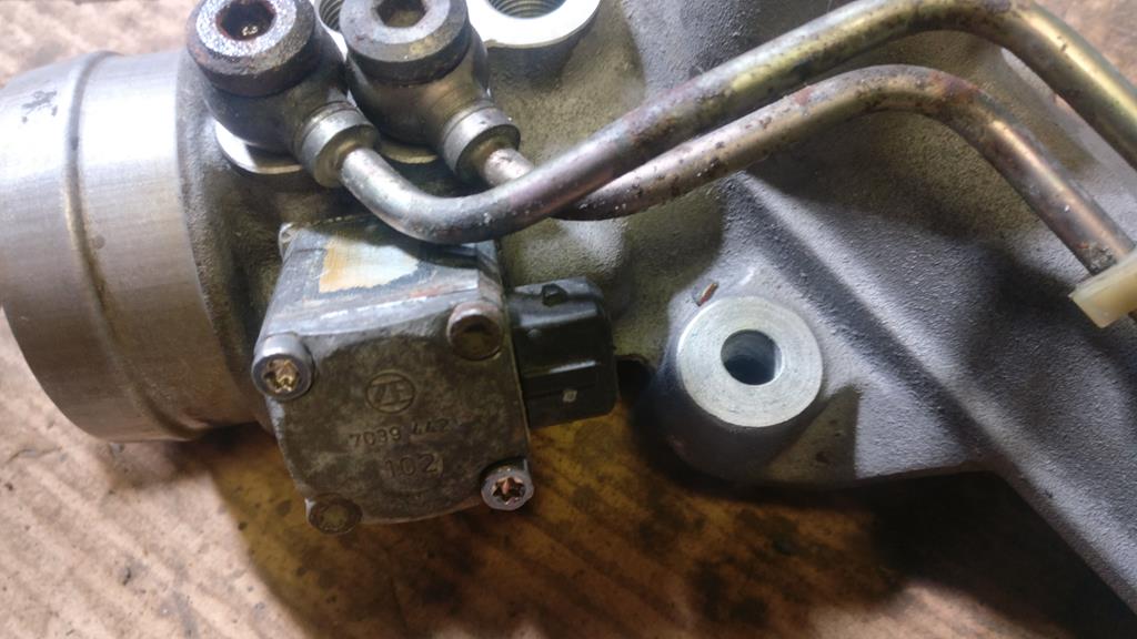

So this is the cause of the power steering leak The top of the servotronic solenoid has corroded to fluff and disintegrated. This will be replaced with the Jaguar / BMW version the same as I did with the Murple.

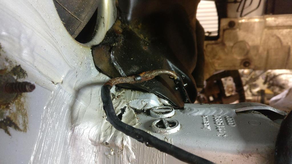

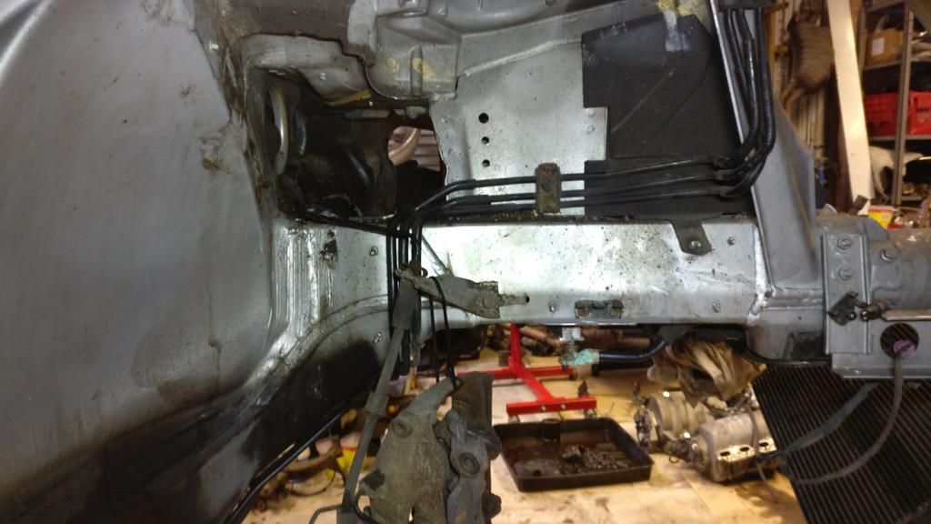

Some before pics of the wheel wells

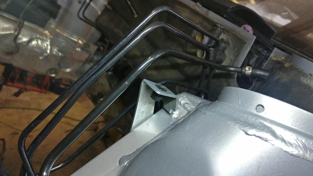

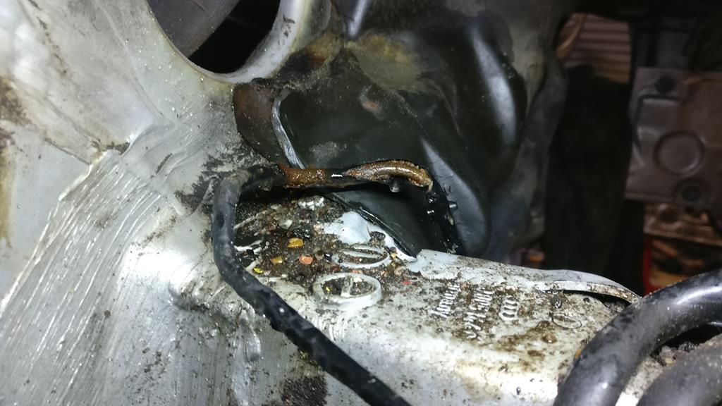

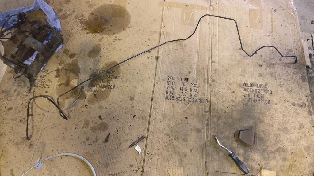

Oh, and the PS fluid has dissolved the plastic coating on the osf brake line which has then rusted away. I'll just swap the whole line while the drivetrain is out.

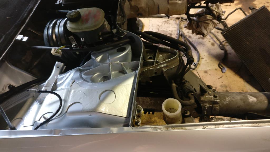

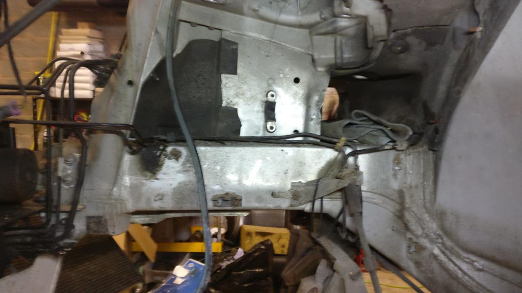

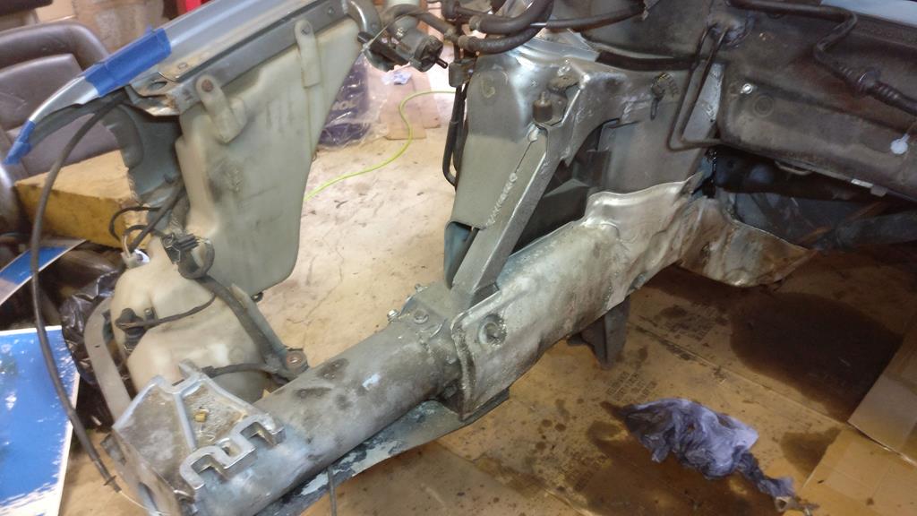

Before and after of cleaning the engine bay
Some serious grot on the left hand side
The damn car dealer lacquer is making everything difficult with its nasty yellow staining everywhere. The brake lines are covered in it
The driver's side came up pretty well, but the passenger side is going to need another session tomorrow.

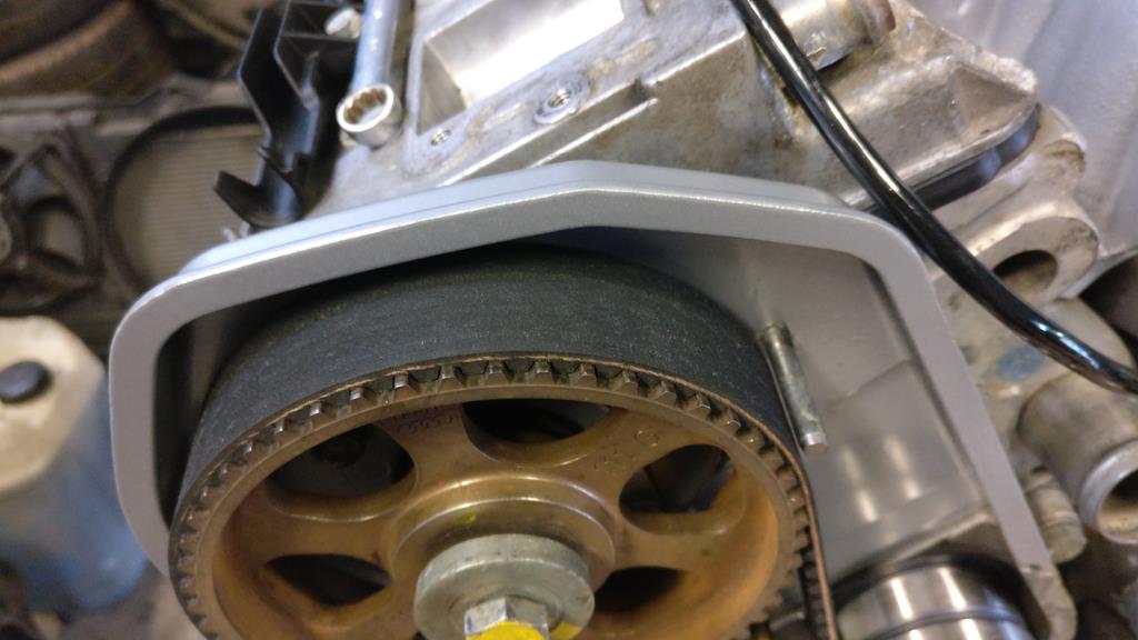

Mike came over yesterday, and having stood down from the mad panic we had a nice day of tinkering instead.

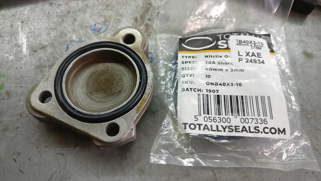

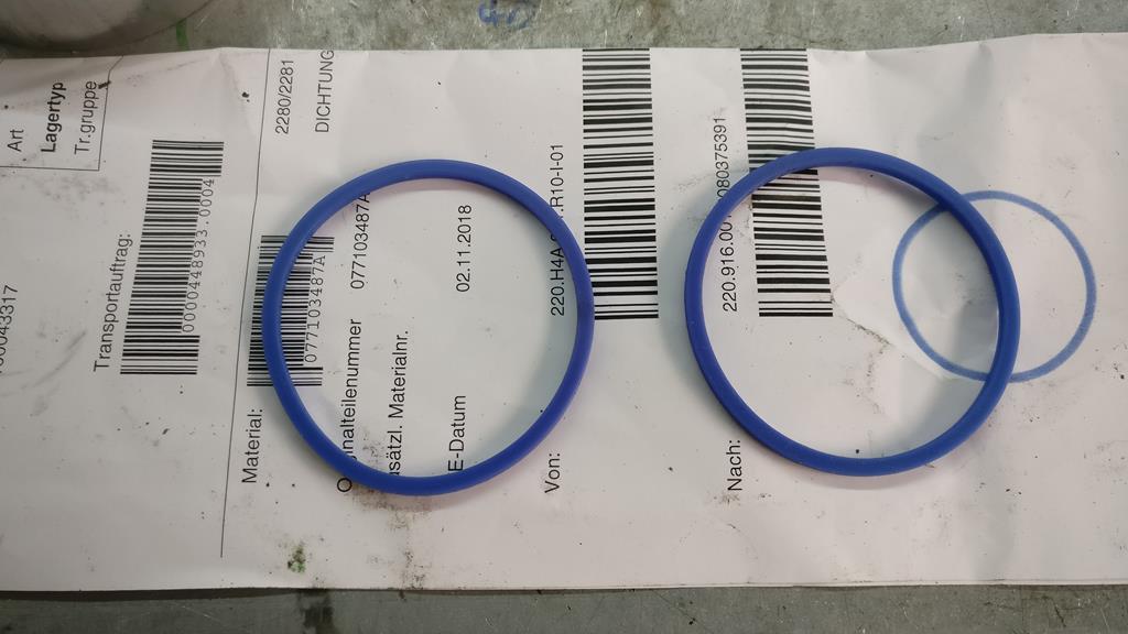

There are two types of seal on the cam ends. These larger ones are still available from Tradition:
The smaller ones are not available at all, so after a bit of fiddling I found that a 40x3 standard o-ring fits perfectly

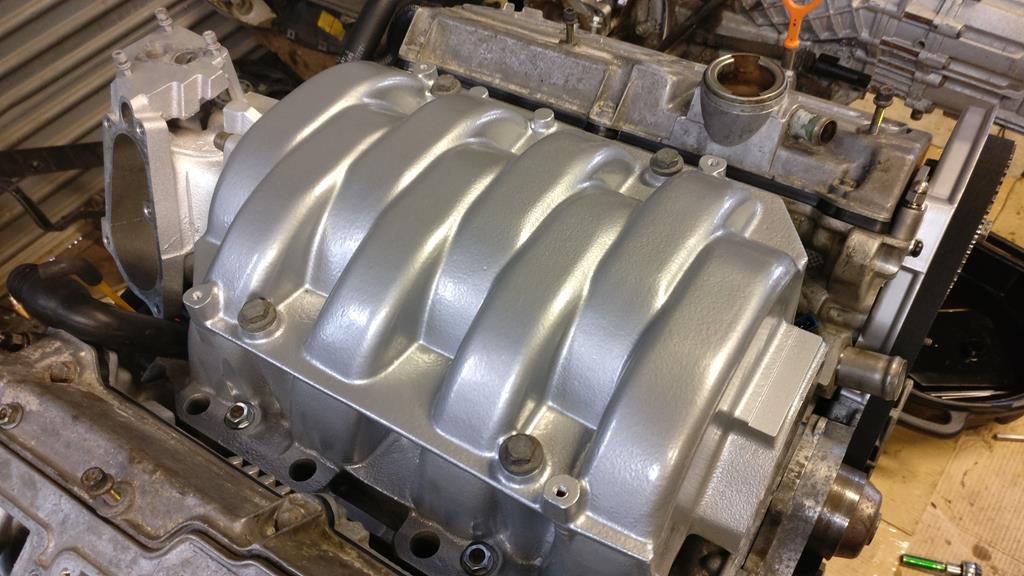

I had the inlet manifold done to match as this was raw aluminium and pretty nasty

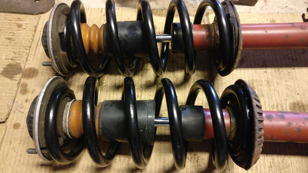

All the springs too. This one sits quite low at the rear, which seems to be a PF thing, so I've used a cunning combination of PF and FL bits on the front struts to get a free lowering which will hopefully get it to sit about flat.
If it turns out too low then I can swap stuff around at the front to lift that, and put some FL rear springs on to lift the back end. Plenty of options once its back together

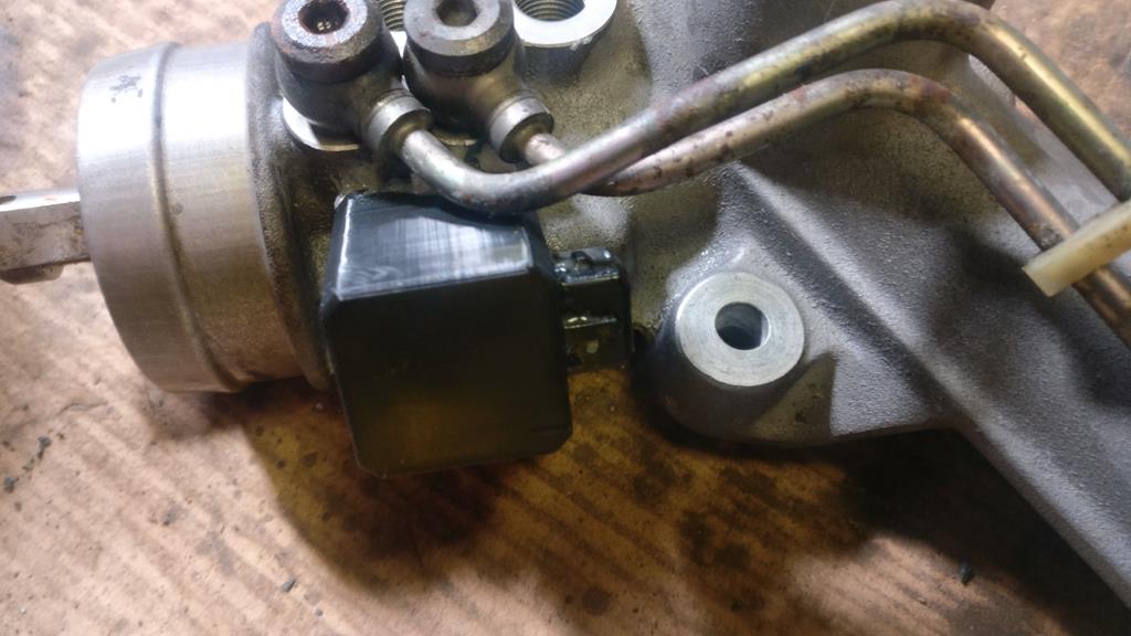

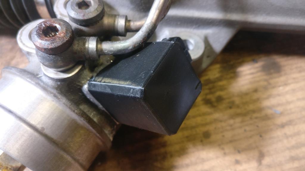

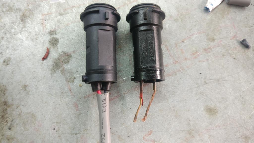

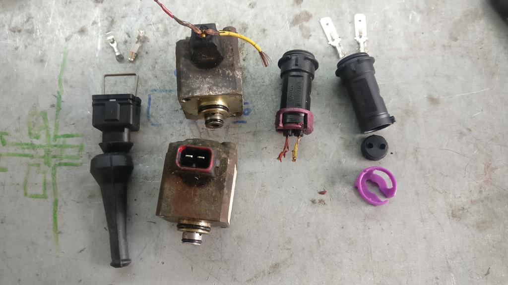

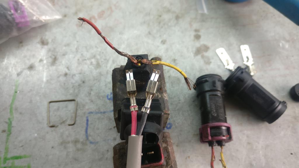

Back on this after some time on other things. On to the steering rack and the servotronic solenoid

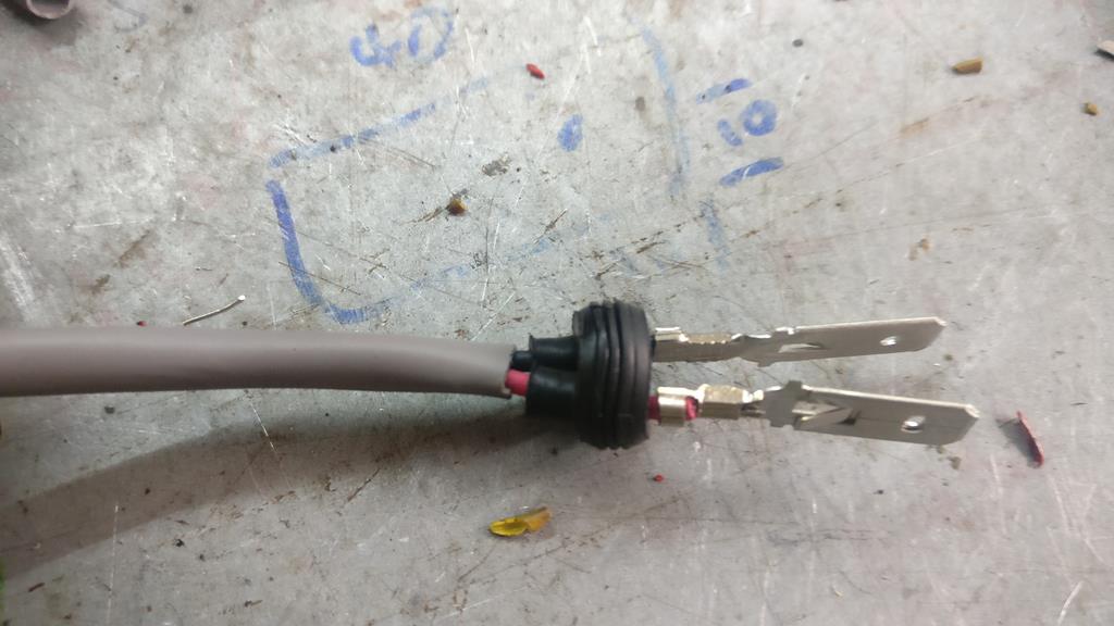

This is a Jag XJ solenoid with a Bosch Junior Timer connector instead of the silly disintegrating wire that Audi claim is to make it possible to remove the rack (which is bunk btw - this one works just fine)
I printed a polyurethane boot to cover it up, which is lined with waxoyl to stop any moisture getting in so this one won't corrode away like the last one did

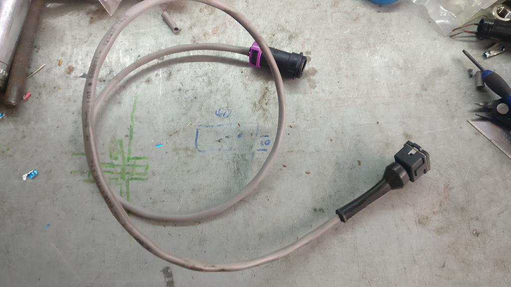

Next I need to make a wiring harness - I may have shown this in the murple thread, but its here again for completeness. This is all that is left of the original:
Parts to make the Jag version work
Junior Timer terminals crimped on with red to red. Not sure if these solenoids are polarity sensitive but I'm keeping them the same anyway.
Assembled with the boot.
Terminals on the other end. The cable is 85cm by the way.
Red to red again
Completed adapter harness
Which fits like this This will probably outlast being allowed to burn dinosaur squeezings

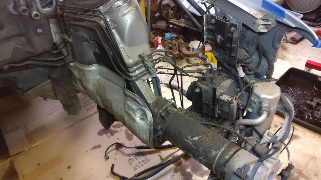

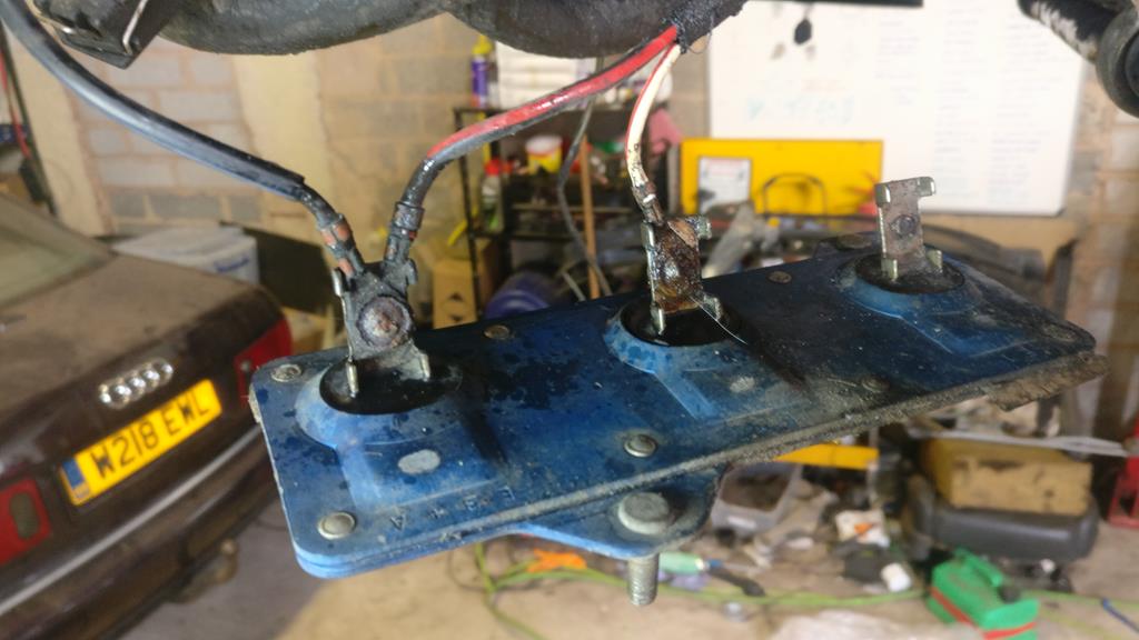

Back on to cleaning the engine bay. The fan resistor pack is looking a bit sad with all the studs snapped off

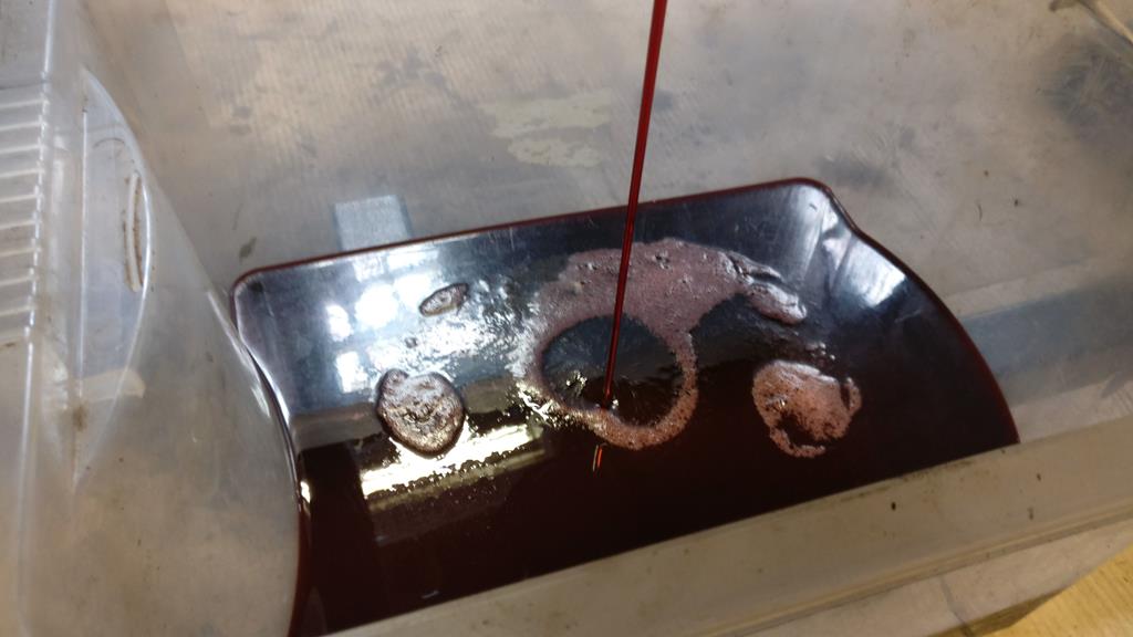

Got in a grump with cleaning so moved on to the brakes. The fluid is a bit grim, as always. No one ever changes it
Old brake fluid vs new
There was a very good reason for changing the brake fluid before I then took the braking system apart, but I forget what it was The OSF hard line had been ruined by the PS fluid eating the plastic coating allowing it to rust away so this has to come out

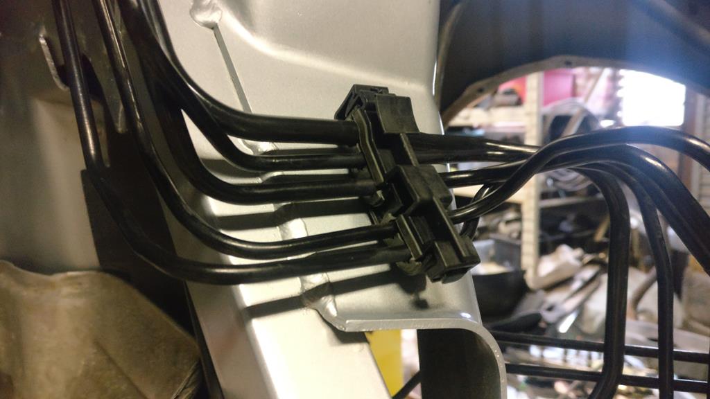

Something has dissolved the rubber in the brake pipe clip - probably the copious amount of PS fluid which was coating everything
Old brake pipe off
Removed the clip and cleaned all the yellow nastiness off with thinners
Looking much nicer
OSF brake pipe refitted and a replacement clip in place.
I'll finish cleaning the bay tomorrow and then I can put the rack back in
