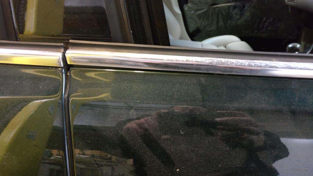

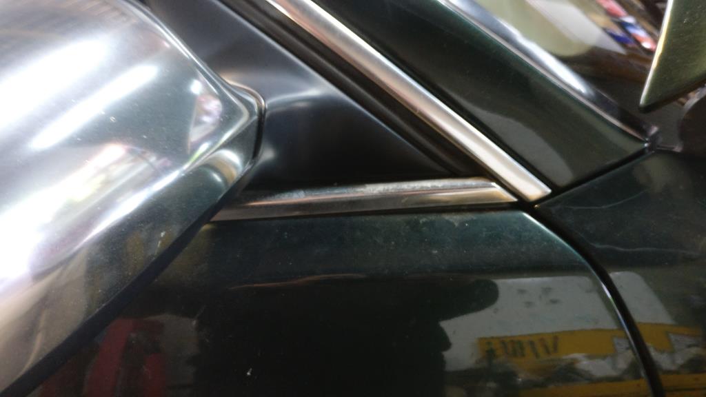

The driver's door trim strip was in a bad state - the aluminium is not recoverable, and its bent at both ends
Window frame out so I can change the strip
Bad one removed

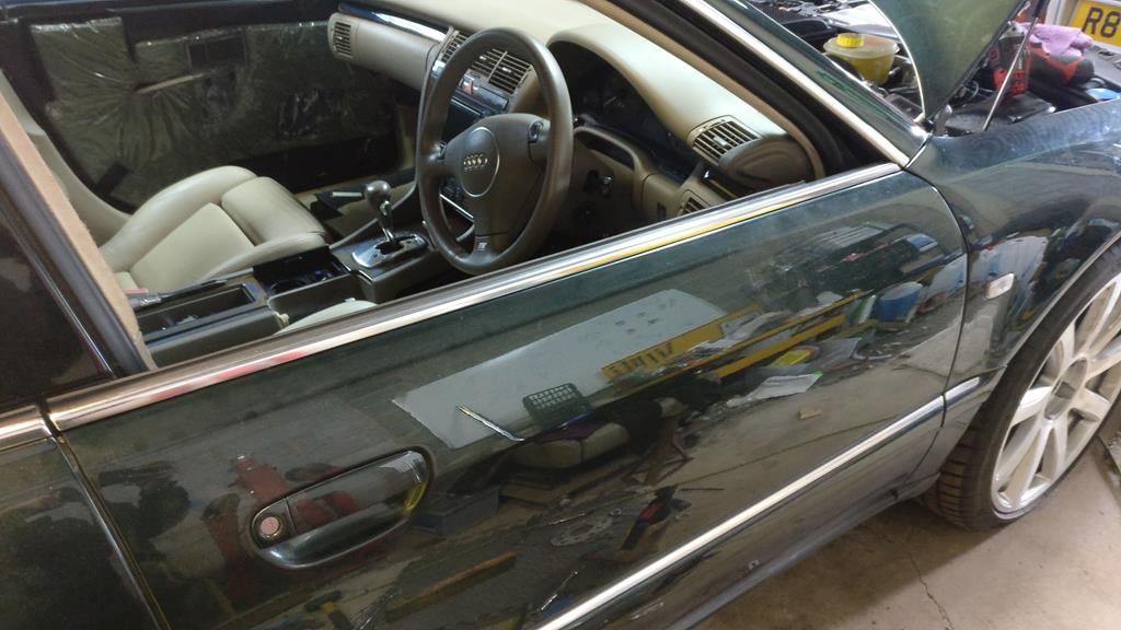

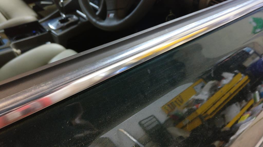

Replacement fitted - I polished this one before putting it on
Shiny
Mirror before
and after

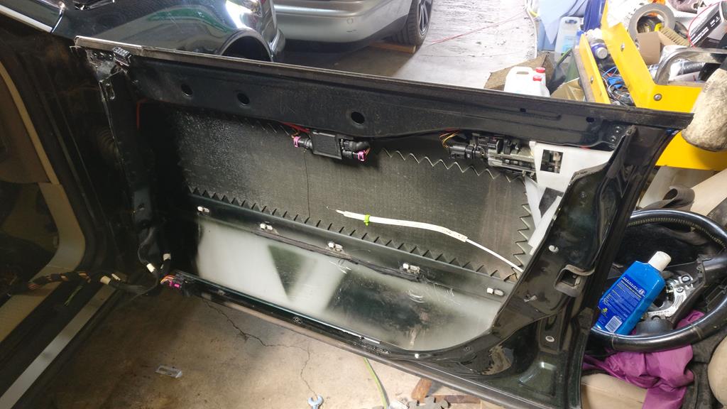

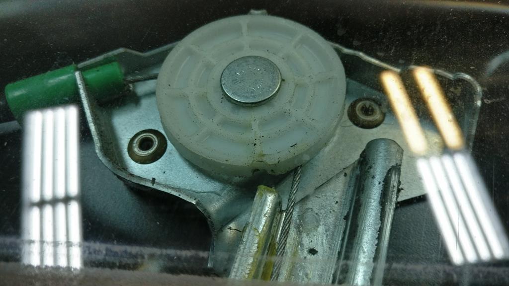

The front passenger window was oddly crunchy so I removed the frame to investigate. While it was off, I polished the trim on this side - this one came out fine

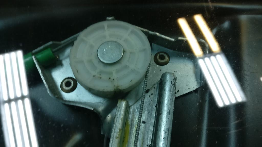

Very bizarre - the cable has somehow escaped from the pulley Its under the glass so not particulary easy to get to
Some fiddling and poking got it back on. The window slides up and down just fine so I'm not sure how the cable came off in the first place. It shows no inclination to come off again

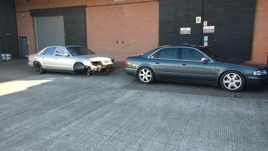

The Allroad is broken (because Allroad) so Lilith is doing yard donkey duties and she is not impressed! A D2 moving another D2 like this is very hard to manuever. It would be much easier with something short like an A2
