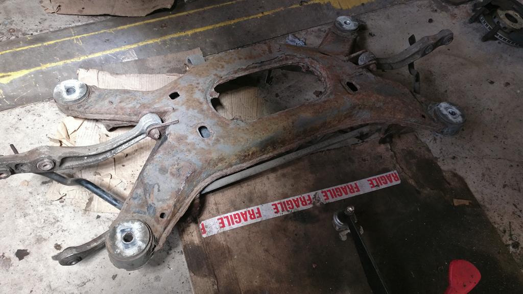

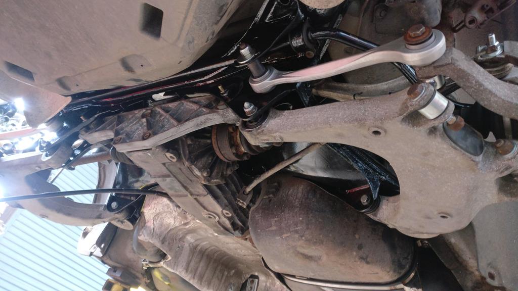

This weekend Marcel is here with his 2.8 so we can replace the rear subframe
We wasted no time stripping the rear end and removing the subframe
The old one is crusty but recoverable so this now gives me a rolling spare again after using my spare on the FE.

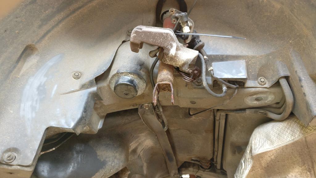

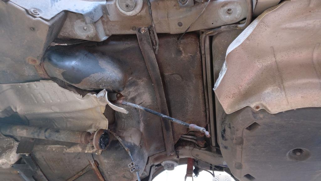

Reasonable condition underneath. The heat shields had been smushed and attached with tekscrews at some point, and the tank straps are pretty crusty

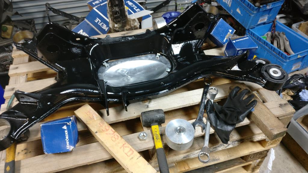

Marcel had already prepared a replacement subframe, blasting then powdercoating, then painting, then internal waxing. This will probably outlast the rest of the car now

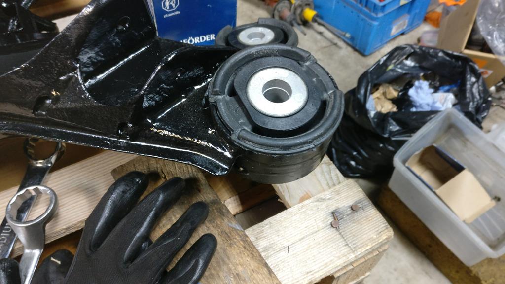

One of apparently only three sets of Lemforder D3 bushes ever produced After I bought two sets and Marcel bought one they became out of stock everywhere and Lemforder aren't making any more. Very odd.

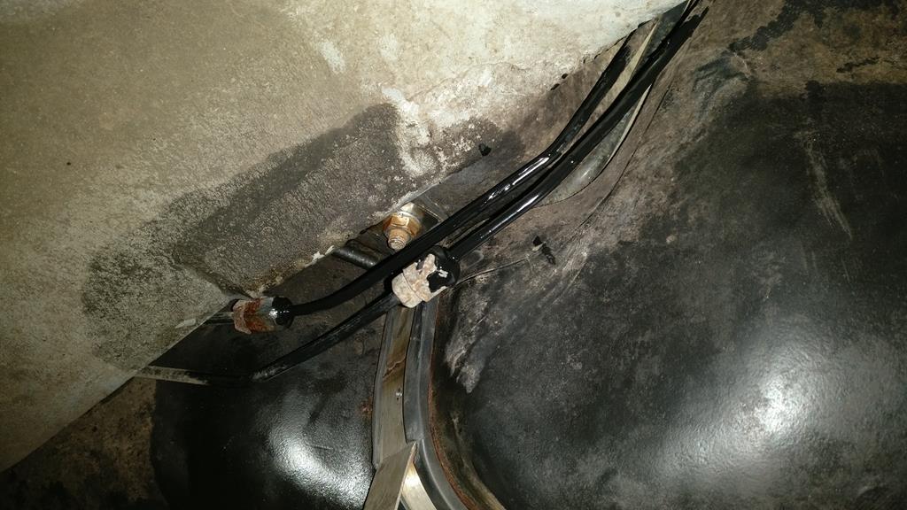

Heat shields all fixed, with rivnuts to replace the broken studs as usual
Fabricated stainless steel tank straps
Brake pipes cleaned up and repainted while we had good access to them

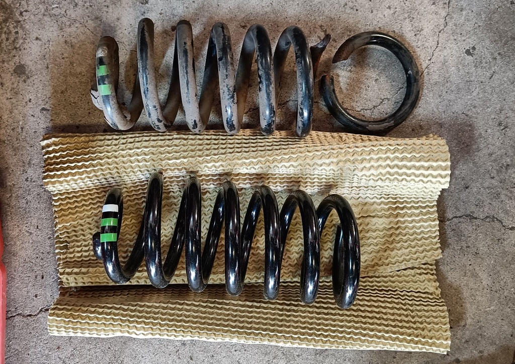

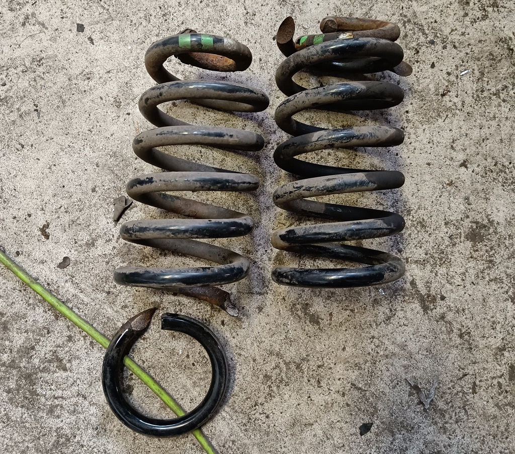

Broken rear springs
New replacement from Tradition

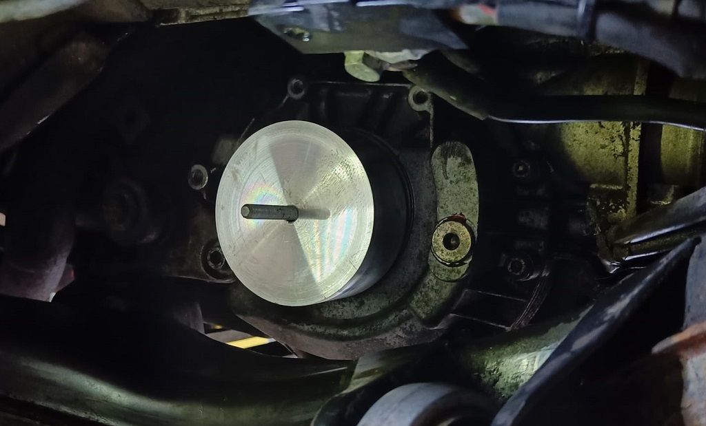

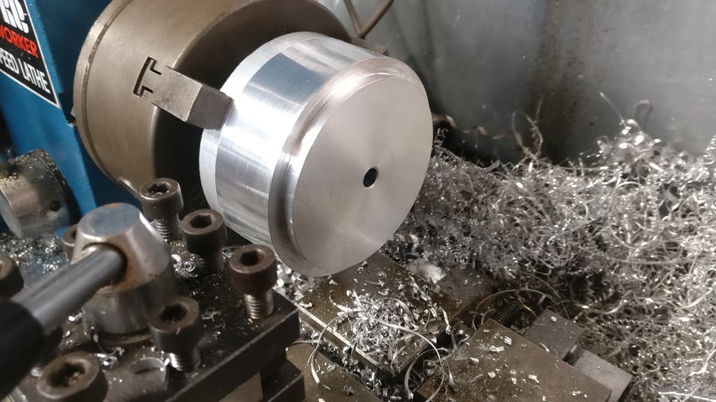

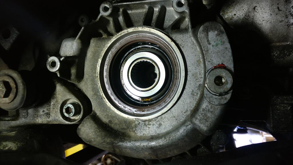

The right gearbox seal is leaking. I've been meaning to make a tool to refit those for ages so today is the day.
Its quite tight in here to hammer a seal in!
The flange is held in with a single bolt
With the flange out the seal can be easily removed
A piece of threaded bar is screwed in to the diff, and then the tool can be tightened up to push the new seal in place to the proper depth.

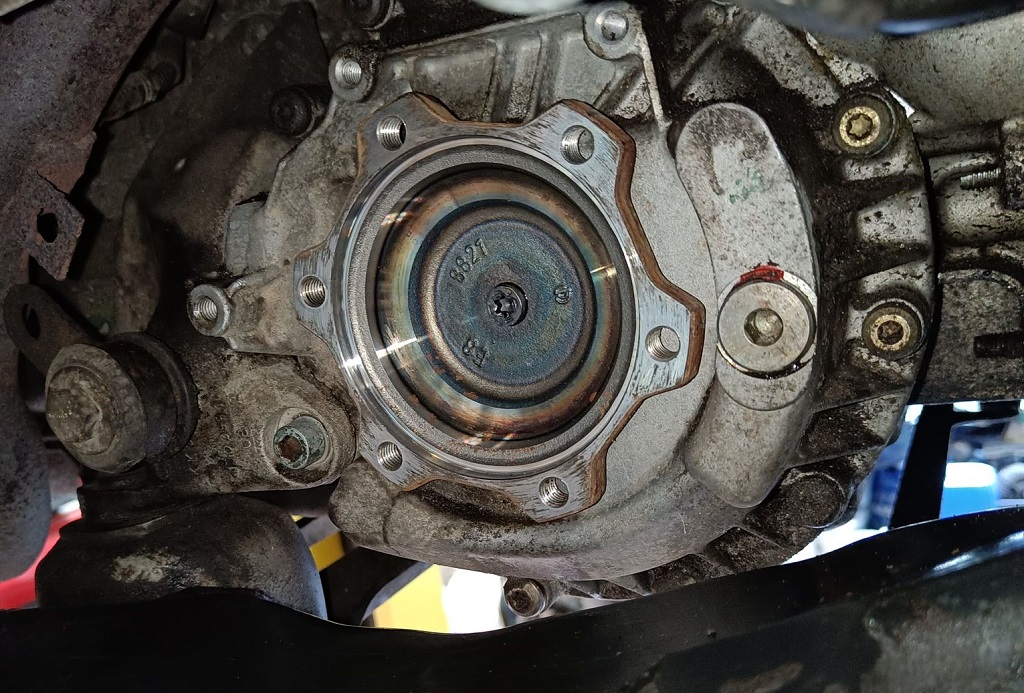

New seal fitted

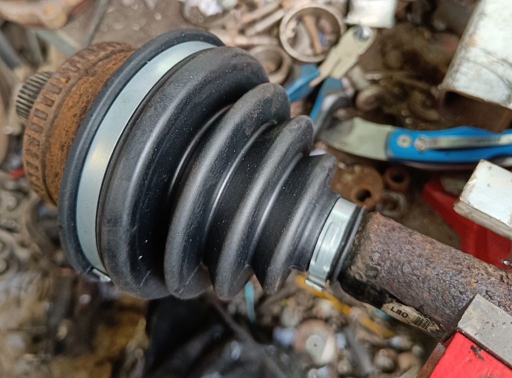

Replaced the CV boot while the shaft was out as it was perished and would fail soon
All done in time for a wheel alignment in the morning

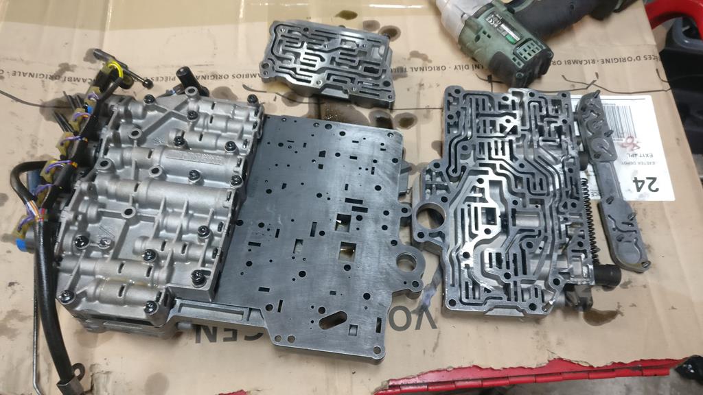

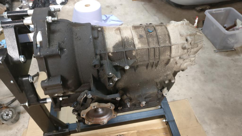

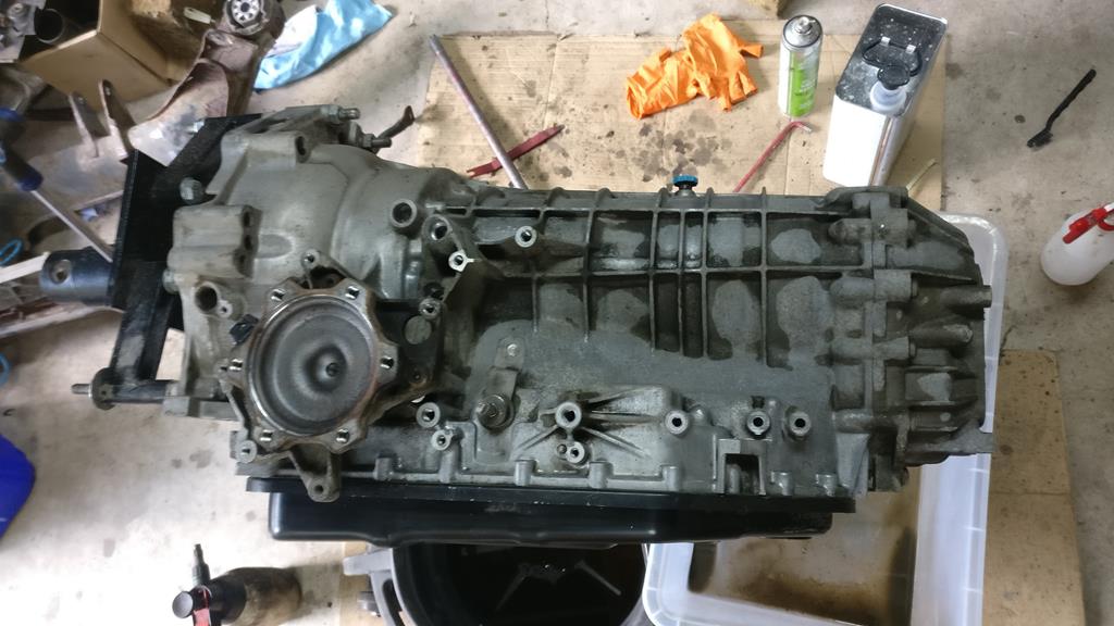

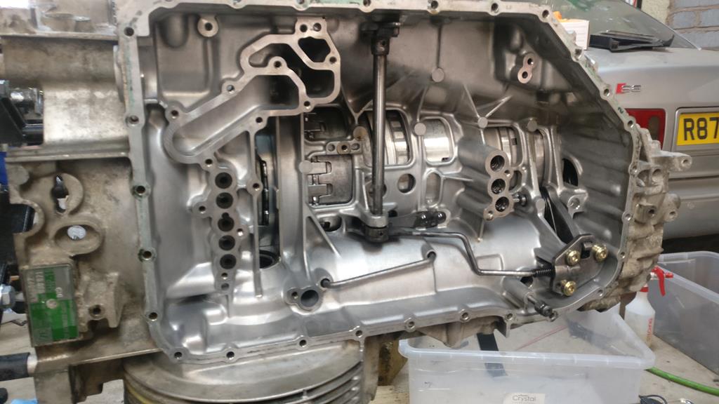

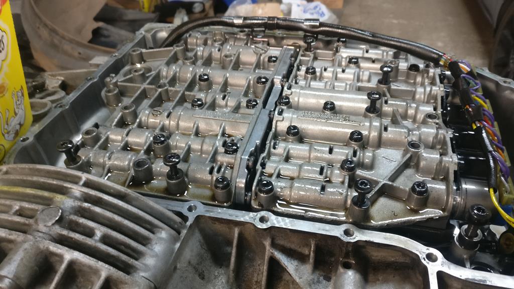

A new little project - a 5HP19FL freshen-up and swap out for a 2.8 FWD PF.
Standard 2.8 anti-corrosion treatment
Cleaned up and tipped on its side to drain the diff
Valve body
No valve body
Valve body in bits in prep for an upgraded pressure valve which doesn't fit
