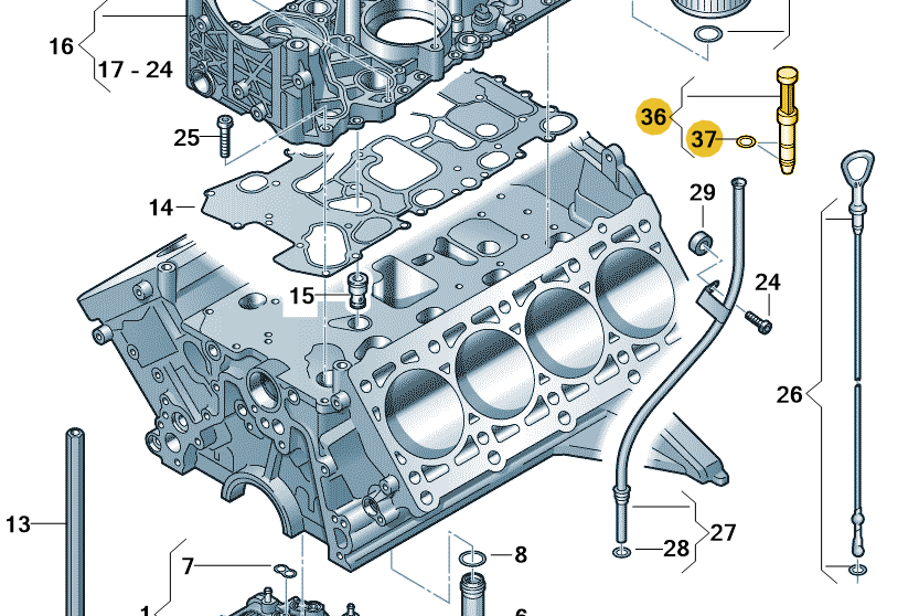

In regards to the 4.2tdi engine, I can only find one reference to the dipstick in the following PDF:
10-Service Manual 8-cylinder TDI engine (4 2 ltr 4-valve common rail).pdf
You'll find it in section '19 - Cooling' in sub-section 3 (p.249). The PDF shows it with an actual dipstick, but the official parts catalogue shows it as only having a plug (part #26 comes up as 'not for this model'). The fact that it has an o-ring would imply that you can remove the plug.

Thanks Steamship. As long as I can get the oil extractor tube in there. I always do a 'top' service where possible, getting a bit creaky to maul about underneath.
