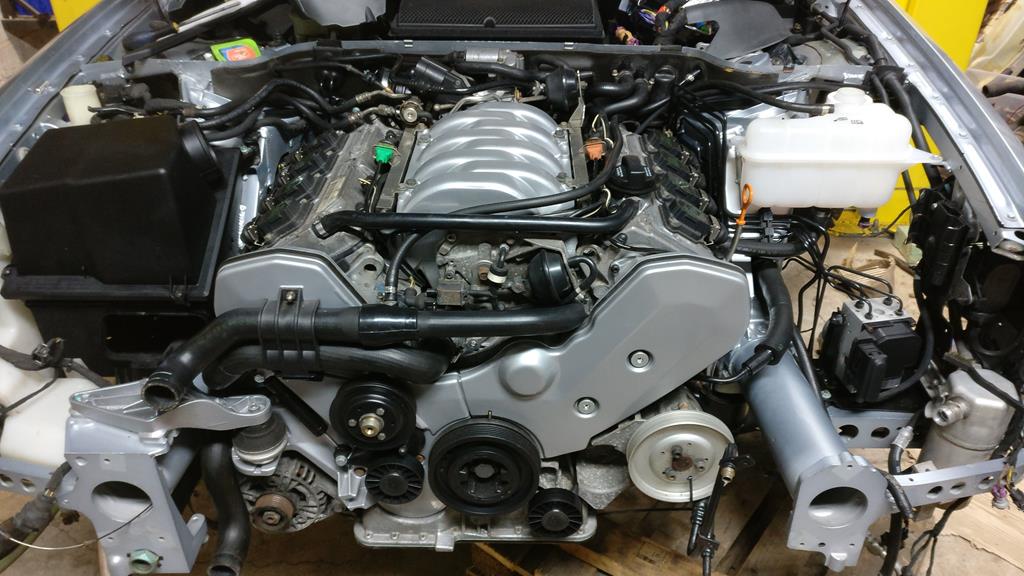

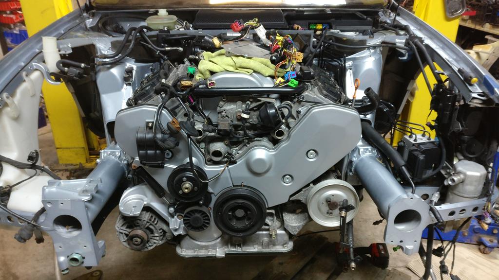

Back on this one after an extended hiatus as I need it finished and sold, and I'm fed up of moving it out of the way!

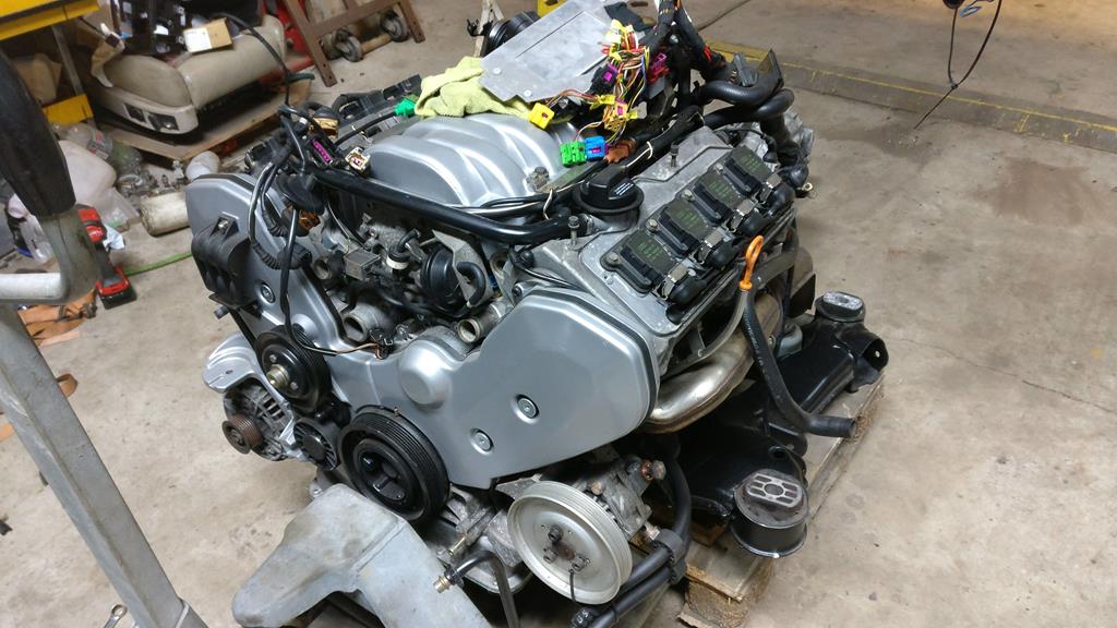

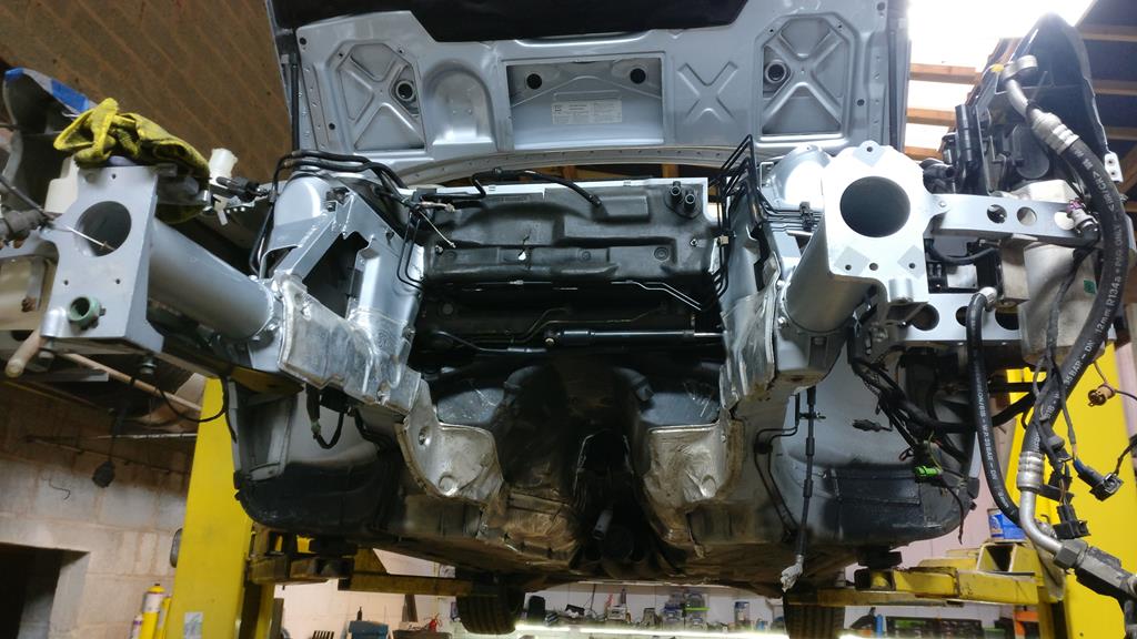

The engine is ready to go back in
The engine bay is ready for the engine to go back in
So I put it back in.

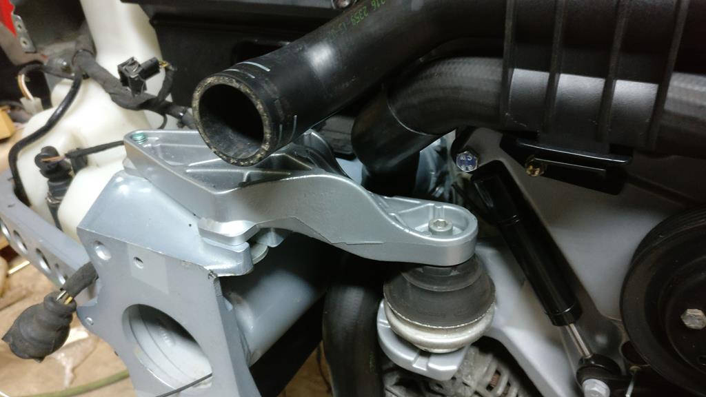

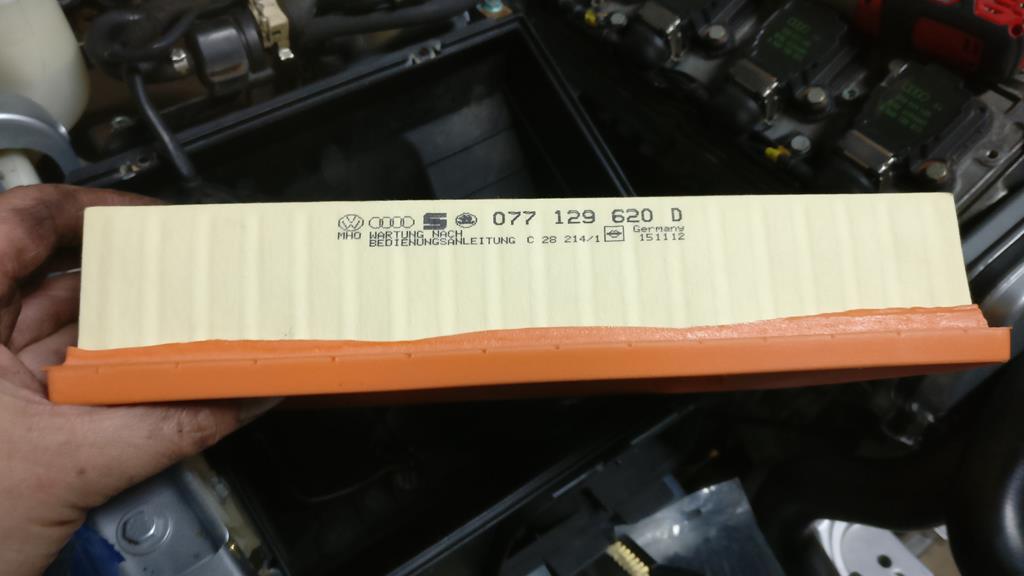

I think this car deserves one of the last ever genuine air filters

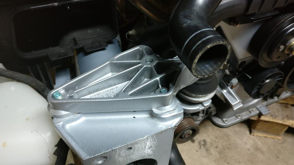

As the belt covers and manifold are powdercoated, I did the snub mount as well.
Nice and smart

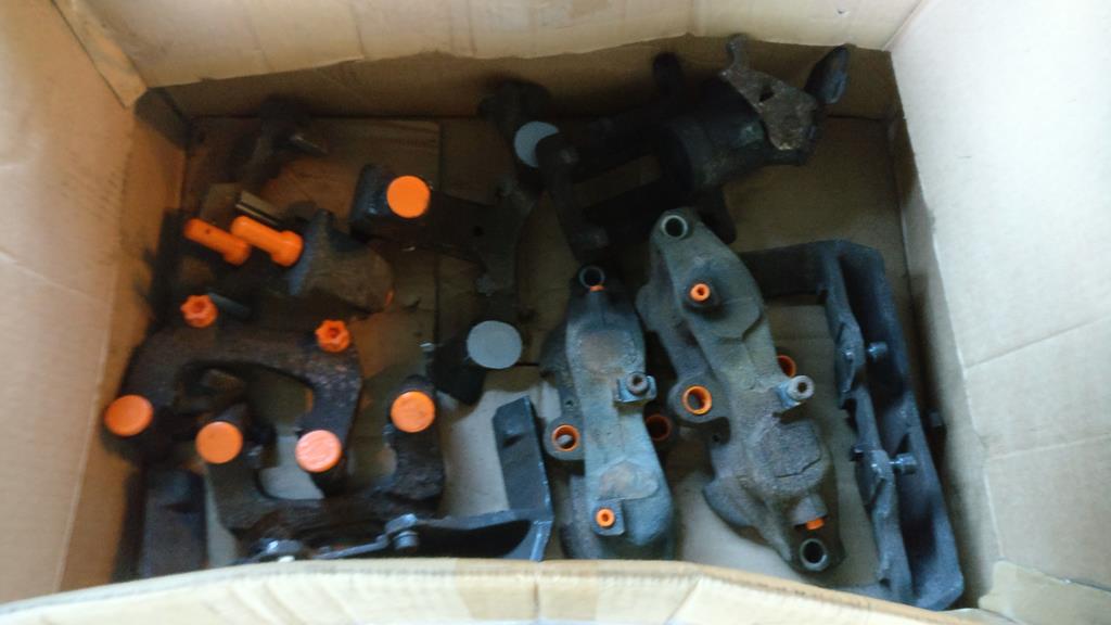

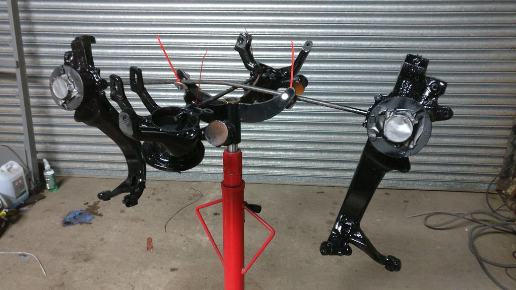

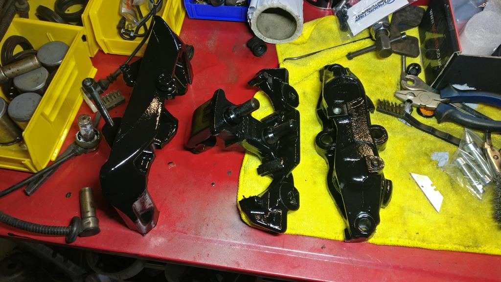

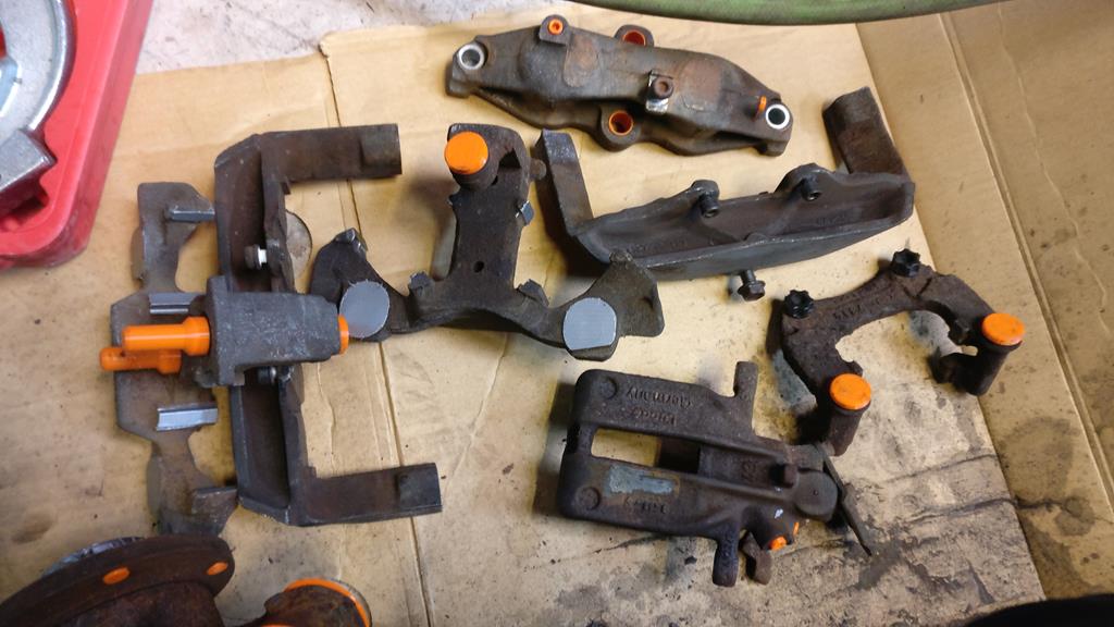

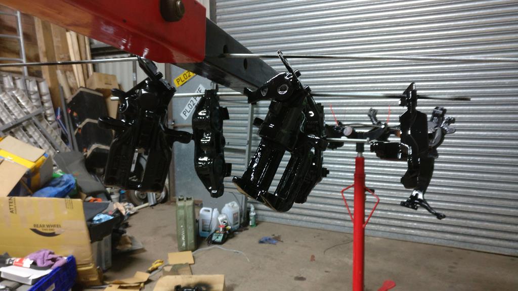

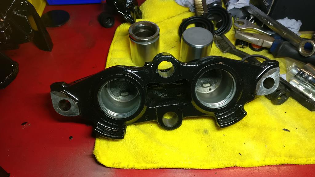

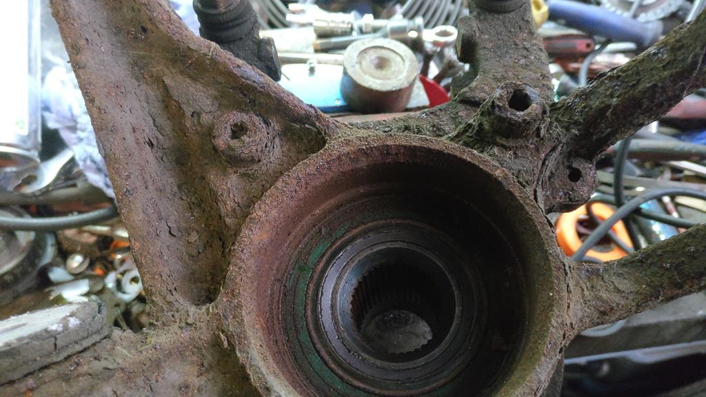

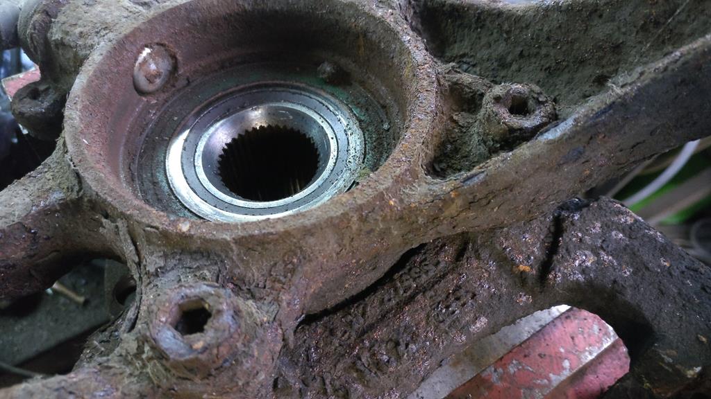

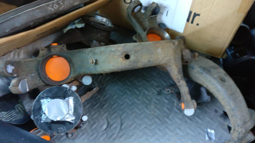

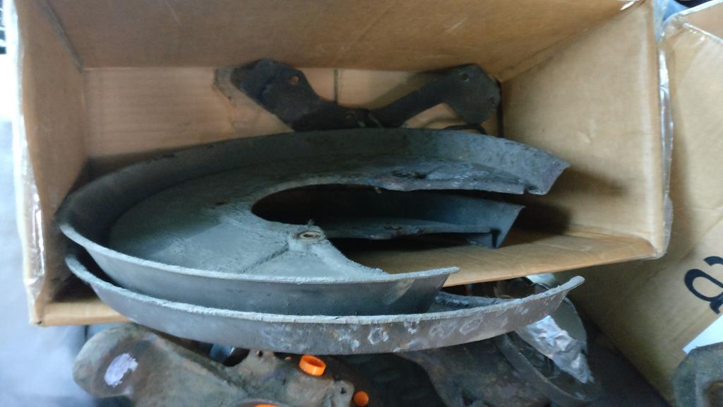

Much of the running gear is steel on the PF and so very rusty. This will not do Stripped the calipers completely

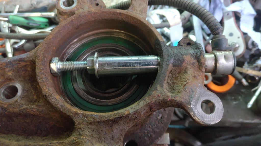

Printed a bunch of blanking plugs
Bits and bobs

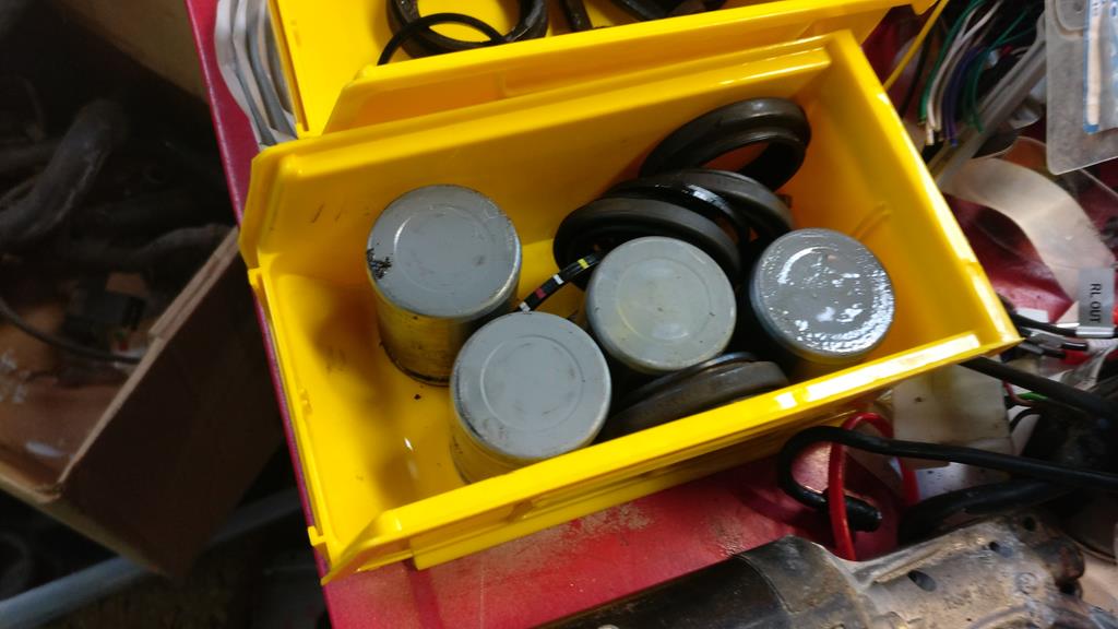

Pistons - the front ones are fine, the rears are toast
Crusty rear hubs
Pushing the ABS sensors out

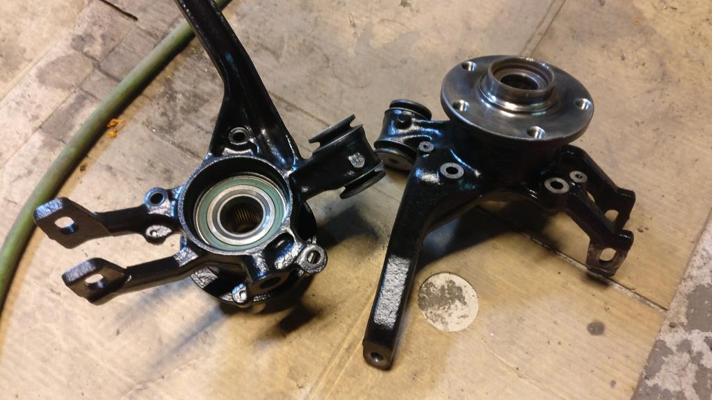

Front hubs prepped as well

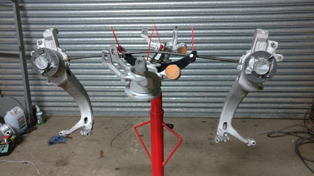

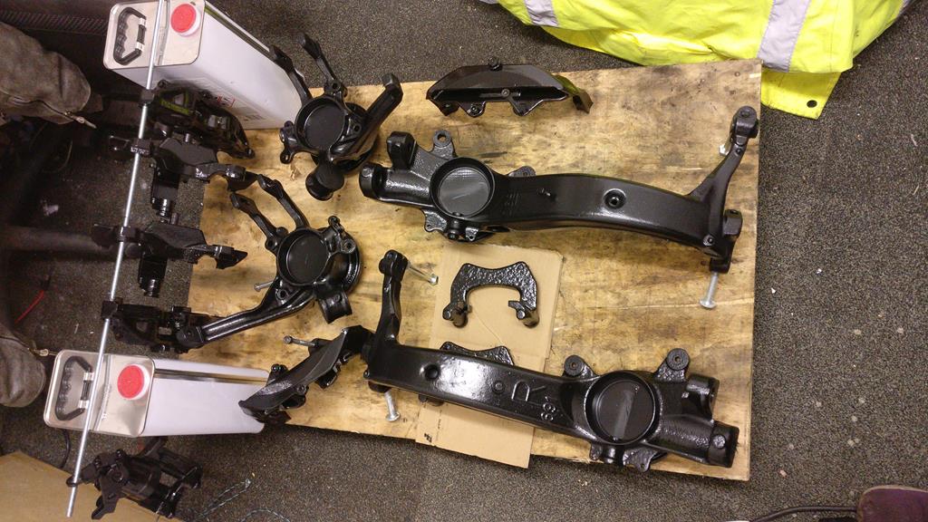

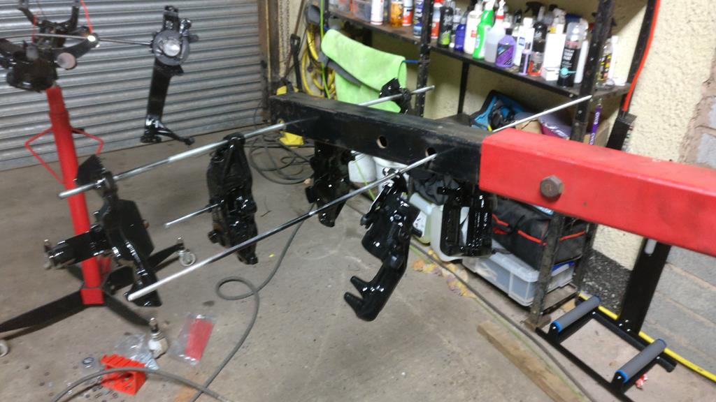

All ready to go for blasting
Blasted and clean
and painted
Calipers too
Sitting in the office to dry for a week

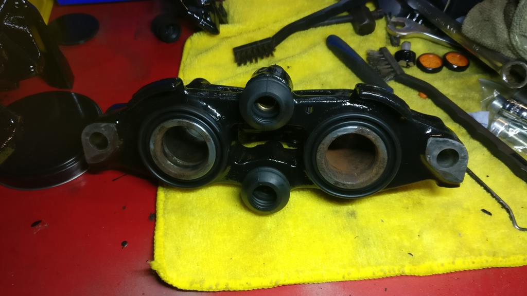

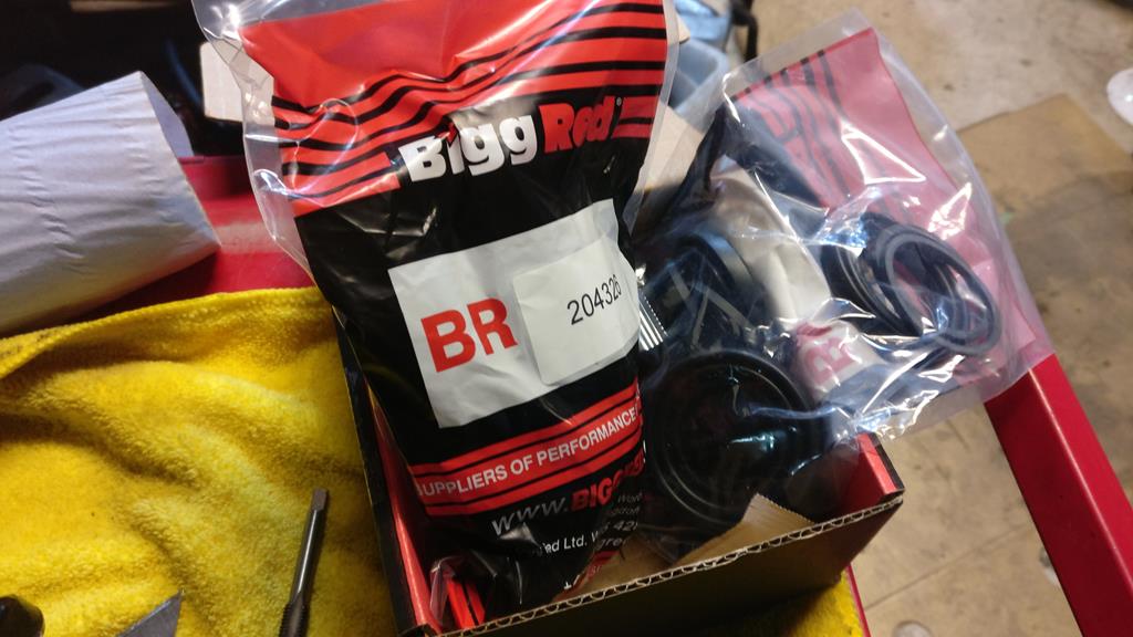

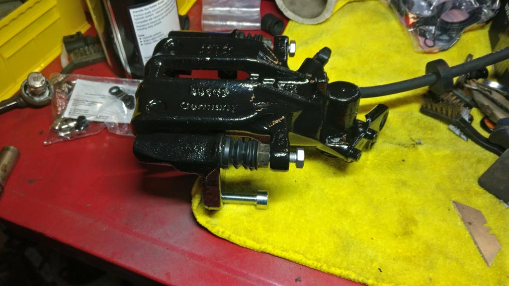

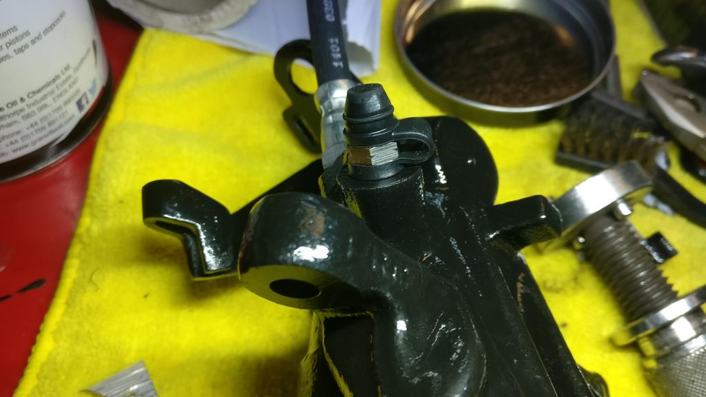

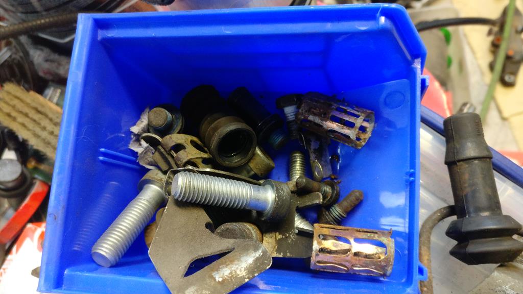

New seals and rear pistons from Bigg Red

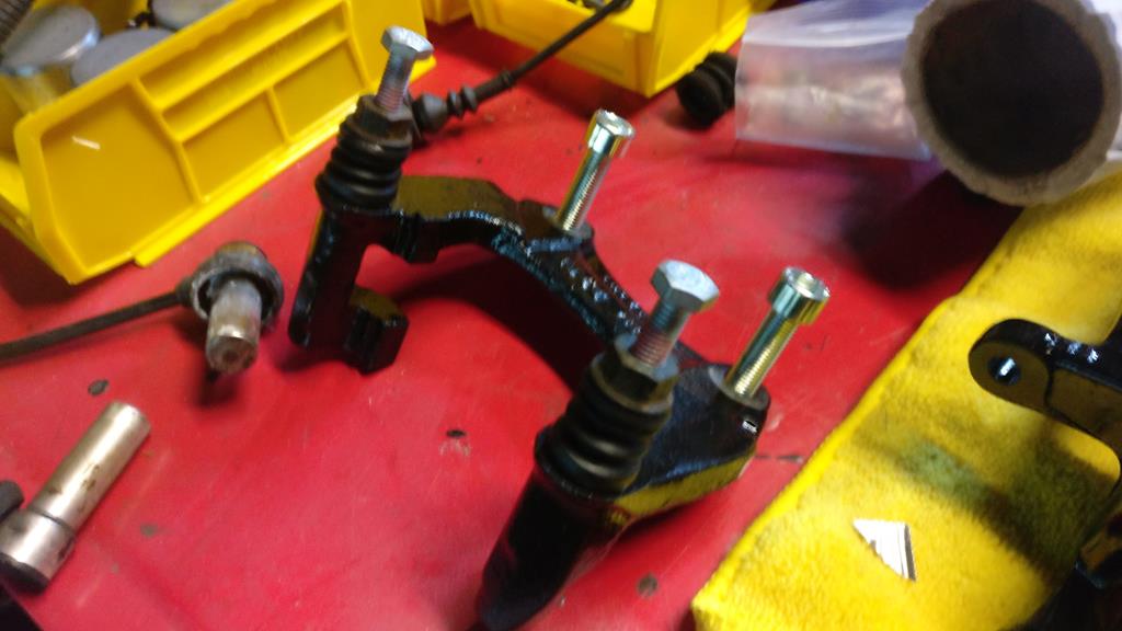

Carriers rebuilt with new boots and bolts

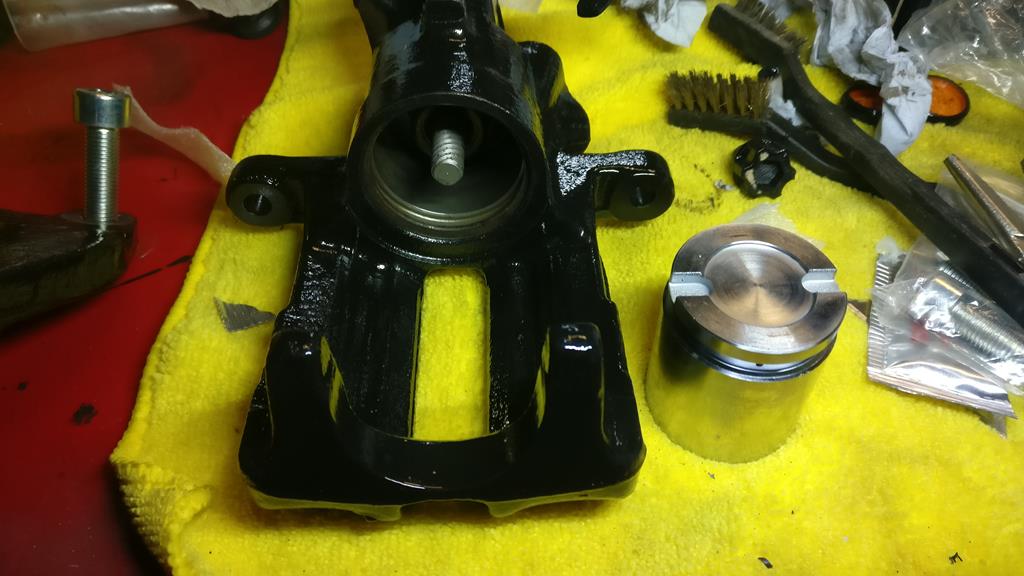

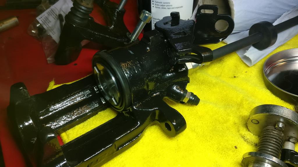

Rear caliper with a new piston
Back together
As these are steel calipers I can use stainless bleed screws, and also genuine Brembo cover caps for added longevity
Complete with new hose
Front caliper
Pistons and slider boots back in. I forgot to get a pic of it complete.

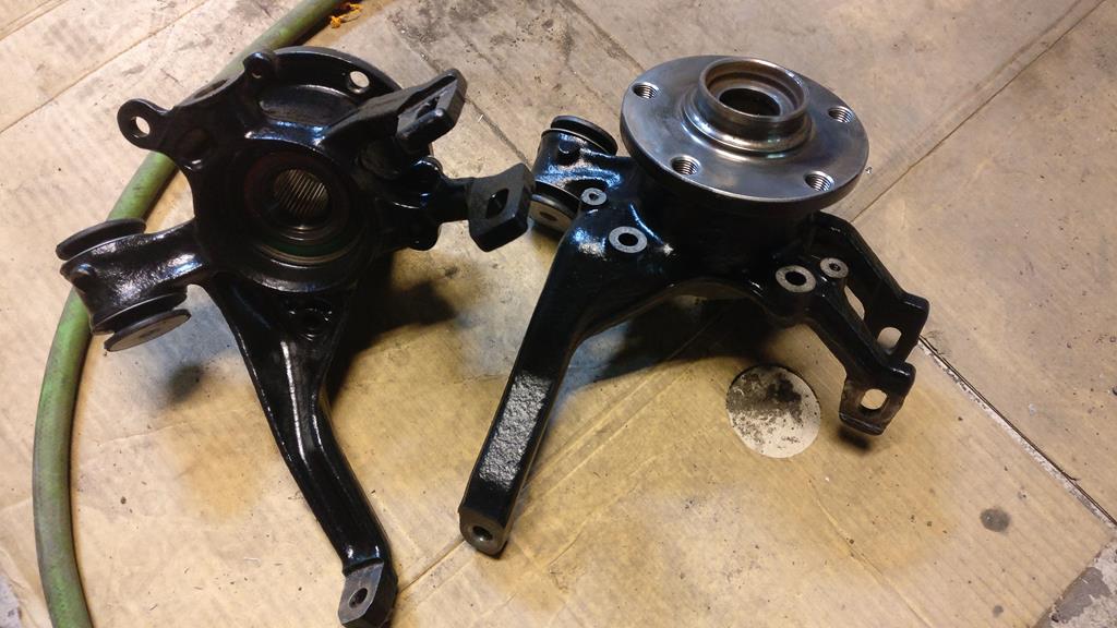

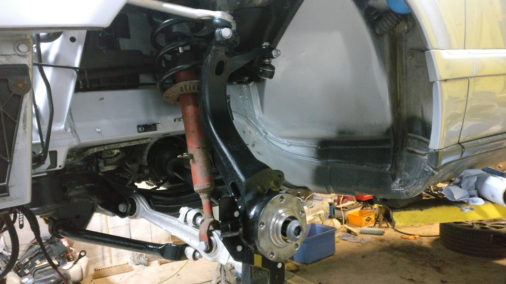

Rear hubs are looking considerably nicer, and have new bushes fitted
Front hubs back on the car
A tool for every occasion. Just how many A8 specific tools have you made over the years?

Enough to have a 'special tools' drawer in the toolbox

Painted uprights
The shocks getting a little paint as well?
Paul
Gosport UK

Why are the rear caliper pistons push things threaded? This gave me an idea to install autohold from D3 now
  #108
Old 8th November 2022, 04:33 PM
Painted uprights
They are making me sad for sure. I may just put new ones on it.
  #109
Old 8th November 2022, 04:36 PM
Its part of the handbrake mechanism. The lever pushes the threaded rod forwards which provides the clamping force, but the thread allows the piston to move hydraulically too and more importantly adjust itself as the pads wear.
I looked in to fitting D3 calipers to get larger rear brakes without the shenanigans of LWB handbrake cables, but I'm suitably convinced the electric calipers are more trouble than they are worth.
