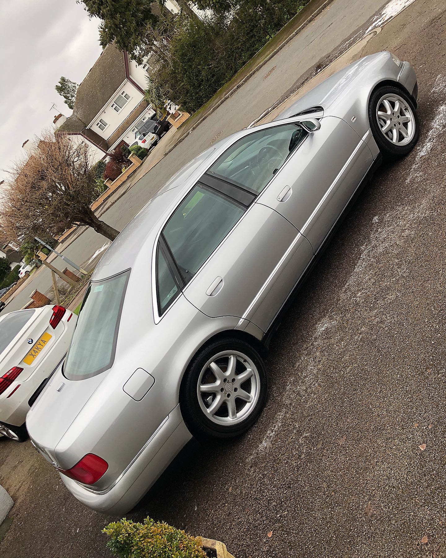

The blue one is my current daily
The R32 is my baby in the garage
The silver D2 is my old 2.8 PF
