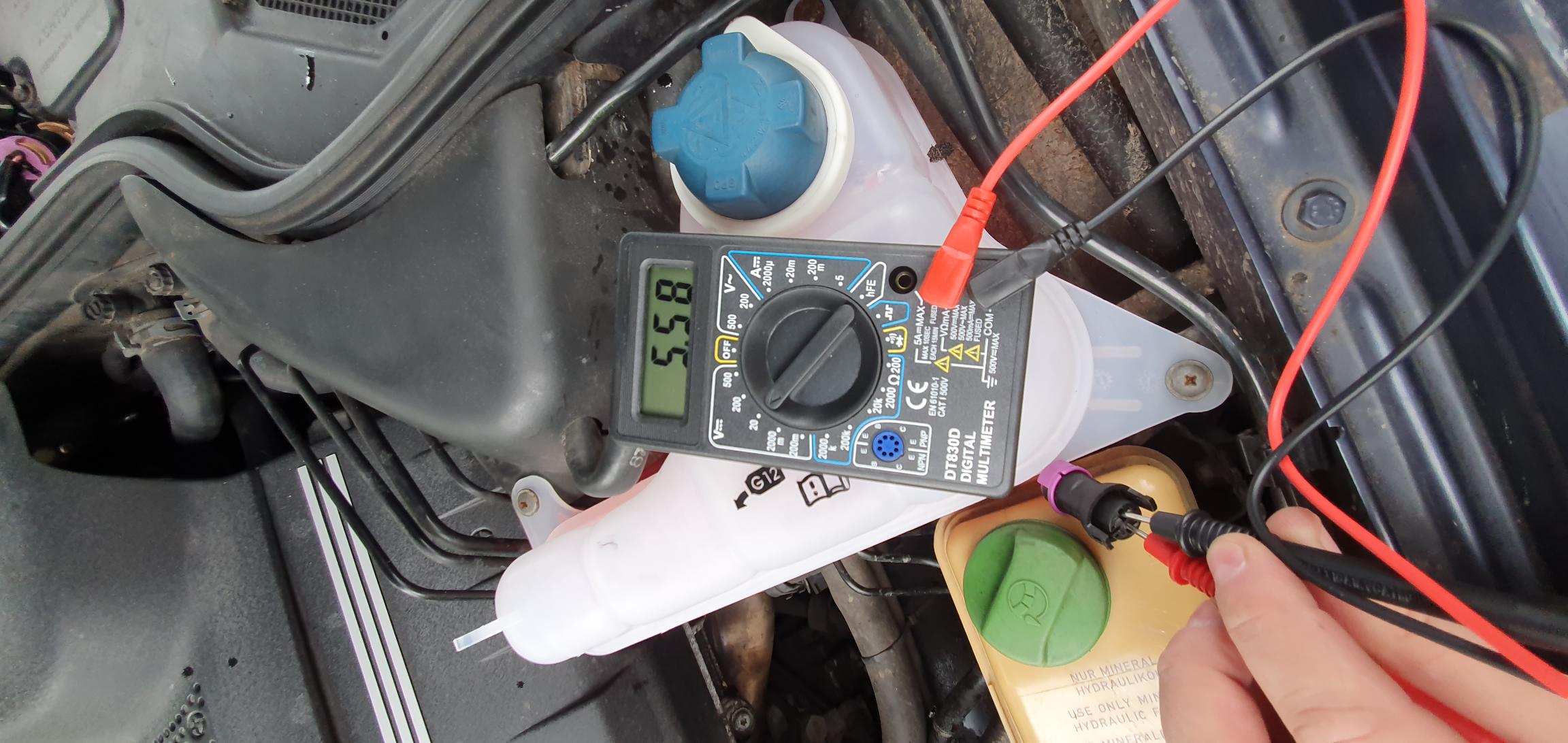

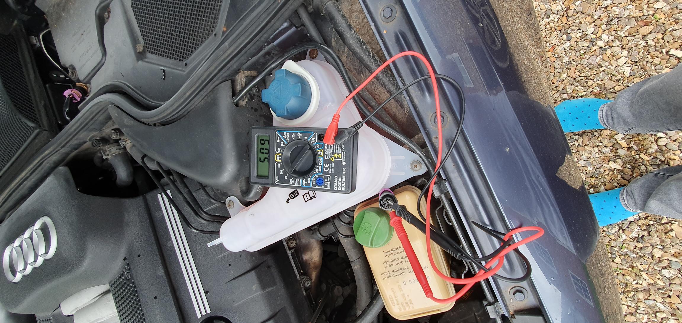

Yes i tried that - had same outcome: warning after 10 seconds of engine running.
I used a multimeter on the sensor today and have consistently been showing between 5 and 7 volts.
Problem is:
a) I have no idea whether I'm using the multimeter correctly
b) I have no idea whether this current is what it should be on the circuit
So basically I have data and no clue what it means
Any help greatly appreciated

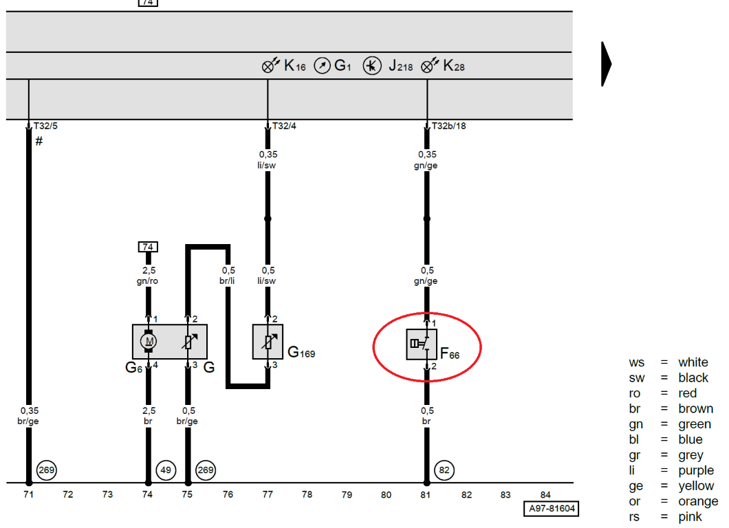

In terms of the wiring, going by the following PDF from the D2 Tech Dump post, page 8 shows the 'coolant level switch' (F66). It has two wires, a brown one which goes to Earth, and a green with yellow stripe wire going to the instrument panel. It is T32b, the grey block connector, and it's pin 18.
To test continuity, switch your multimeter to 20k Ohms (around the 8:00 position). The display should read 1. Touching both probes together should give you 0. Testing the brown wire should just be a case of putting one probe on that wire, and the other probe to a good earth connection. If the wire is fine, it should read 0. Testing the green/yellow wire involves touching both ends of the wire with the probes (and hopefully getting a 0 reading), but will need the use of an additional length of wire. Just make sure the additional length is fine beforehand. Can't think of an easier way with the second wire.

Name:	Screenshot 2023-09-28 172628 (Medium).png

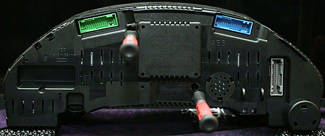

For a continuity check of the wire, you need to have a probe at either end, as it's measuring the resistance between the probes. One end will be at the coolant tank where the connector is located (your photo posted earlier) and the other end will be at back of the instrument cluster (wires attached to grey block in following image).
In terms of a wire coming out, I would tend to think it wouldn't happen at the instrument cluster end, but there could be a possibility that the connector at the coolant tank end might be further back in the connector than it should be. i.e. whilst being connected, one of the pins was pushed further back, so not making a connection. However, having said that, it doesn't explain how it happened in the first place.

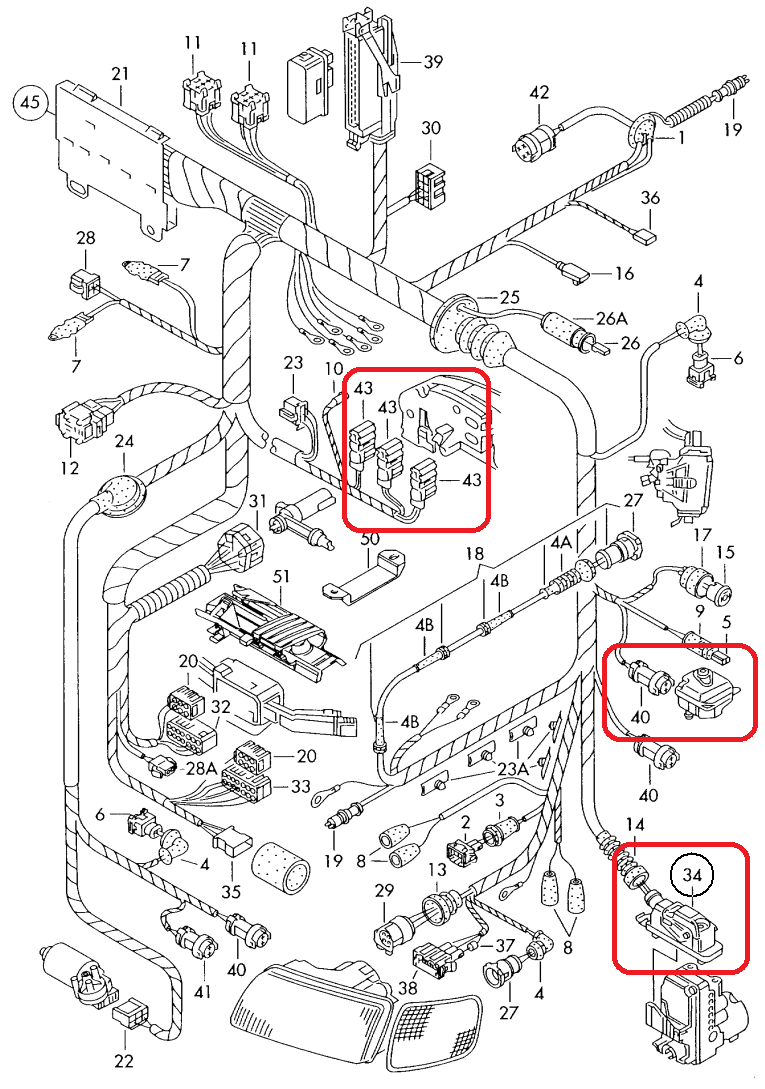

Not that this helps, but here's one part of the wiring loom for the dash/engine bay, that includes the instrument cluster (43), Coolant level (40) and ABS (34) connectors:
Name:	Screenshot 2023-10-02 101428.png
