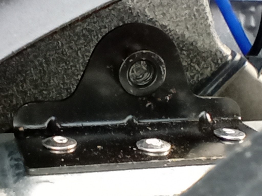

From a personal standpoint, and finally replacing the radiator five years after asking the question, my experience was somewhat different. I had the entire front end off the car, so can only comment on radiator fitment. I purchased a budget priced one, and the only fitting issue I experienced was the threaded stud used to hold the piece of plastic trim at the top of the radiator. I documented it all in the following post, but it's very long with lots of photos, but it's the black threaded stud in this photo:

iirc its fairly random whether that threaded bung is pointed the right way or not. When I get a backwards one I just drill it out and fit a rivnut.
I've had reasonable quality and success with NRF aircon parts, and their D2 rad is about mid-priced. The pic in this ebay listing does have the threaded doodad in the right direction I think.

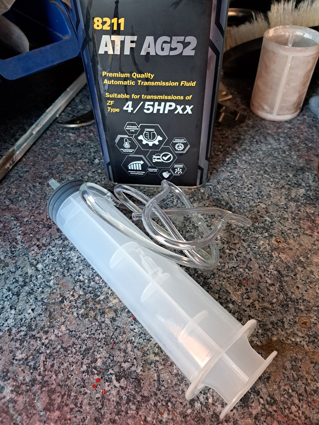

Well, all done. Budget radiator in and all seems good. Had an issue where the ATF connections didn't appear to seat properly but a quick message to MJ confirmed all is well.
The ATF loss, not sure about 200ml but stuck 200ml back in just in case
One thing I did note was the ATF was pink coming out but the stuff I managed to buy was clear. Not an issue I am thinking

It was filled with red atf at some point in its past. I emptied as much as I could and refilled with AG52, but the pink dye will be persistent for some time.
