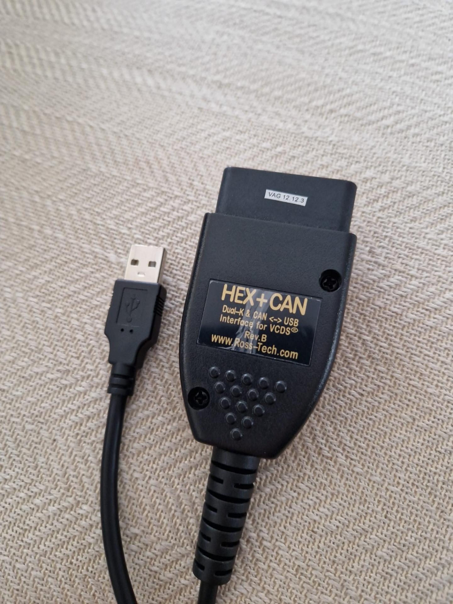

On the other side of the cable it just says 'VCDS 12.12' and has a status LED.
From what I remember it has the ability to connect to as many VIN numbers / vehicles as I like but won't work beyond version 12.12. Ultimately, I think it was a cloned cable but have a download link from a very helpful PM which looks promising.
I've also read on a couple of sites that the cable doesn't always work beyond 2015 cars, so we'll see if it works with this 65 plate TT!

That looks identical to mine, although mine was supplied by a verified company in the UK, and as such doesn't look genuine as it has their stickers on it, and not Ross-Tech. Mine is also unlimited VINs which I bought around 2013-2014, although the most recent vehicle I've scanned with it is 2011.
The Ross-Tech site itself lists that it works up to 2015, although it also states that it may also work on some newer models:
https://www.ross-tech.com/vag-com/ol...rfaces/huc.php
It's almost certainly a clone and will probably only work with the hacked software that came with it.
Genuine cables typically have a serial number label, a "sold by" label and NO software version label as they don't need a specific version.

The ross-tech sticker looks genuine - but could be faked - this link provides info on the interface and its limitations
Presume you've tried installing the current software version and it's not worked? There's a driver download link in the one above that might help.
I've got an old hex+can cable which works on my 2015 Golf, but didn't work on my neighbour's T-roc
ETA - the more I look at it, the more I think that's a clone. The other side of my cable says 'Genuine Ross-Tech', has a different 'pimple' arrangement, and has security screws rather than Philips

Oh it's definitely a cloned cable. I bought it from a certain disgraced ex-forum member for £30 if I remember correctly, as did a few others. It came with a 12.12 installation mini disc which annoyingly I can't find, but it used to be fine for doing the odd adaption on my S8s.
Tried with the latest version but it doesn't like it.
