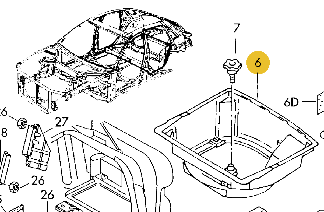

Is it just the spare wheel well? i.e. are the two spaces where the battery and amplifier go on either side dry? Is it possible that there is a crack/hole in the spare wheel housing? Also, considering it just seems to be glued in place, maybe some of that has deteriorated. Is it time to put your son in the boot again, and then turn the hose straight up at the bottom of the car?
