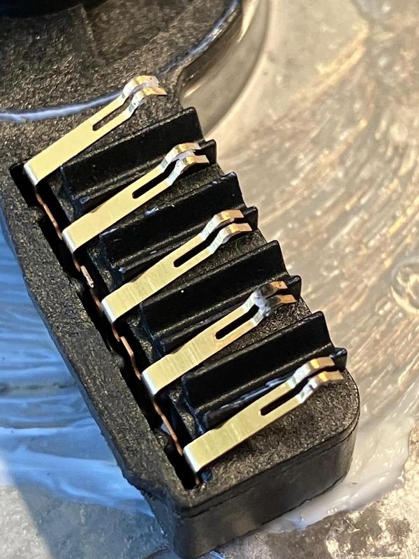

Looking at the insides of the F125 it's track 3 that's relevant and there's a thin section of it between N and 4/S so I think that contact must be damaged
And indeed it is!
That fourth contact is for Track#3 and looks burnt or contaminated. No obvious marks on the track though.

Also cleaned up the contacts:
Just need to get some suitable bolts to fix it back together and I'll have a genuine spare.

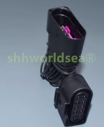

You can buy a 10-wire VAG extension cable on AliExpress for about a fiver delivered!
See: https://www.aliexpress.com/item/1005004719243387.html
Might just get one as insurance against short F125 cables.
Edit: Ordered one anyway, nearer £7 with VAT added. I'll test it thoroughly.
