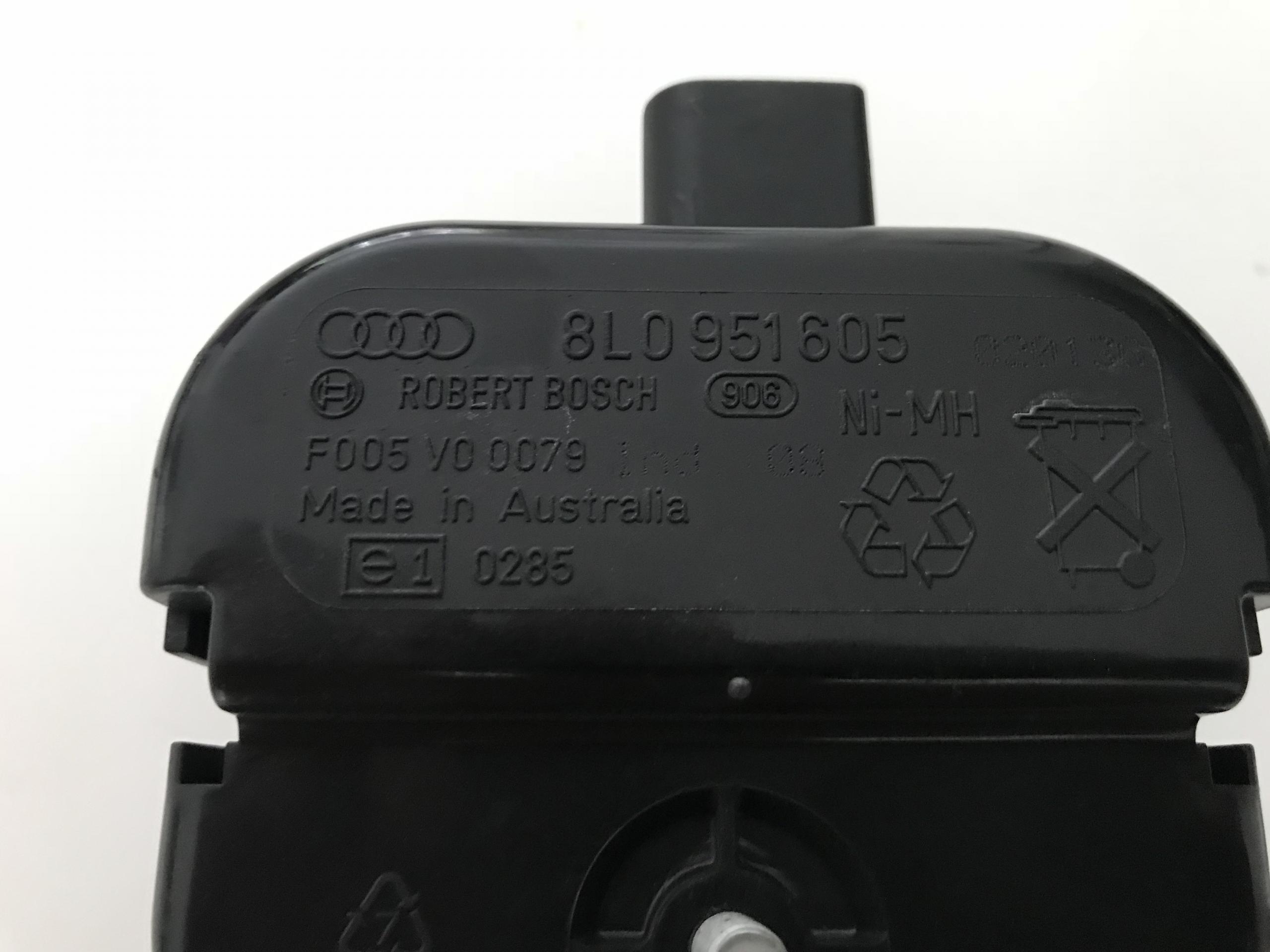

I used this guide to finally extract my unit - mine hasn’t worked since getting the car 2+ years ago.
All was well until I looked at the unit which is completely different. Do you think someone has replaced it with another models unit in the past or did 8’s come with these at some point?
The connections appear to be the same and the part number on eBay pulls up a handful of used units although not from out forum sponsors. Do I get the same as what I removed or go for one like Sean’s box shaped like unit instead?

Sean's from the first post is actually the later unit which was supposed to be more reliable. I'd go for the later flat one since most of the early cube-shaped modules seem to be kaput by now.

Was there a specific part number for the later ones?
All the ones I’m seeing on eBay appear to have a rectangular connector but mine is rounded at one end as shown in Sean’s second to last picture.

The one I got was from a '05 A4 and had the 3-pin rounded connector. The part number is 8L0951605A, which is identical to the part number for a '02 A8, although as MJ mentioned, the later ones are slimmer. There are a few listed on eBay for around the £30 mark.

Ah yes, I see what you mean now! Thanks pal
