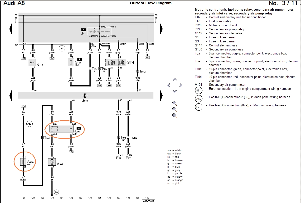

I think I found it, should be fuse S130, a 50A fuse. I cant work out where its supposed to be in the drivers footwell on the side, or in one of the other fuse boxes. Maybe I'm being thick I cant find a fuse diagram in ElsaWin, surely there should be one?
Relay should be no. 4 in the passaenger footwell?
Will try and find fuse and/or relay
can i pull the relay and not the fuse?
Old 5th January 2015, 12:47 AM
Pulling the relay will do no harm, might throw an error but you won't damage anything.
