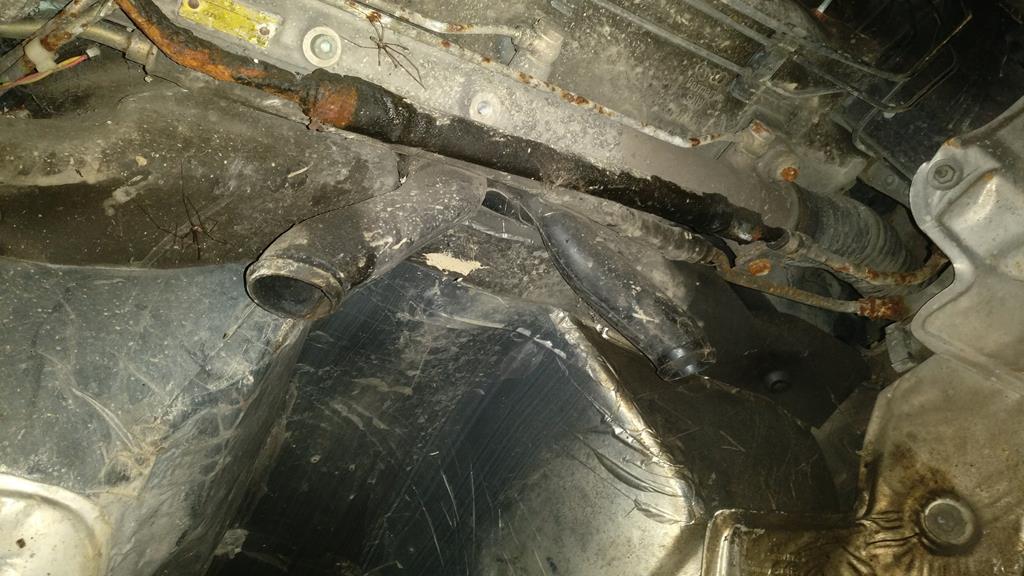

The drivetrain has been out before, and someone has treated the cowl drains to a rather unusual modification. Ironically, the bottom of the drain isn't actually the problem here - the leaves and detritus collect in the top of it, not the bottom.

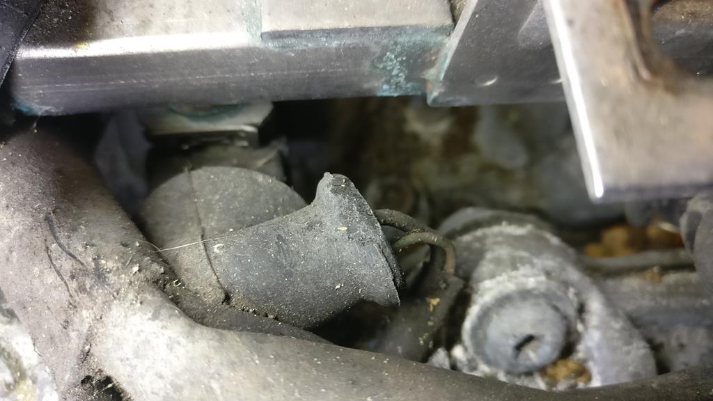

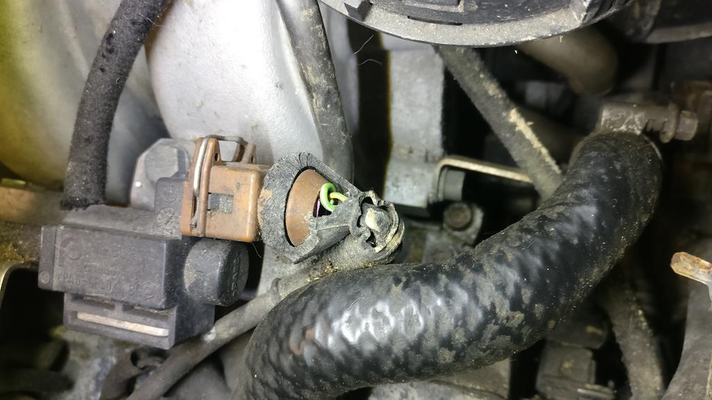

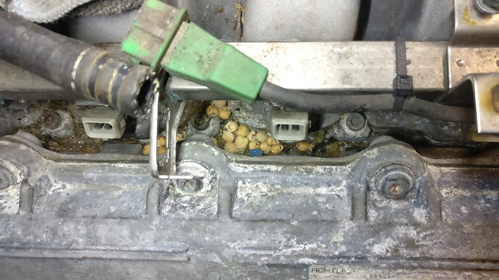

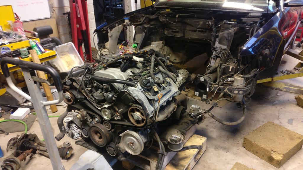

Now the engine is out I can get a better look at things. The mouse or squirrel has been quite busy
Nibbled:
Nibbled:
Nibbled:
Nibbled:
Nibbled:
Nibbled:
I'm going to replace the engine wiring harness I think. The nibbling appears to just be limited to connector boots, which could be replaced, but given all the electronic shenanigans I've already been through I'm not going to risk any problems in the future. Since the engine is out and the harness will be coming off it anyway, and I have a spare on the shelf, at this point it's foolish not to replace it.

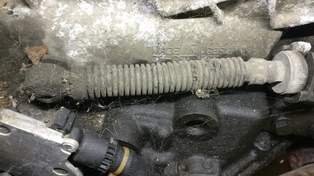

That's some hungry, nibbling mouse. And why does it have a liking for the connectors? does it have some flavouring? Liquorice?
Old 25th September 2020, 08:54 PM
Its interesting isn't it? Only rubber boots on connectors and the shifter, not hoses or cables. It also shredded a portion of the under-bonnet sound deadening pad right on top of the inlet manifold, which it took somewhere for nesting material I think as there is a trail of it down the right side of the engine. The rubber nibblings were probably used for the same thing. Apparently fuel hoses aren't as interesting to mice, which is a bonus! Vera's S8 got nibbled by a pine marten last year and that chewed through the fuel hoses as well as some wiring.

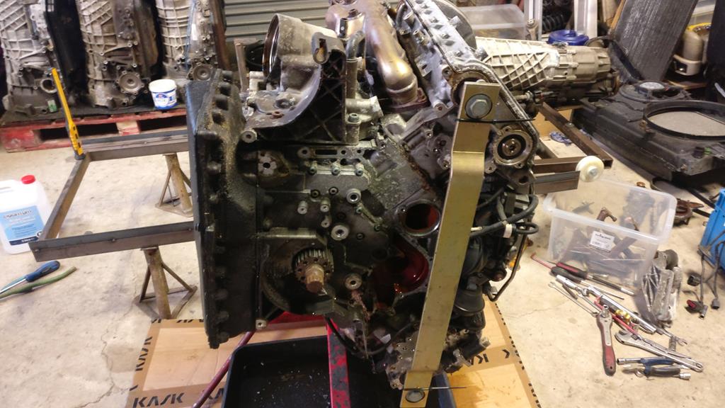

Engine dismantling and inspecting today. Someone's larder here, plus some of the bonnet sound deadening!
Some really odd bolts are rusty in this one. This is one of the starter bolts - I can't just force this out as it'll gall up in the hole and damage the gearbox casing so I cut the visible end off with the grinder then it came out cleanly. I'll replace this with a spare.

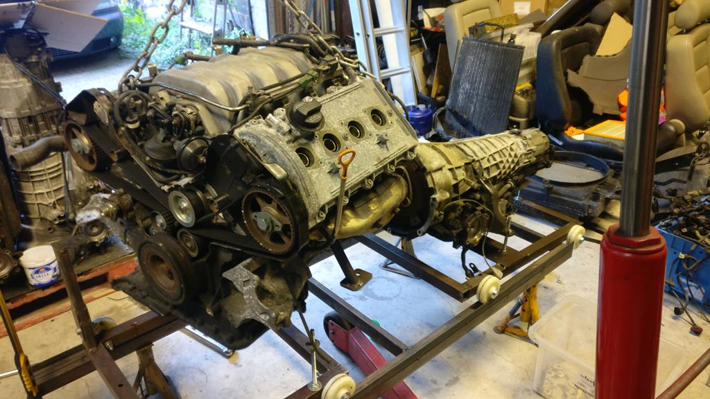

I forgot to get pics of splitting the engine and box, but you've all seen that plenty of times before Here's the engine about to go on the stand:

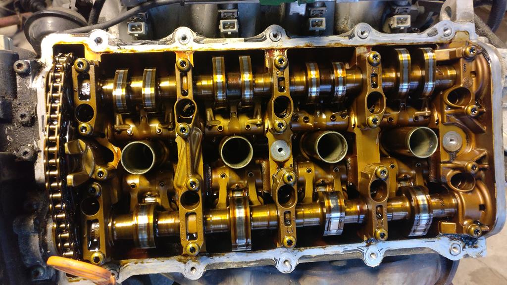

I pulled the cam covers to inspect the tensioners and pads and was pleasantly surprised by what I found. No sludge, and both tensioners are still working fine which is great news. I'll replace the plastic pads and remove the gauze filter which is what kills the tensioners in the first place.

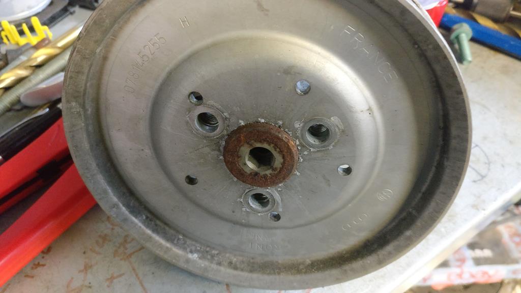

Got a bit of an experiment going on while I watch the F1 today. The V8 has a problem with the power steering pump pulley seizing to the pump hub due to mixed-metal corrosion between the aluminium pulley and the steel hub. Both parts have surface treatments to prevent this, but after 20 years weathering and moisture coming through the radiator have done their thing and the pulley can only be removed by sufficient force to destroy it.
Interestingly, the V6 with the same pulley doesn't have the problem as the pump is up in the V and out of the way of moisture and crud, so I tend to keep pulleys from the V6 on the shelf to fit to V8s.
So, today's experiment - soak the hub in Evapo-rust to see if it can free it up:
The corrosion is usually a combination of aluminium oxide from the pulley and iron oxide from the hub. I'm hoping the Evapo-rust will eat enough of the rust to allow the pulley to come free. We shall see in a few hours

Well, the experiment didn't work The pump hub is nice and clean now, but the pulley is still suck fast. Oh well. I can get the pump off and on with the pulley on it so no big deal.

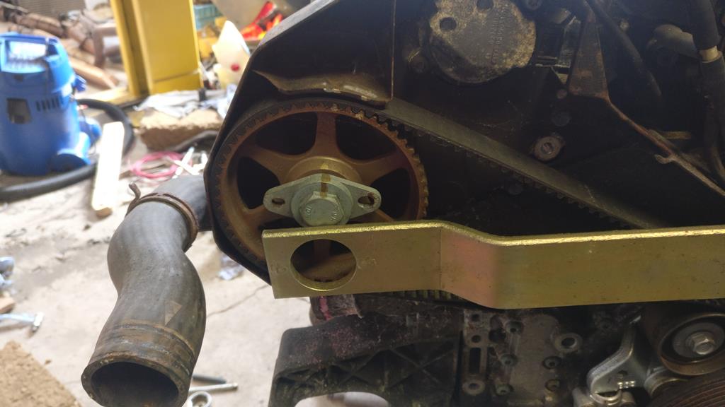

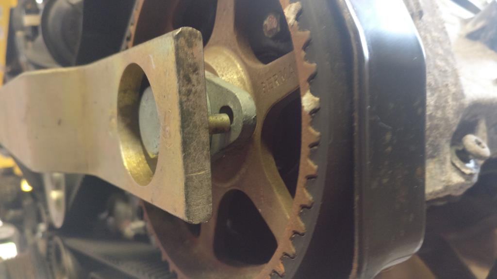

I started stripping the engine today. This is what happens when people bodge the timing belt without using the tools
This is with the crank locked. Bank 1 is fine, but bank 2 is a couple of degrees early.

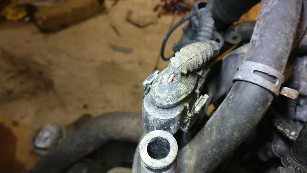

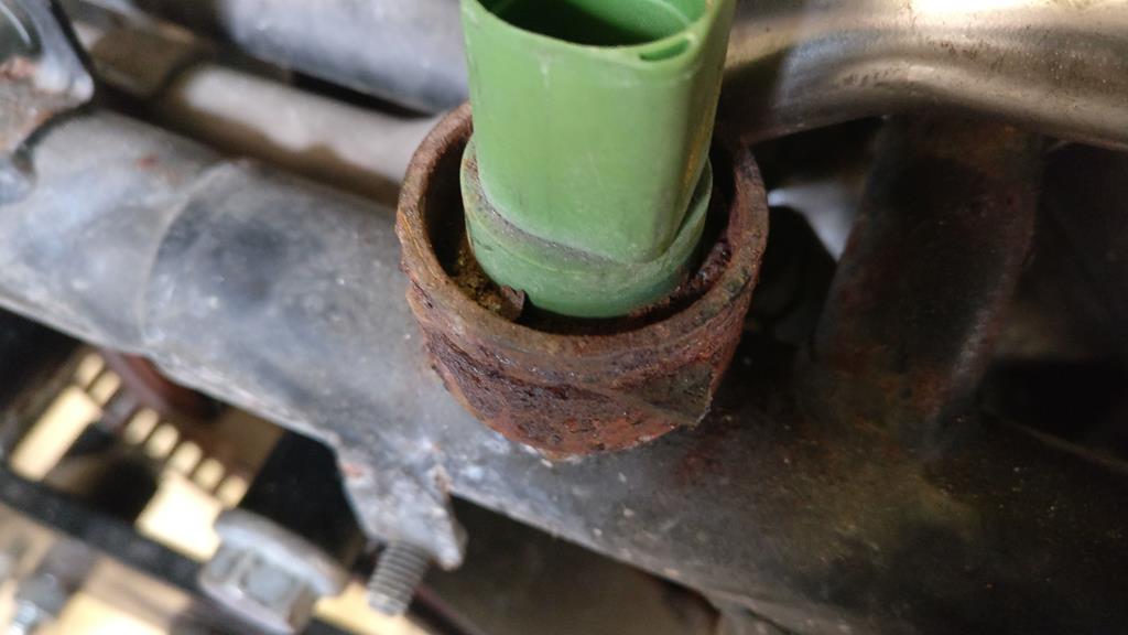

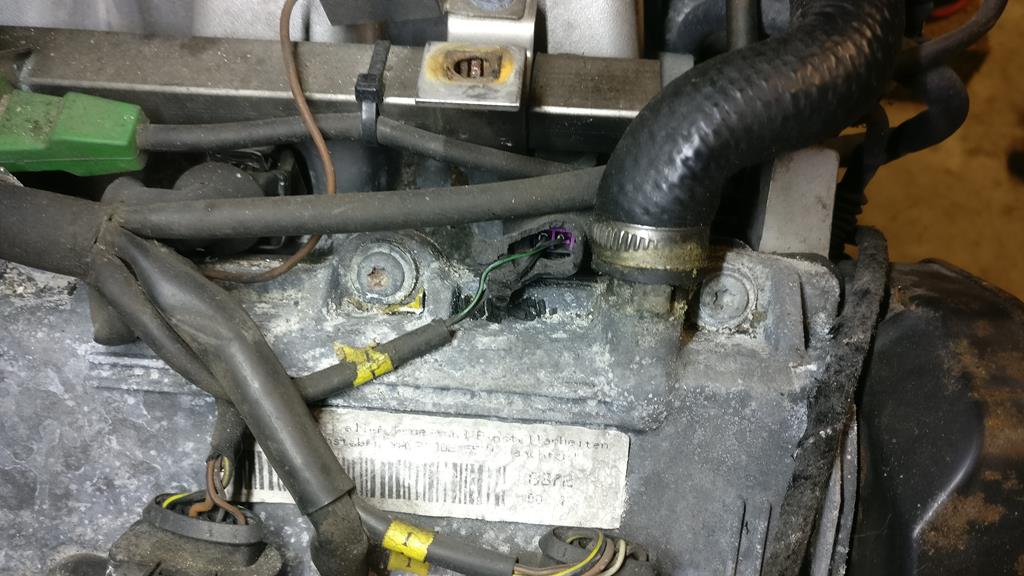

I replace the temperature sender whenever I have an engine out, since it's a pretty horrid job with the engine in the car and full of coolant. £10 now saves a couple of hours of swearing later down the line when it fails!
This one was a tad crusty:

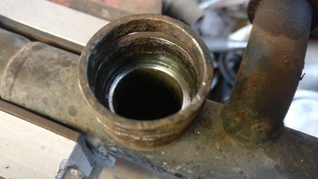

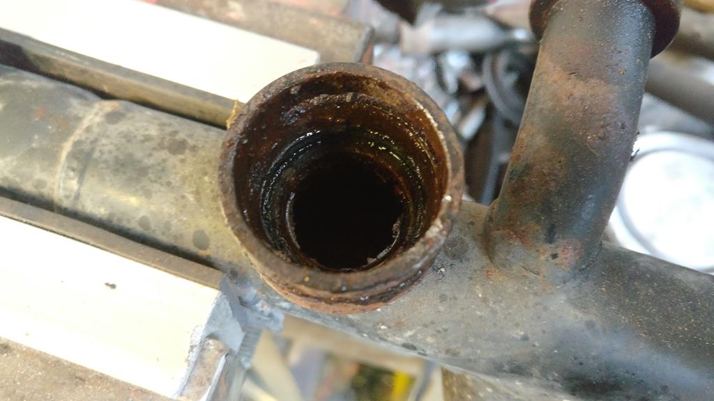

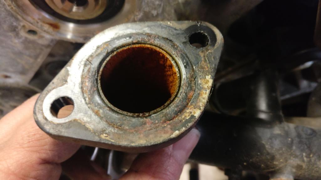

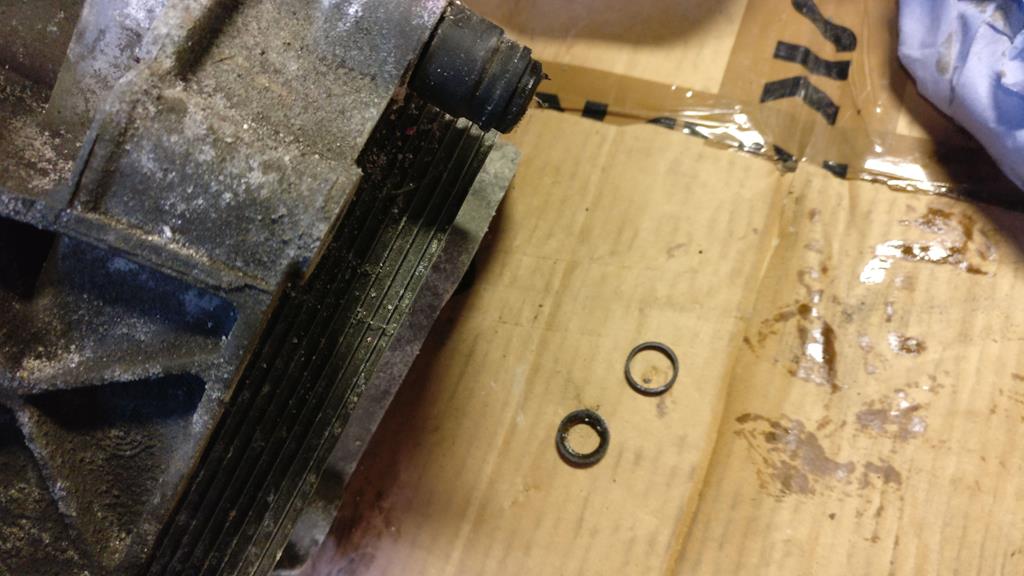

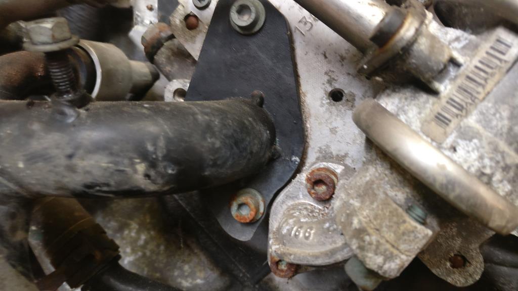

While I was poking around at the back, my spidey sense was tingling looking at these two coolant unions. They're not leaking, but one has a bit of salt deposit, and the other has what appears to be a damp spot...
The o-rings are toast:
These joints were just waiting to fail as soon as it got up to temperature so glad I spotted it now while its simple to deal with. This is another truly heinous job with the engine in the car, made extra difficult by the SAI valves in the way.

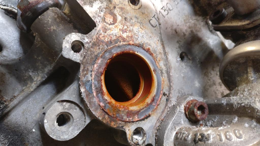

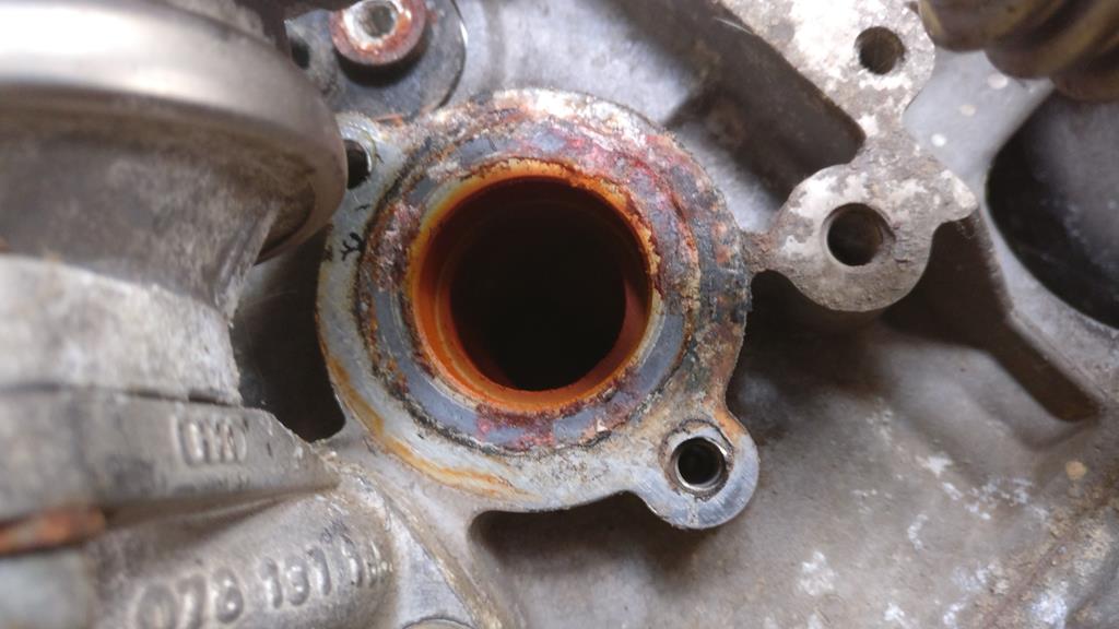

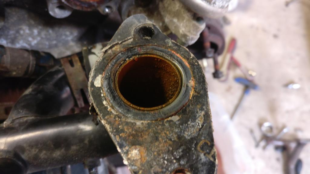

The orange colour in the water ways is rust from inside the few steel pipes in the cooling system. The timing belt was last done in 2010 (only 5000 miles ago!) and apparently hasn't had coolant since then so its rust inhibiting properties had expired long before it was parked for three years, although the coolant which came out was fairly clean. I'll run a full coolant flush procedure on this once it's back together to get all the rust and contaminants out.

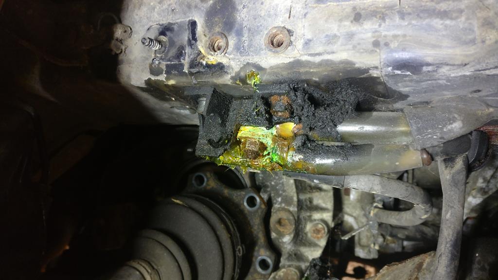

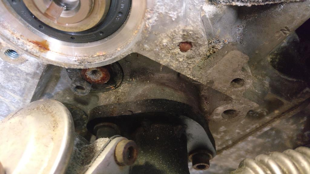

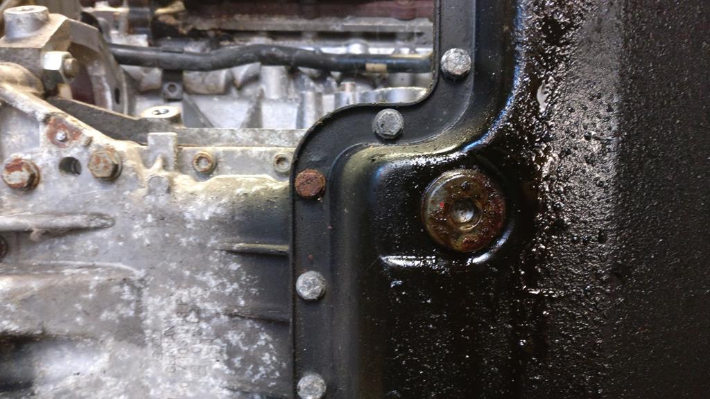

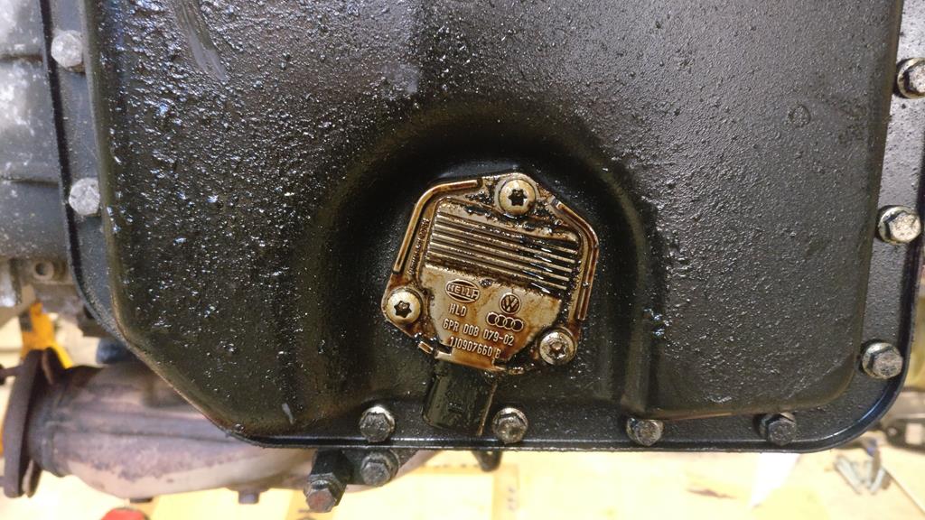

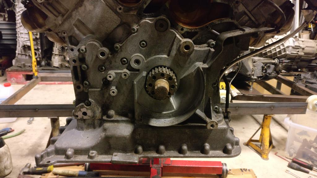

The engine has a fairly catastrophic oil leak from the bottom which appeared to be concentrated around the oil level sensor rather than the sump itself.
On investigation, it appears someone has replaced this sensor but didn't put sealant on the bolts so the oil was just travelling down the threads.
One single bolt on the sump is rusty
I pulled the sump anyway and there were a couple of points where the sealant was beginning to fail so I'll flip the engine over to replace that.

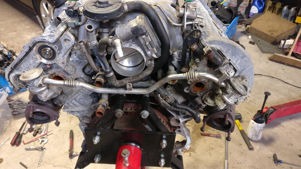

The inlet manifold will come off tomorrow so I can replace the valley pan gasket which is leaking as usual.
