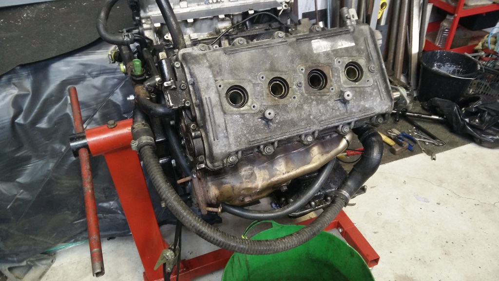

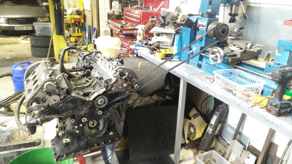

So was this what we had in mind?
I wanted to get it to suck up water from a bucket but realised it would never do that with a vent at the top so put the header tank on it and joined the inlet and outlet together. I'll fill it with water and see if I can see any evidence of it moving it around...

Old 18th January 2019, 03:10 PM
It actually works!

Old 18th January 2019, 04:02 PM
Haha There's a vid on my FB page. I'll upload it to Youtube later

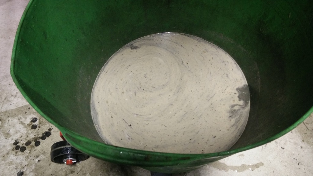

Old 18th January 2019, 05:35 PM
Rinsed it through a few times to get rid of the chunks, then started the cleaning process.
Before:
After:
D2 Doctor Approved
This is cute:
The engine was at 2°C last night when I stuck the tape over the ports. Its warm to the touch now after I've been filling it from the kettle, and the air trapped in the ports has warmed up so much it's making the tape bulge

Old 18th January 2019, 07:21 PM
275K to about 320K the air is going to expand significantly, around 15%.
  #30
Old 18th January 2019, 07:35 PM
It shows the valves are sealing properly, which is nice
