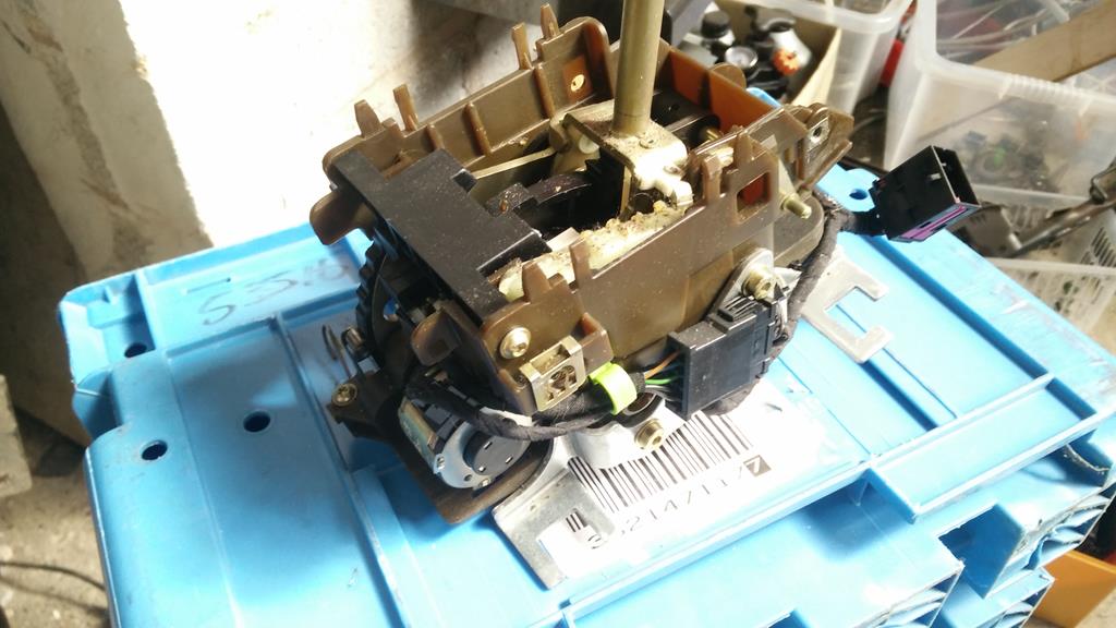

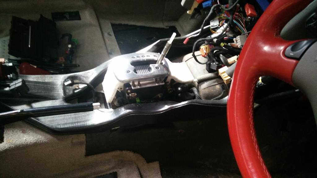

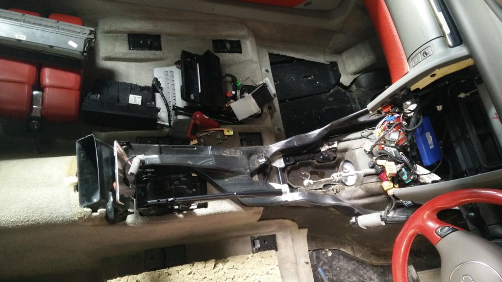

It was a little more than that Stephen had commented that occasionally the shifter would get stuck, and on investigation I discovered a fault code in the TCU for the V110 shifter interlock solenoid. Since I had a spare shifter I swapped it over. V110 is the silver cylinder on the bottom left of the shifter here.
Old shifter removed - this is how much stuff you have to remove to get to it
Replacement fitted

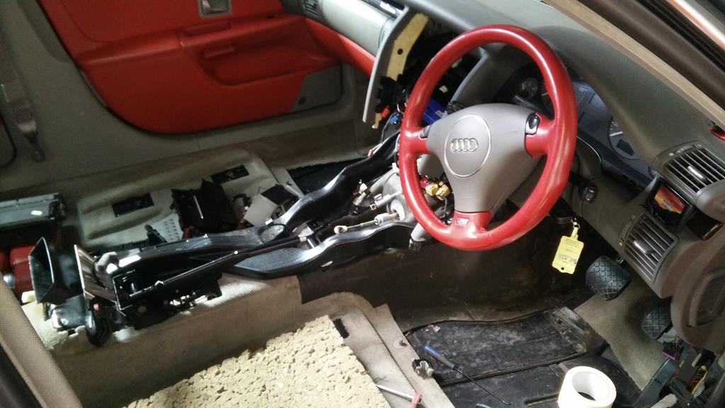

I forgot to take any more pics of putting the rest of the interior in. Stephen's and Jim's had to play bunk beds for a night until Stephen's went home! Since Stephen's had just had all its leaks fixed, it got top bunk
Who's sleeping in my bed?

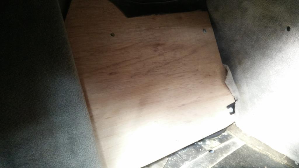

The last step - a new relay box cover made from marine ply. I wanted to infuse this with polyester resin to make it completely waterproof but I ran out of time. I'll do that next time.

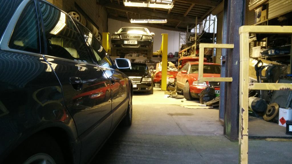

A brace of beautiful black Final Editions basking in the sunshine Stephen's waiting to be picked up, Jim's waiting to come in.

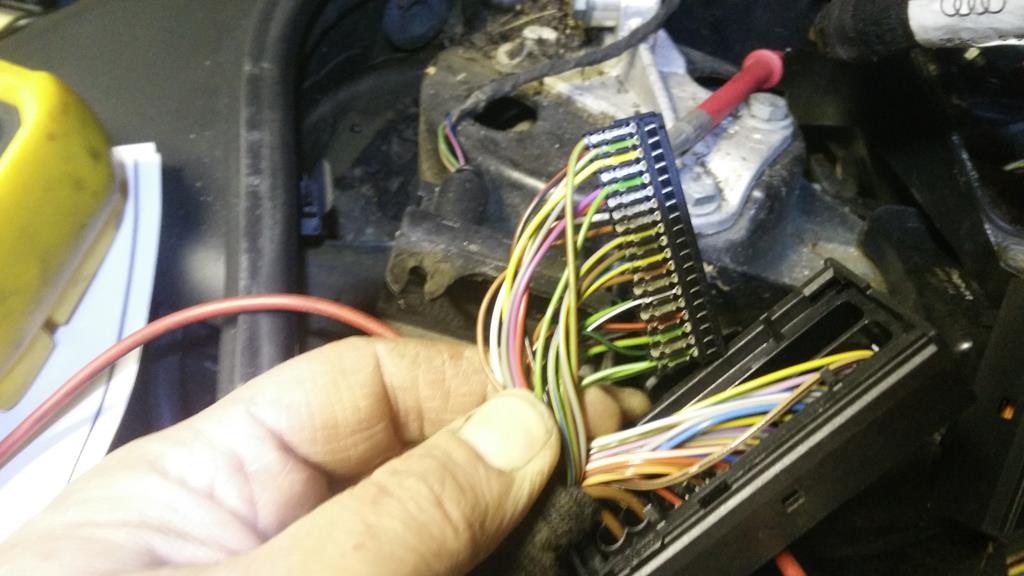

Next job - find out why the ECU won't communicate with VCDS. No continuity between the body harness and ecu connector...
I am having the said same issue with my VCDS Lite. Actually with my cheapo reader as well. The cheapo says linking error, VCDS unable to connect. Did you go direct to the ECU or are there prior items to check? I have checked the terminals at the OBD2 port and all seems good, used a breakout box and the resistance between terminals also seems to check out.
Paul
Gosport UK
________________________
Polestar 2 Long Range
Audi S8 2002 FE Avus Silver / Extended Red Leather. https://forum.a8parts.co.uk//showthread.php?t=16187
Honda Jazz
  #38
Old 6th March 2022, 07:07 PM
I checked continuity between the OBDII port and the ecu box connector, which was fine, and then from the ecu box connector to the ecu itself, which wasn't.
Do you have wiring diagrams? I know the diag pin on the ecu is #43 but I can't remember which plug it's on in the ecu box.
This seems similar to sticky selector I sometimes get, doesn't want to move easily out of Park
