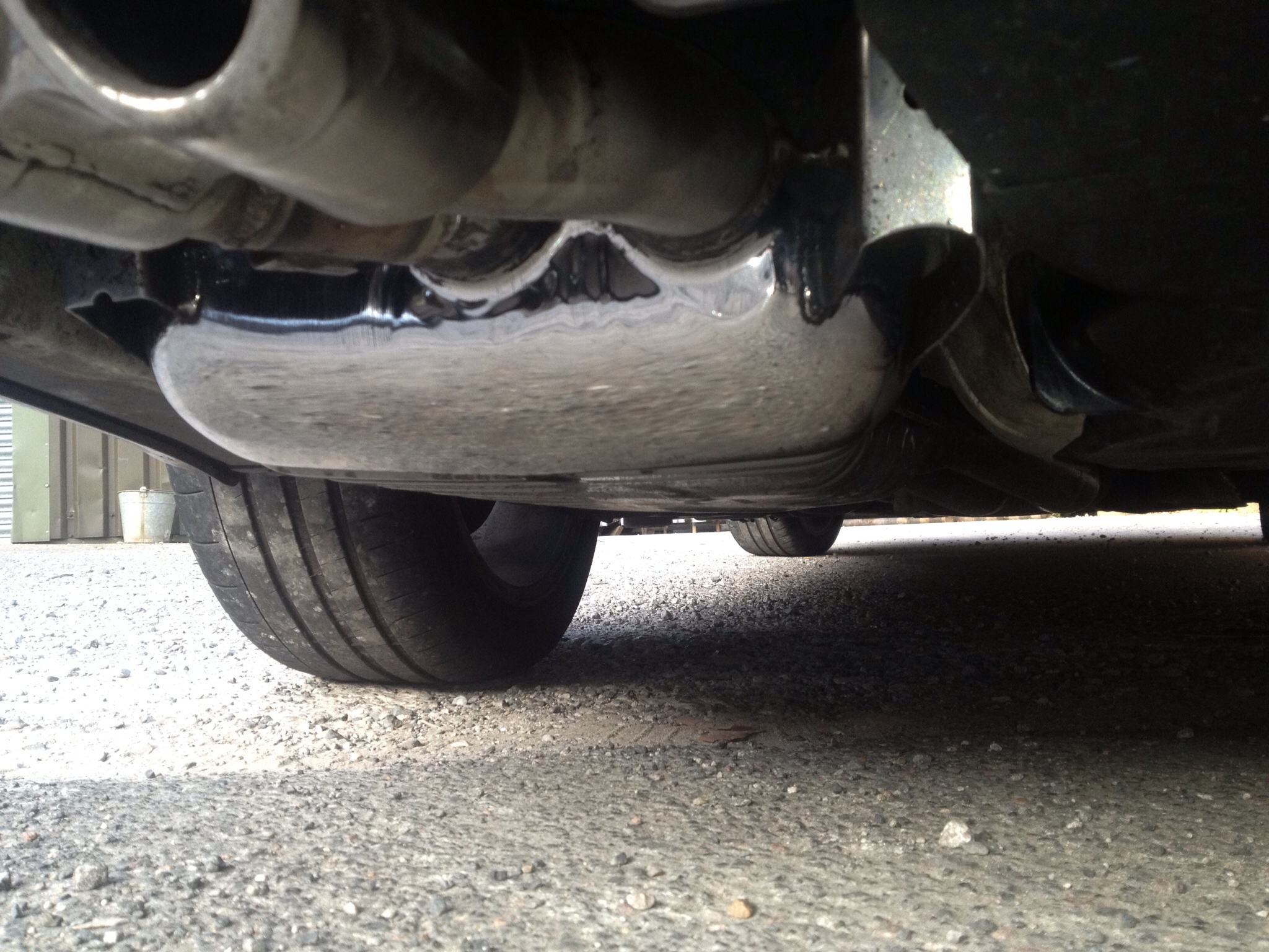

Hi I tried a couple of methods but below you'll find how I got the best results in this post 2 yrs ago...this is the method I'd recommend.
Oli
Hi,
With the recent refurbing of my wheels, i've been meaning to tackle the exhaust again. It was almost 3 years ago that i bought my S8 backbox from A8 Parts and although i got quite a good bit of traction when i cleaned it up, it still wasn't as good as i wanted it to be.
This weekend was the weekend to have another go and this time i used a few new toys...
Power drill
800 grit sandpaper on a wheel
Polishing mop with polishing soap bar (this stuff is amazing!)
Overall, quite pleased with the results and i've gotten the mirror finish that i've always wanted - although it did take about 2 1/2 hrs
Anyway, thought i'd share some of the results...
Oli
Before:
During (no pictures of polishing mop in use unfortunately):
After:

The exhaust seems to be full stainless the centre box is double skinned in a zintec or galvernised mild steel. The exhaust seem to be more damaged by heat the closer to the engine. Here is my 14 year old exhaust, the black paint of the rear box comes of very easy with cellulose thinners to reveal bright stainless.
Mmmm each bank has totally different path in the rear box ( very strange!) this may explain why each banks exhaust pipe has been affected by heat and corrosion differently.
