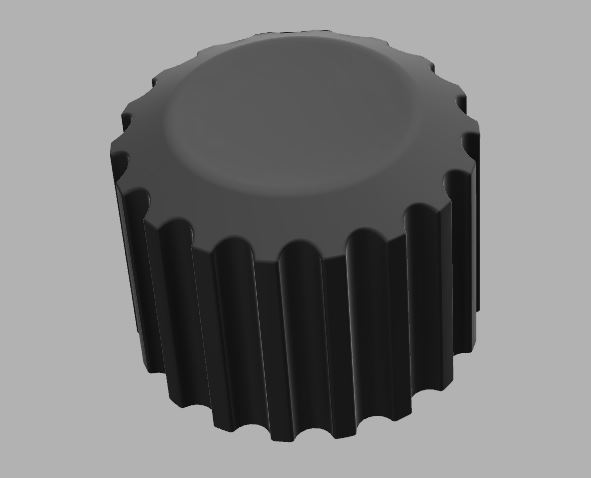

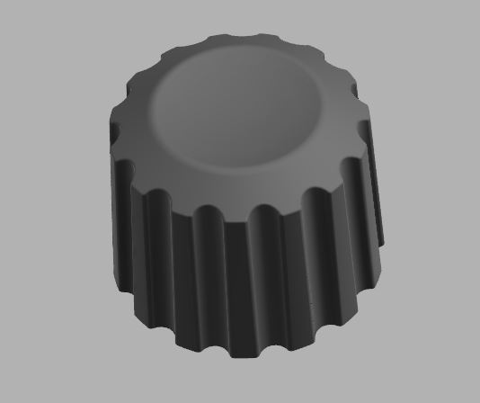

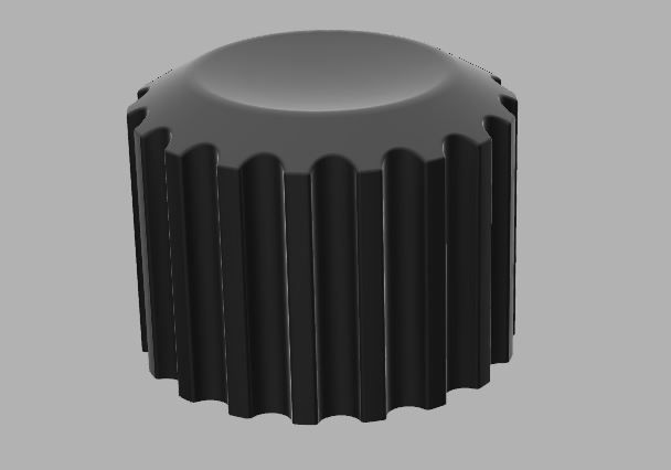

Didn't like the knopf so I made a new one.
I'm not near the car at the moment. Is the real one tapered slightly or parallel?

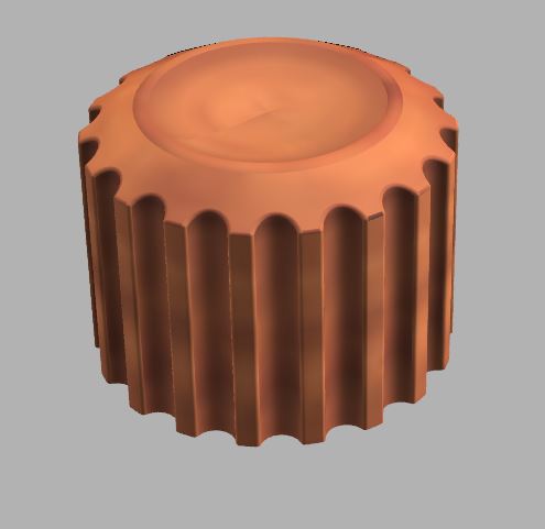

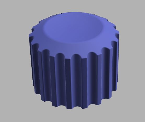

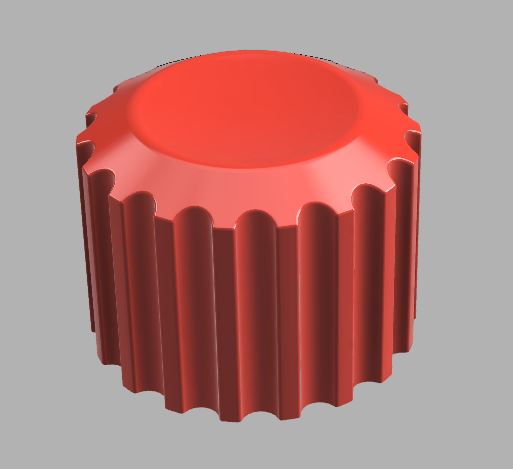

  #47
Old 29th November 2018, 06:46 PM
ID:	20497   Click image for larger version
ID:	20498   Click image for larger version

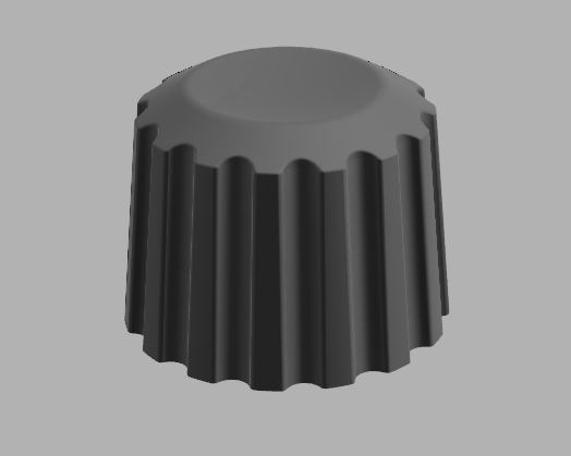

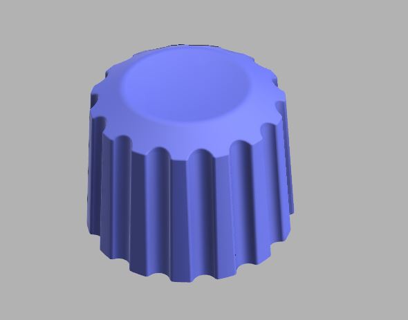

Made a tapered version which is slightly more asthetically pleasing:

Side note: this stuff is considerably more satisfying than my proper job
This model is solid underneath for maximum strength. The mounting hole is 6mm, exactlythe same diameter as the switch shaft. Two printed parts of 6mm ID and OD will lock together because of the layered nature of the process. I'll find out how printed vs moulded interact tomorrow when I get home and print one

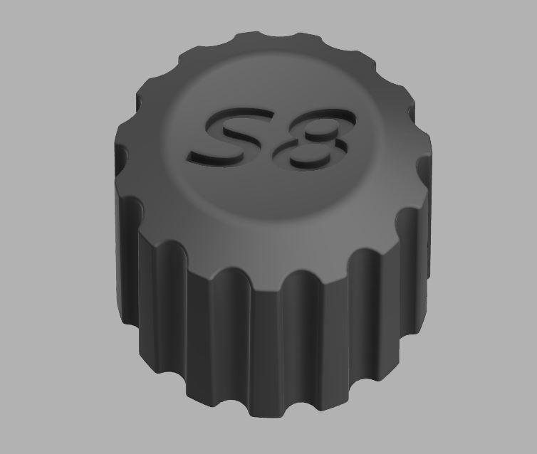

Too much?
