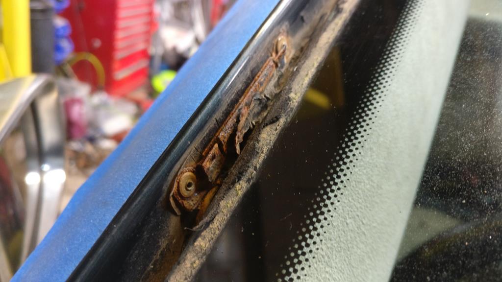

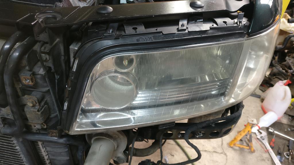

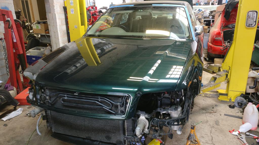

I removed the screen surround today ready for the new screen to be fitted tomorrow. As usual, several of the clips were rusty because of the butyl sealant the factory fitted at the base of the drain channel, seemingly deliberately to make the clips rust. These will be replaced once the glass is out.
Marcel came over to help so we put the bonnet back on - the colour match is very good.

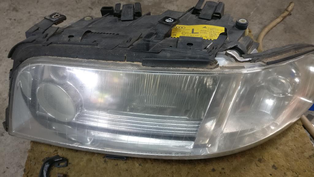

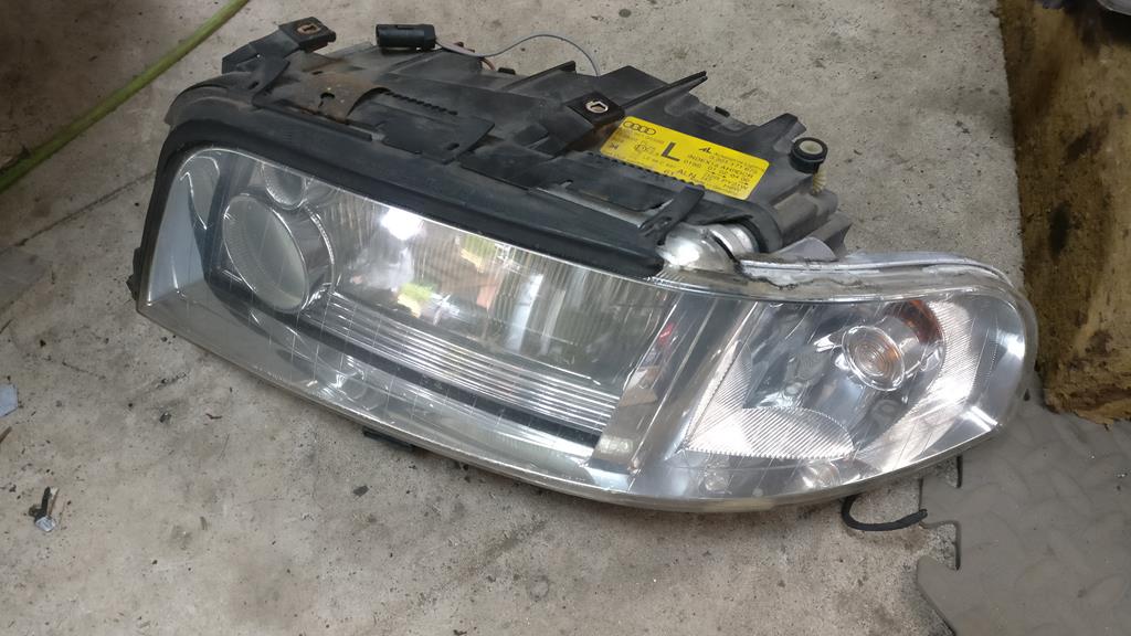

The headlight rubber trims have rotted away, so these were replaced with pieces from a donor set of lights which I'm using for parts
The corner trim is sold as part of the lens, but it can be removed easily enough
Good as new
One of the aluminium trims on the bumper was past recovery, but luckily I had one which was in usable condition and which polished up to a similar state as the other side
I forgot to take any pictures of the front end all back together, but the car is now back on its wheels ready for Autoglass tomorrow. I'll be putting the interior back in before they arrive, and hopefully polishing up the rest of the brightwork before taking it to Nicola's

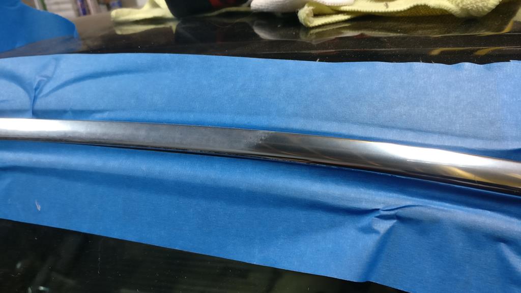

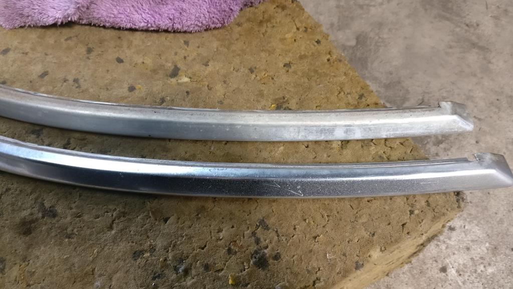

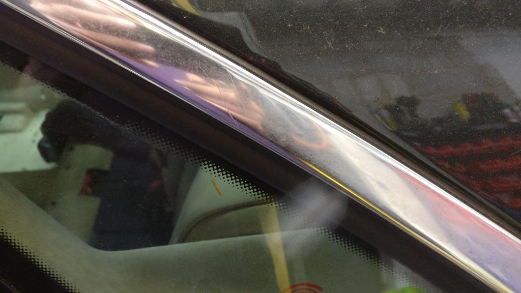

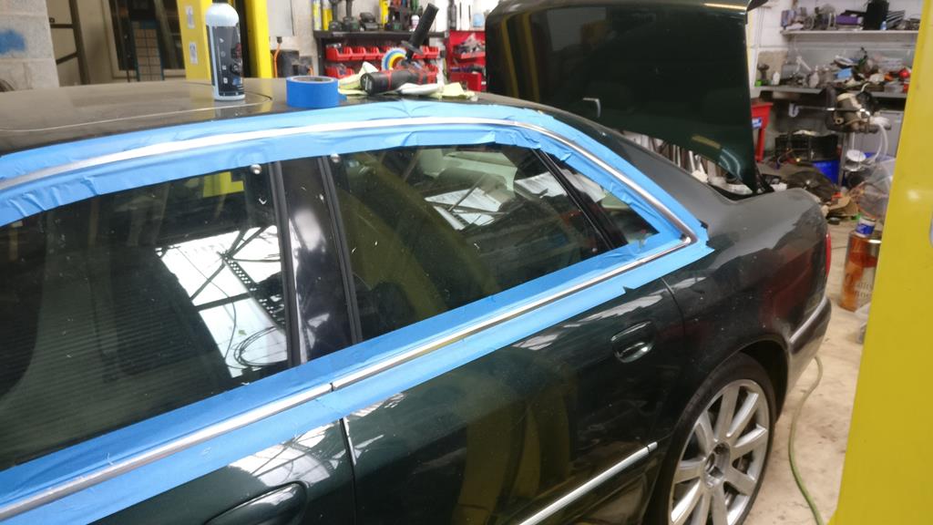

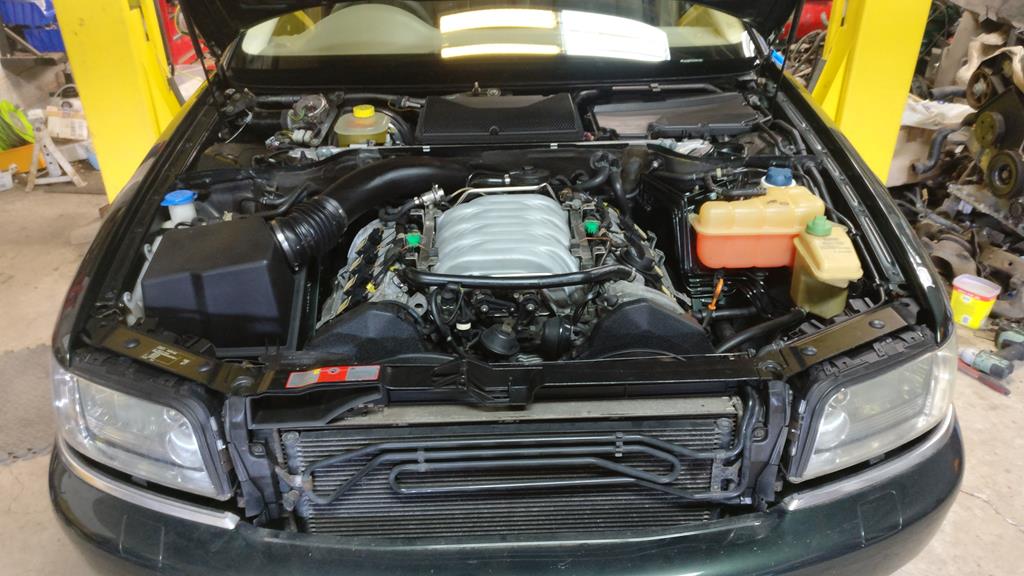

General putting-back-together today, and a new windscreen. After that was done I made a start on assessing which bits of brightwork can be recovered - some are beyond saving.
Some pieces come up ok

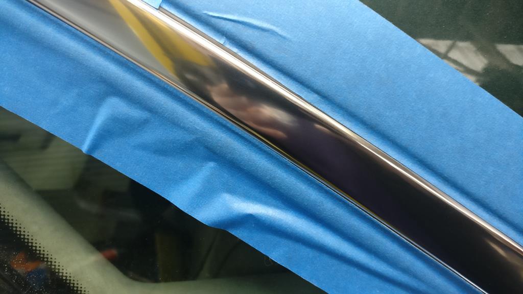

C-pillar trim
Engine bay almost done

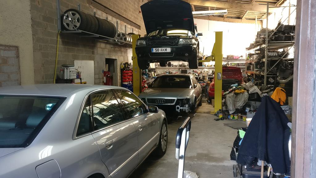

Bunk beds tonight! I'm slightly behind the plan at the moment - it was supposed to be at Nicola's today but I still need to do some more on the engine bay and interior, and finish off the brightwork.
The silver one in the foreground is here for a service and thermostat while Andrew's is off being detailed, which hasn't quite gone to plan! So, Nicola is coming over tomorrow to work on the brightwork while I reassemble and swap over some pieces which can't be saved.
