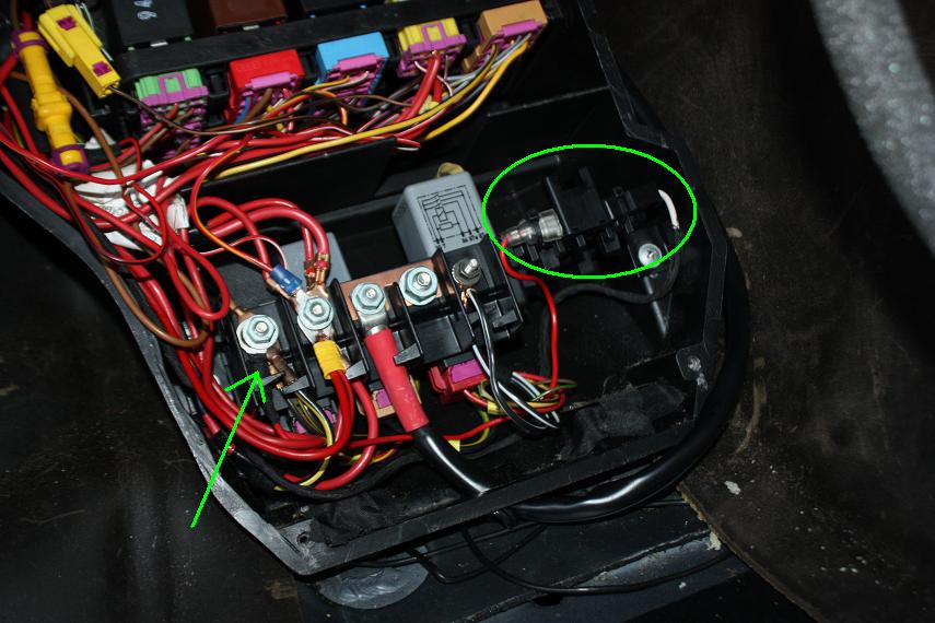

+12 comes courtousy of the passenger foot well. The green arrows shows the ignition feed, which is again easy to tap into with a quick removal of a 10mm nut. The green circle shows an independent fuse holder I have installed to make sure things are safe in case of short etc.

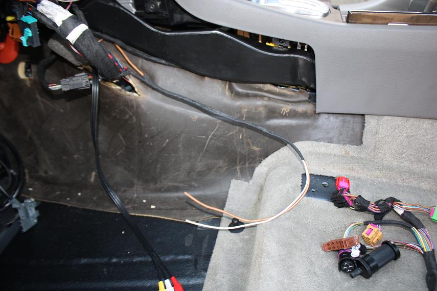

We then take the +12 round the back of the relay box and along the tranmission tunnel, where it meets it the ground. Note the use of the fabric tape to make sure the wires are all double-insulated for safety.

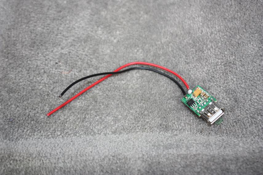

haha, ok I'm not that good - I bought one of the cigarette lighter to USB adapters and pulled it apart. I then soldered on the ground and +12 connectors to give me what I need, which in turn are soldered onto the ground/+12 feed I just put together. I intentionally ran higher rated cables than I needed for this project as I might change its purpose later. Its fused at a very low rating so will protect these smaller wires into the 5V converter
I then use PVC tape to insulate all the metal bits above, and then I wrap the whole lot in fabric tape to make it neat, and safe. Its now ready for part 2 of the install, which is the presentation of the USB connector somewhere which is 99% complete, and I'll share with you shortly..

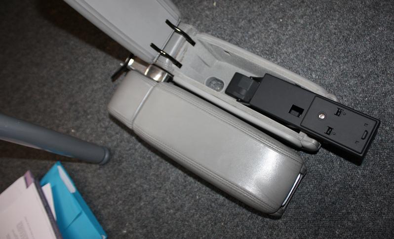

Start by dismantling the armrest. The leather trimmed side panels of the armrest just prize off, you can see the 3 lugs on the side here which need to be worked loose for it to come off. Once the sides are off, there are two small torx screws which need to be removed. They hold the plastic insert tray inside the armrest (already removed in this photo)
Once the 4 screws (2 on each side) are removed the tray should lift out and you can look into the back of the armrest and see the below. The armrest is held on by a locking pin which is in turn held in by a single torx screw. Remove the torx (circled) and then pull the pin out by pulling it towards the front of the armrest. Not the armrest is in the 'down' position before you will see this screw and pin.

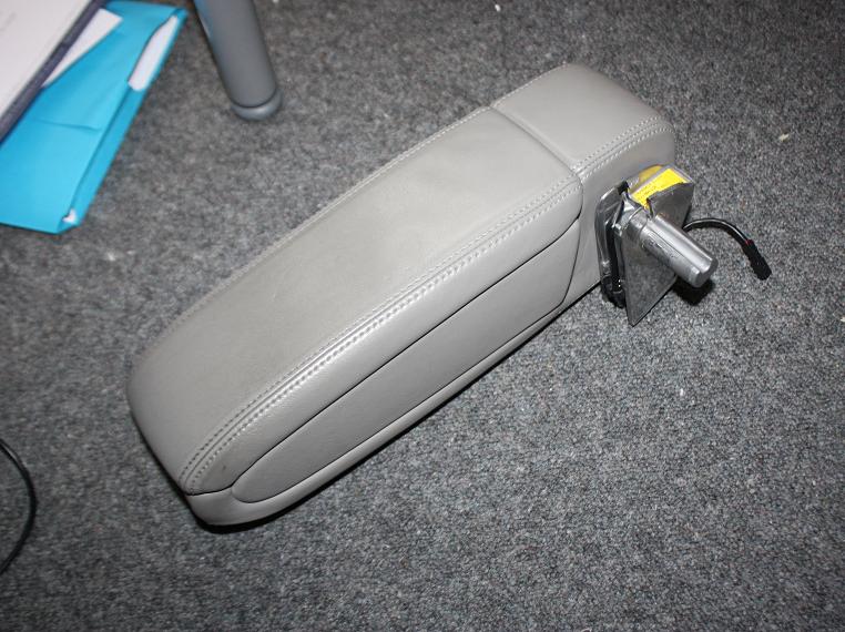

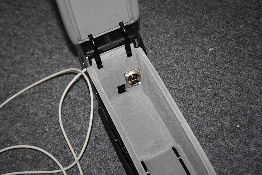

The USB surface mount panel came from Maplins and requires a single round hold drilling, and then it taps in with 2 small screws. Its quite deep though and some care is needed to make sure that the position it is in doesnt foul on anything when the plastic insert is put back in, and also check the lid goes up and down too !! There is a metal wall right in the middle of the armrest behind the tray hence the install to the right hand side...
You could just run a cable in and leave it dangling, but that wouldnt look as good...
The square hole is from the original cable that was factory fitted. A square grommet will fill that hole back up again.

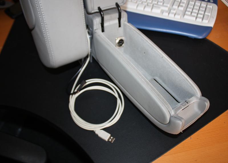

Once all apart, feeding the cable through is a doddle. Feed it in from the shaft side and it will pop out freely inside the armrest. Once its in place, you can start to re-assemble using the reverse of the steps followed so far:

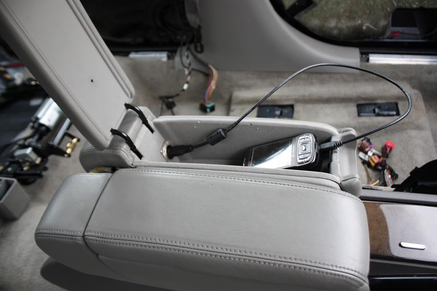

I fed the cable down the center console and plugged it into the ignition fed USB connector we left dangling before. Once connected it was all fabric taped up to stop rattles and make sure it doesnt come apart accidently. This is what it looks like when installed:
And a final check, pop in a USB powered phone and check it charges when the ignition goes on:
