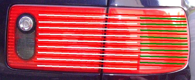

Having tinted them I thought I would move on to the next level and have a look at opening them up to have a peek inside and see what's possible with an LED mod.
So with dremel in hand........
I originally tried to heat the joint and soften the glue. however, it also softend the plastic and deformed it a bit. So I switched to the dremel. That also generated heat which has discoloured the plastic. If I do this mod for real I will probably use a junior hacksaw blade to minimise damage on opening.
I have a few dozen cheap LEDs to mock up the final array. I'm thinking of making the whole of each side being capable of being rear lights, brake lights and fog lights by having increasing intensity LEDs for each function. With the lenses now a uniform red I will use green LEDs for the indicators.
Red lines are rear side lights. Green for indicators and White for higher intensity lights, Brake and Fog. Lights would increase in intensity so that Fogs would be brighter than side and brakes brighter again.
Don't expect a quick result on this as it is a side line to some other work I have ongoing. But I'll update as and when.
