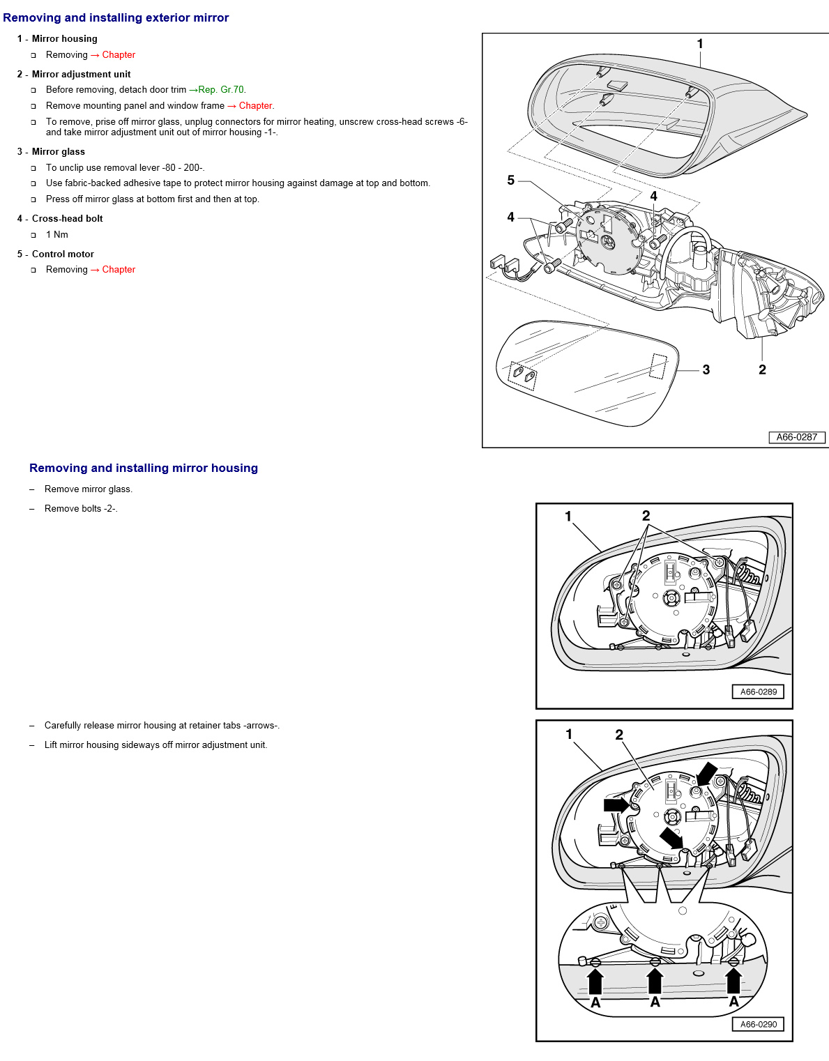

Can anyone/someone tell me how to remove the driver door mirror cover, is it a simple job and are the clips prone to breaking? Pics would help

Does this help?

Old 3rd September 2015, 03:16 PM
Awesome thanks

How to can be found here:
http://forum.a8parts.co.uk/showthread.php?t=7051
It's pretty easy

Old 4th September 2015, 08:26 AM

put the mirror heaters on first getting it warm will help
i was told this by a master tek at audi and it works

Mirror all repainted now, decided to let Audi do it themselves so if anything broke they would be responsible. Dropped the car in this morning and collected it at 3:30 this afternoon. Also had the plastic shield put back on yesterday, the usual "not sure we removed that part" so they were very non committal but sorted it out and gave me 4 extra pins should I ever have the need for them, just in case 'it falls off again'
