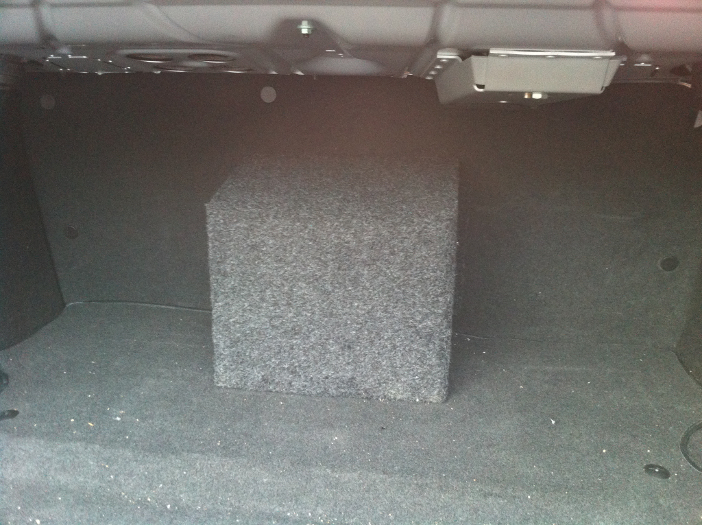

This weekend I built a box for a JL Audio 8W3V3-4 8" subwoofer and fitted it in the ski hatch (having angle grinded out the panel last weekend!):

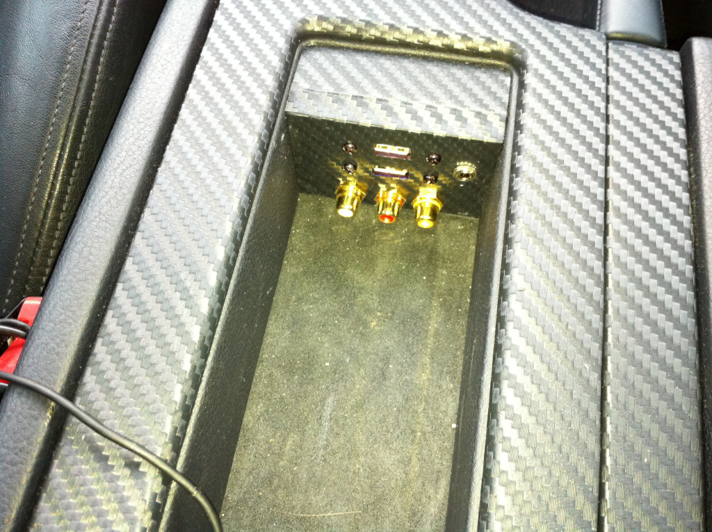

After that I decided to add an AV panel into the middle consol. This has RCA inputs for the headunit (Aux 2) and a stereo jack input (Aux 1) and a USB input (which also does the ipod) and finally a USB socket for charging any device:
I'm really pleased with the result - I've aimed for subtlety and the resulting sound is fantastic. (I also changed the electric aerial for a whip one - similar to the S8 style)

Im not a big fan of aftermarket installs, but credit where credit is due and that looks very good indeed...
I like the tidy integration, the center console looks fab...
I'm thinking you'll quickly get queue of folks wanting to do the same
He will. me for one. Top install Jeremy and subtle to boot.

Great write up, have you changed your wood for carbon fibre? Any more pics..

Thanks, looks great and so much better then that vile wood.

Very tidy install indeed. My old rover 600 use to have a 12" JL Audio sub in the same position ... with the armrest down, it sounded amazing.
Overall, great eye for detail on the interior. Would love to see this at one of the next meets mate...
