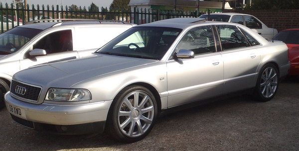

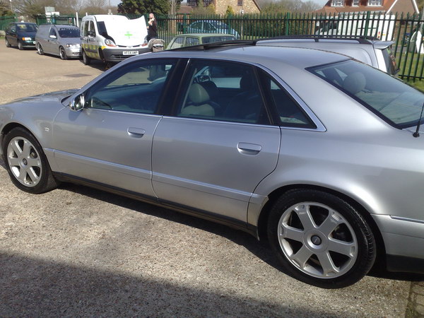

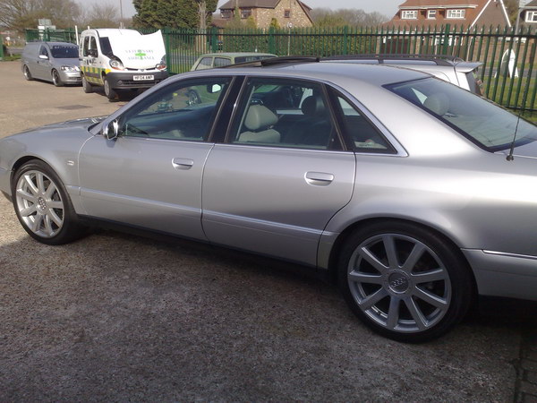

Cool They sure do fit ... :-)
Couldn't resist them ...
They look awesome, fit perfectly, though I will probably stick 5mm spacers on.
Will post better pics when I have them.
Very nice mate.
Zip
