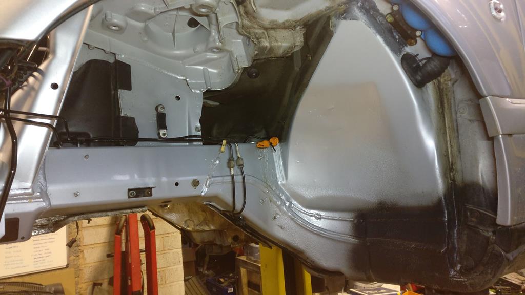

The wheels are back from refurb:
Nearly finished cleaning
Tunnel before
and after

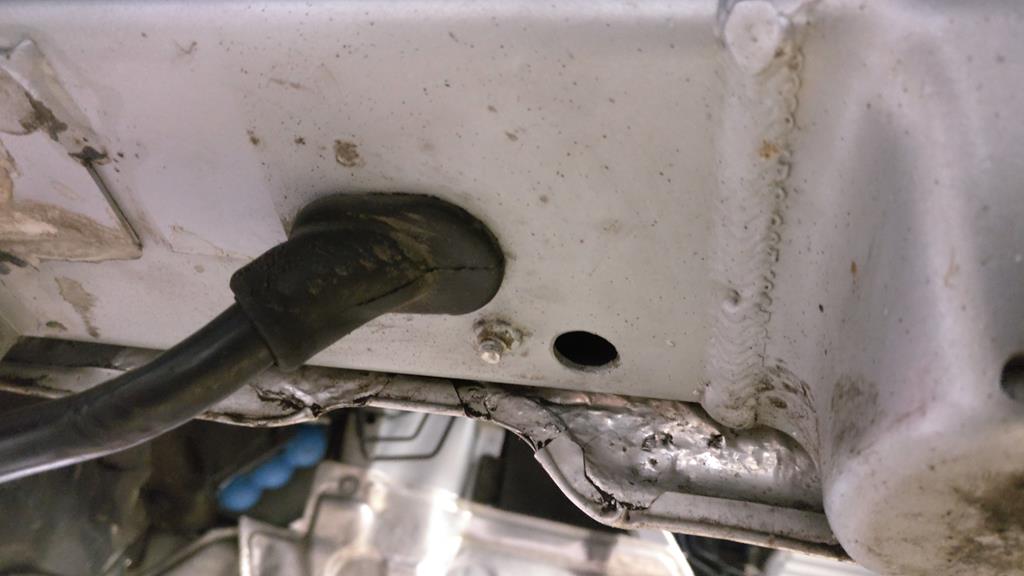

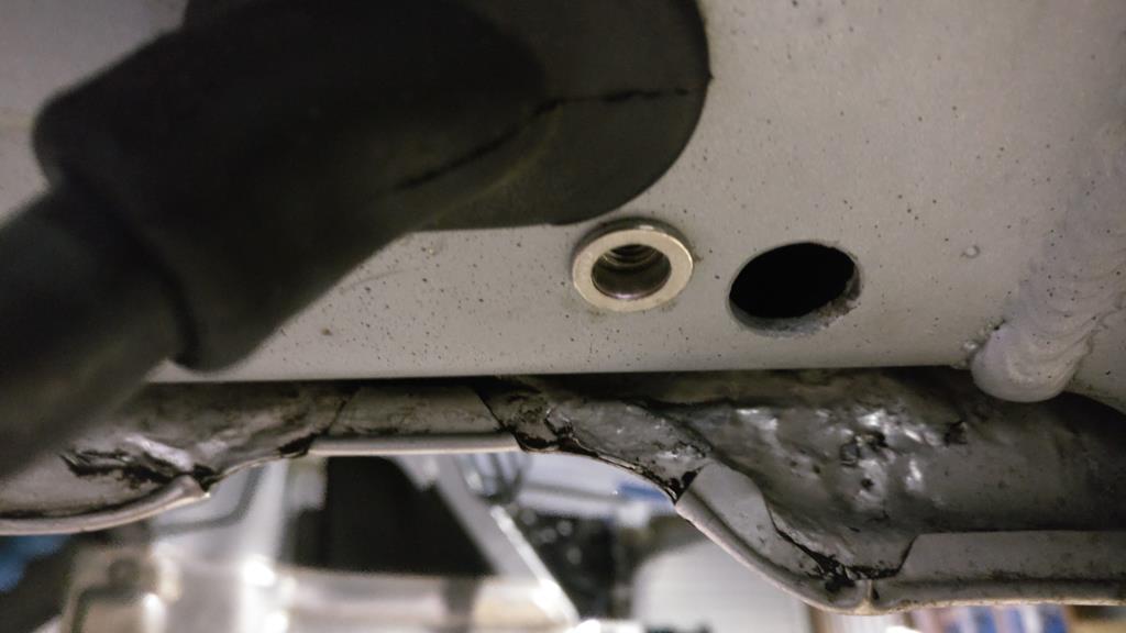

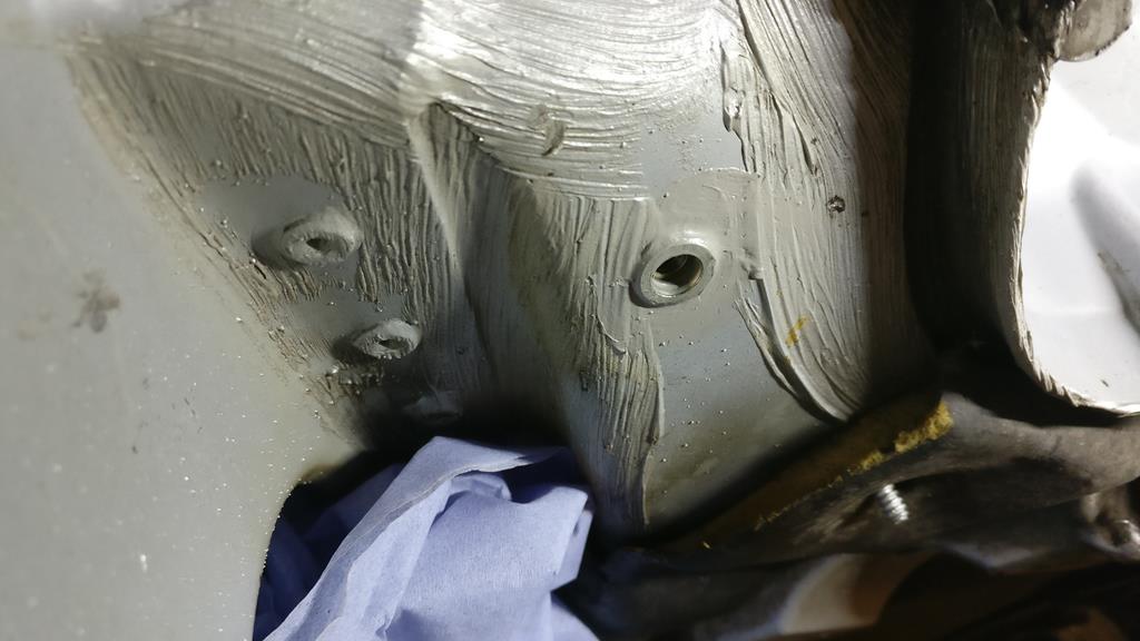

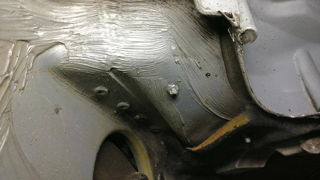

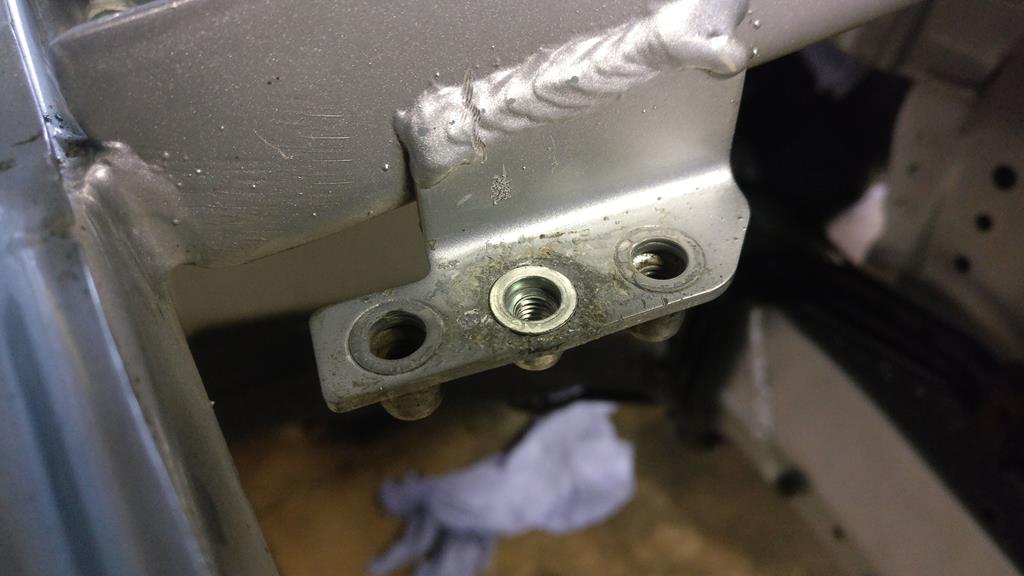

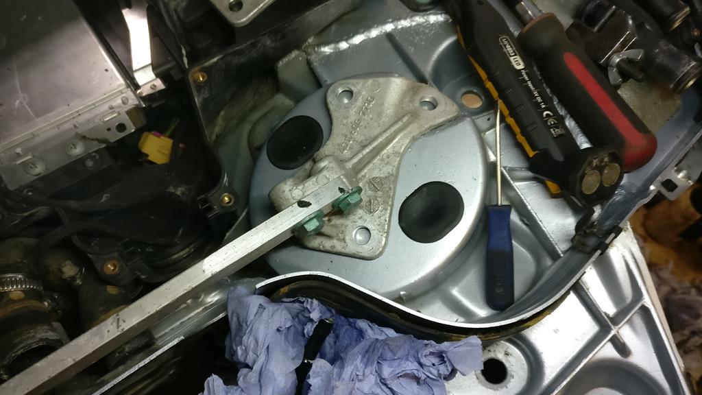

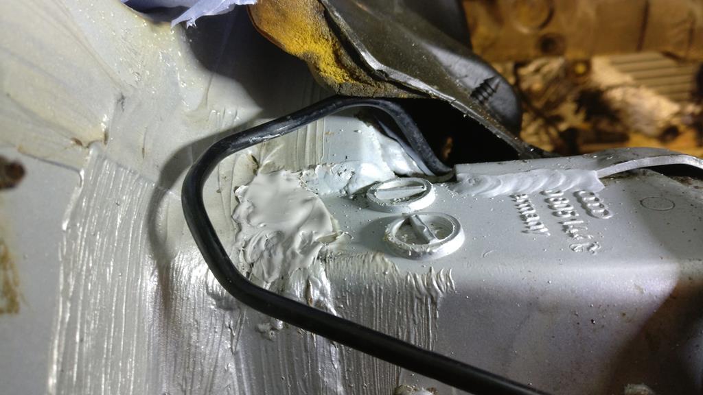

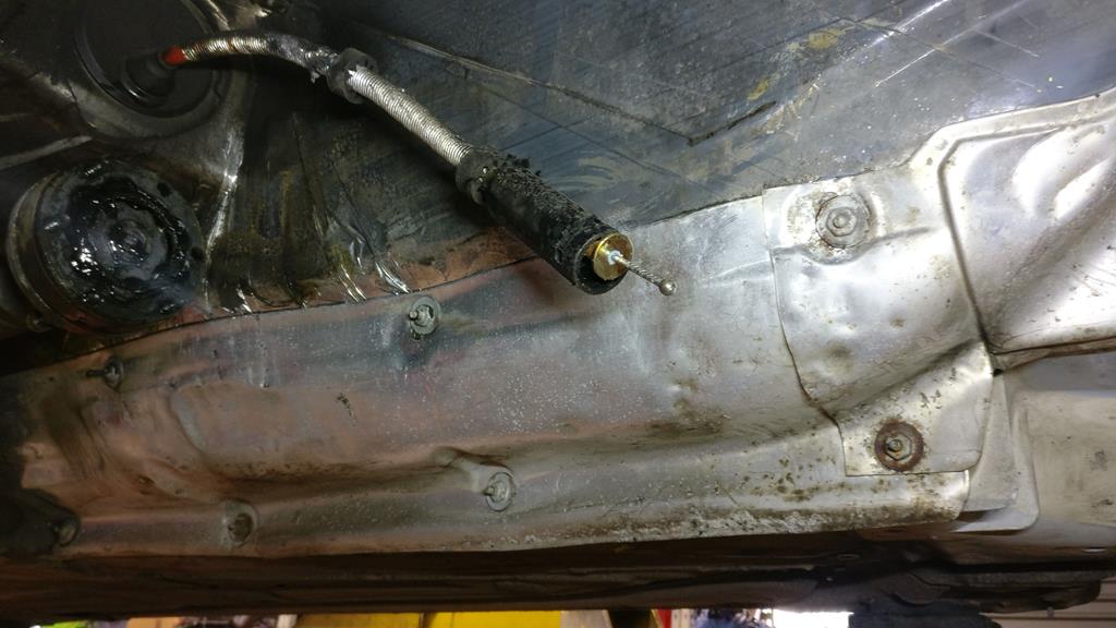

The stud by the power cables broke off as usual
Drill a hole
and fit a rivnut
This stud gets in the way of removing the servotronic rack but conveniently broke off when I removed the plastic nut, which is actually a bonus

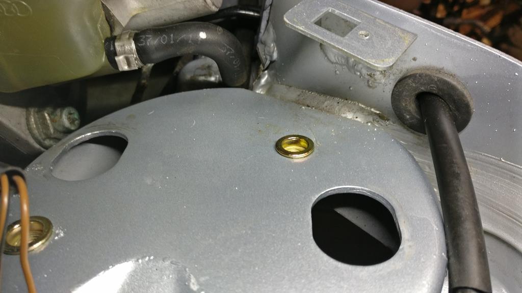

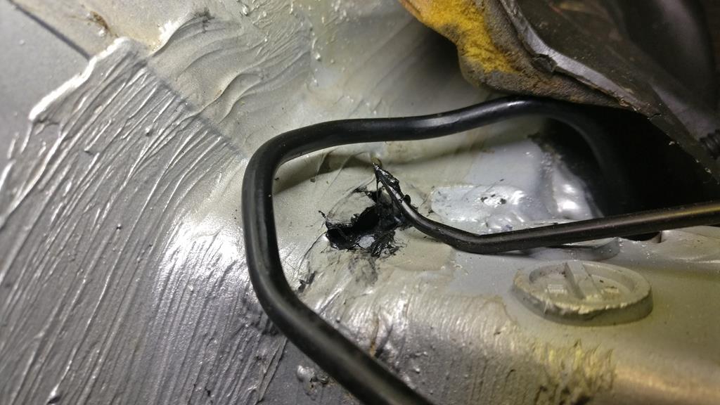

Drill it out
and fit a rivnut again. This one protrudes in to the raintray so its a blind rivnut rather than the open type, and bedded down on seam sealer

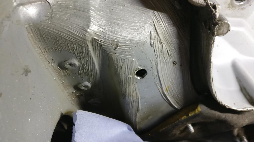

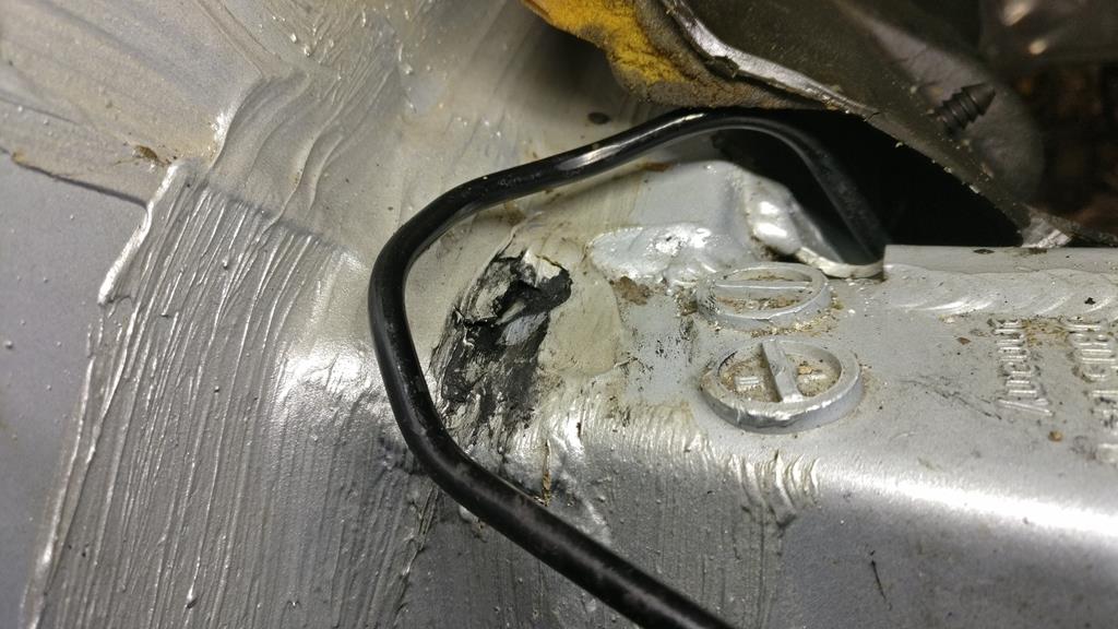

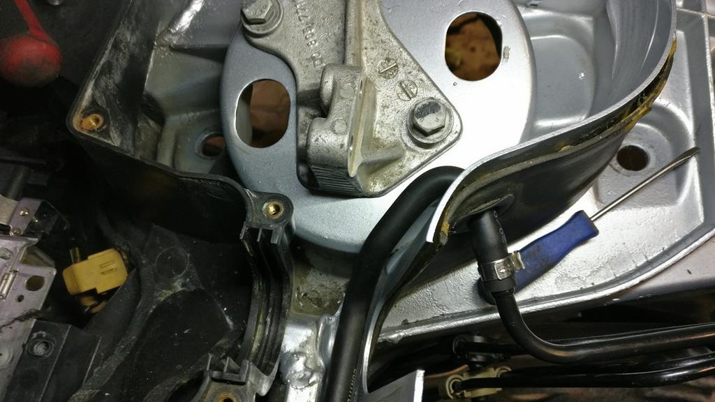

The PS fluid has got in to the seam sealer here and dissolved it
Fish out all the sticky stuff with a pokey tool
Fill in with new seam sealer

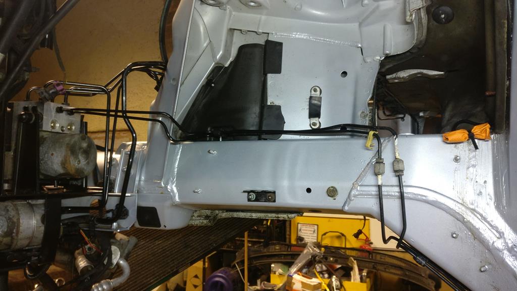

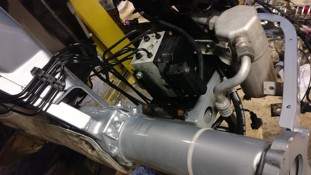

Plotting to fit an FL upper brace so that I can also fit a brake block. Given that the PF S8 has the same brakes as the A8 I think it definitely needs all the braking help it can get, and the HP2 calipers with a brake block is a decent enough system.

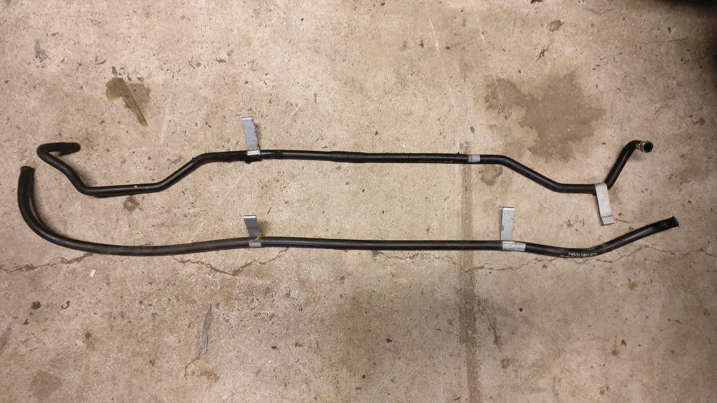

The ESP return hose is in the way so I will fit an FL hose here

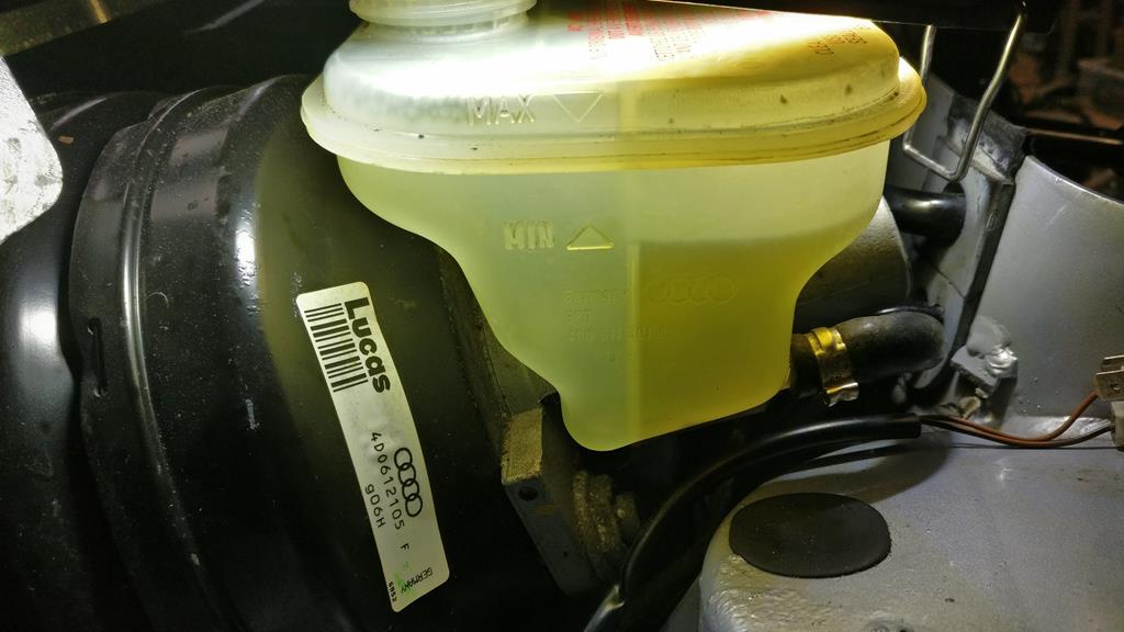

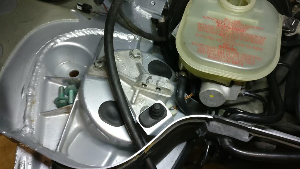

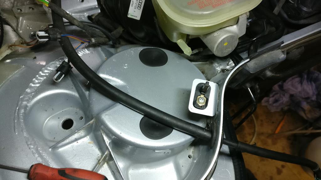

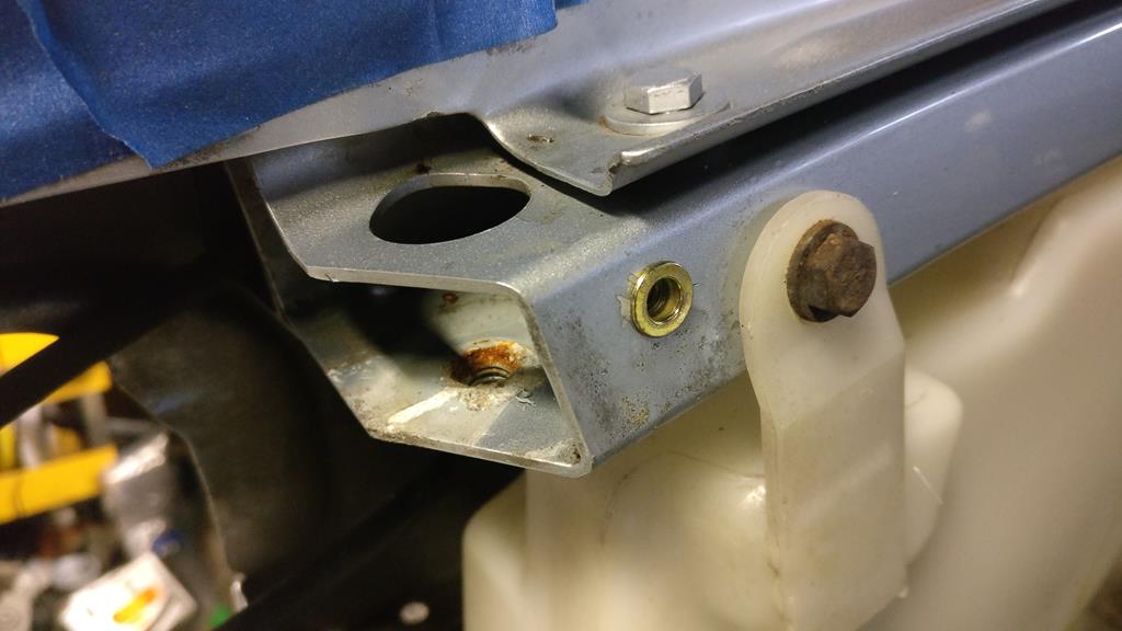

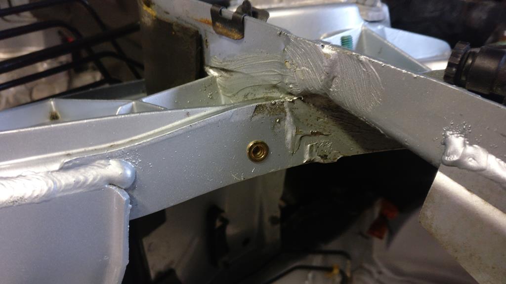

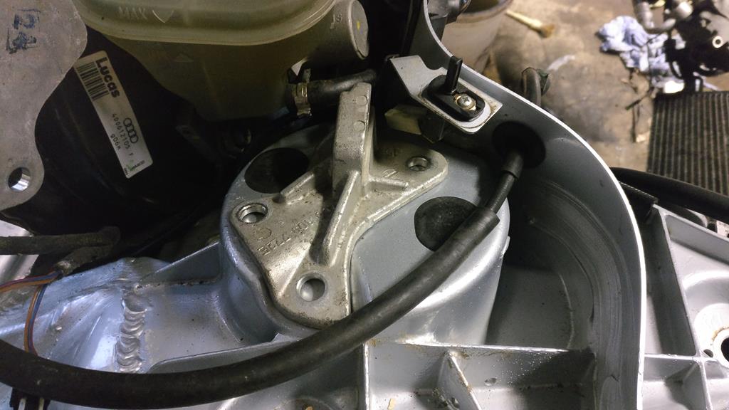

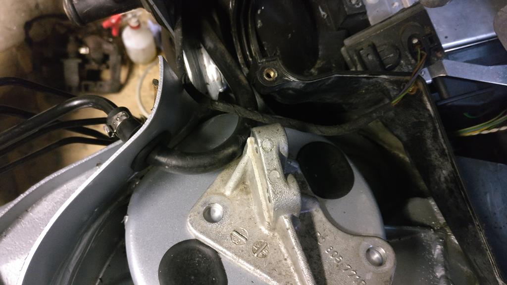

How to fit a brake block to a PF...

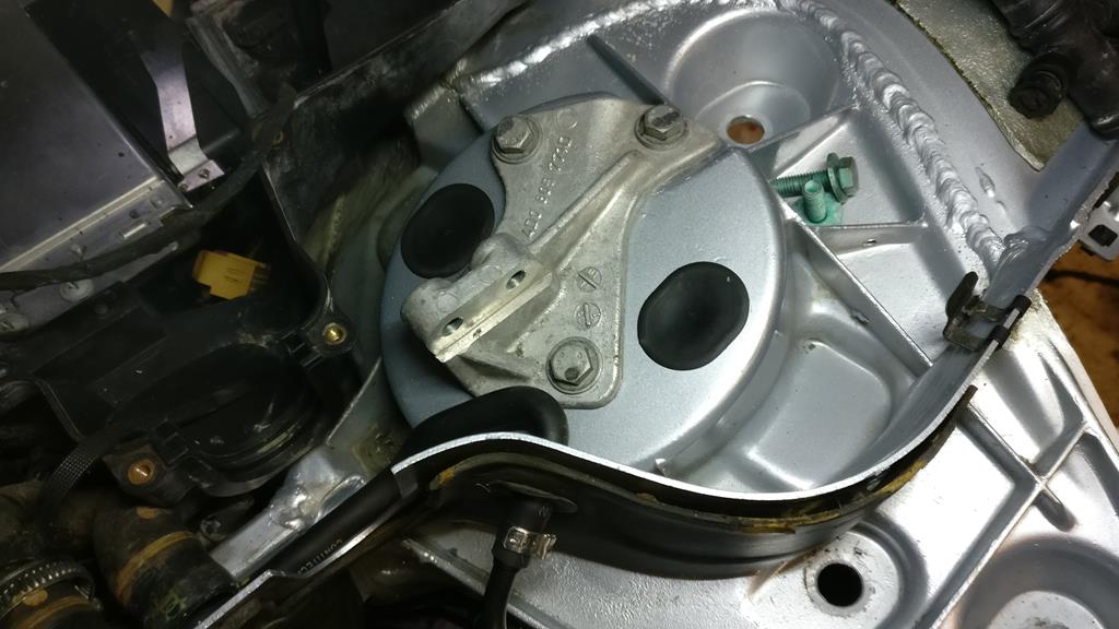

Don't need this for a start - its not doing anything and in the way

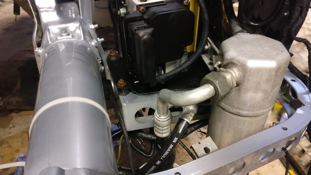

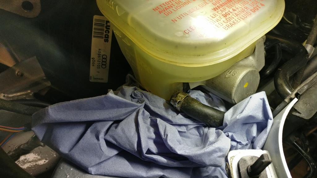

The ESP return hose is also in the way. Interestingly that goes from the front of the reservoir straight to the rear chamber which was unexpected. Of course having just filled it with fresh fluid I now have to remove most of it Never mind. Its not expensive.
Remove this connection and the one from the hardline on the other side, being careful not to spill any fluid on the nice clean paint!
FL hose on the top, PF on the bottom. The PF hose is just a bit of plain clutch hose, whereas the FL is deliberately moulded to clear all the stuff in the way, such as the brace.

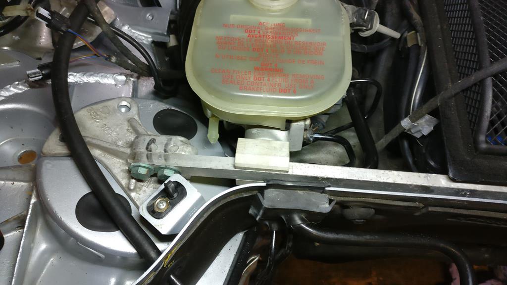

With the hose and superfluous bracket removed there's room for the brace hardware
Test fit with a brake block
Clamp in place to mark the holes

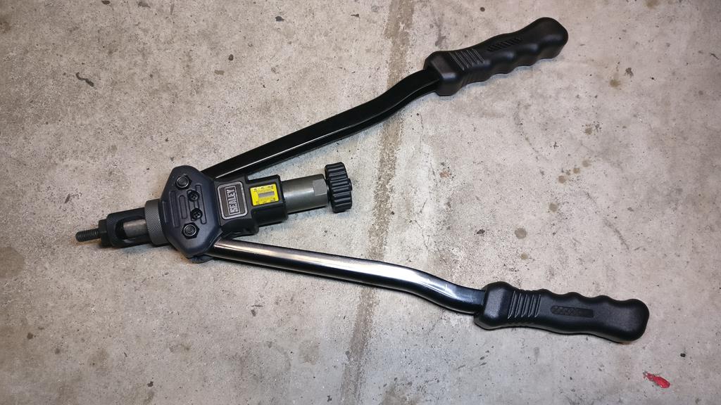

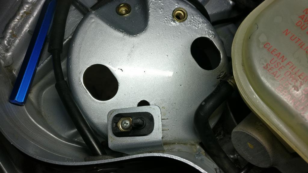

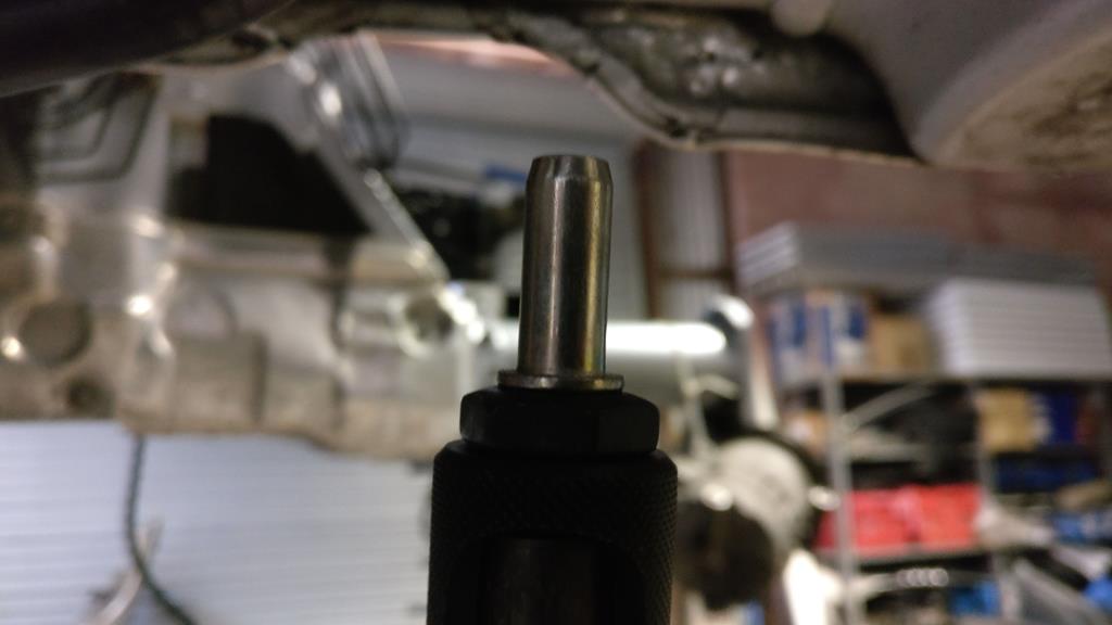

This is the rivnut tool. It'll set up to M12 without a problem.

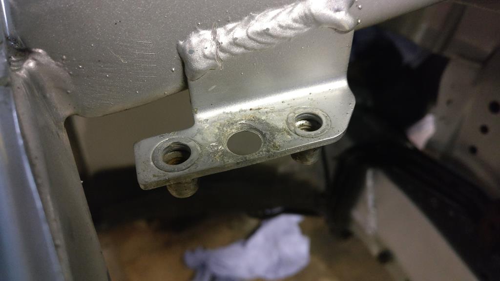

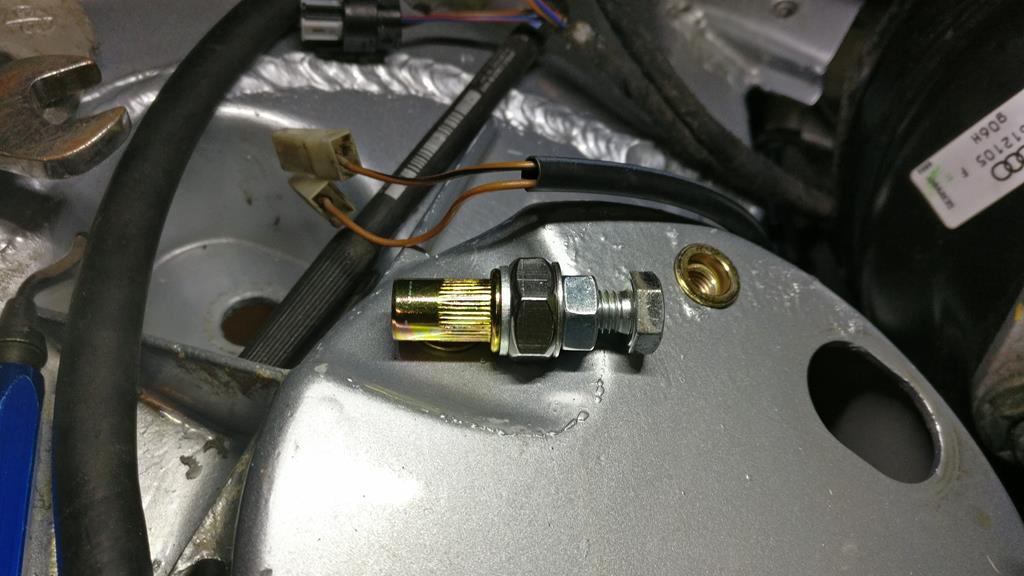

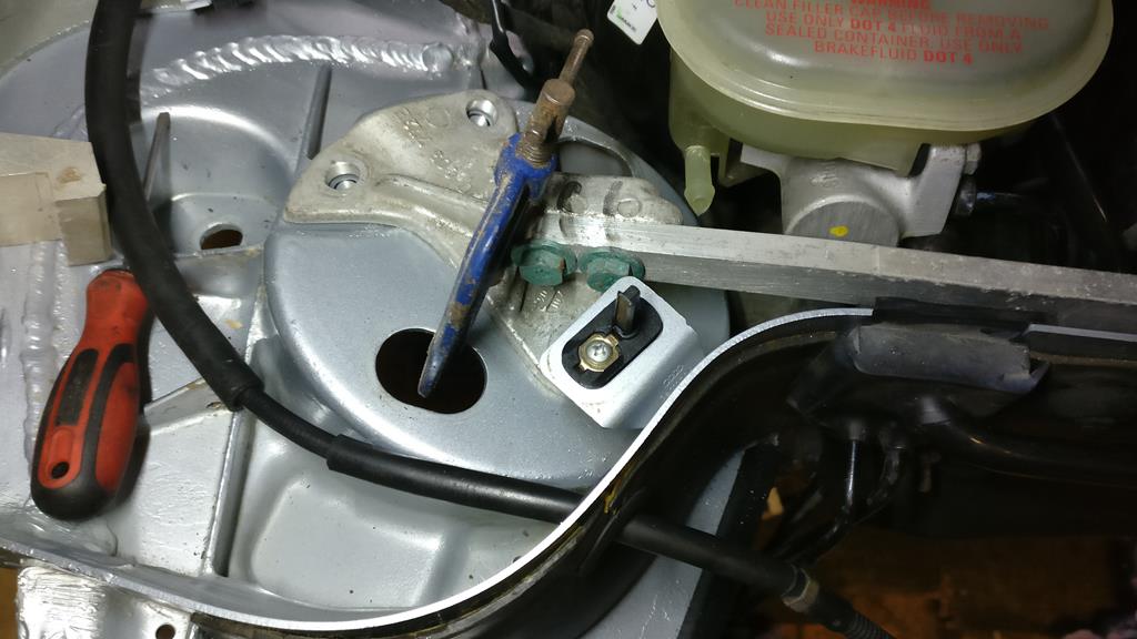

Five of six rivnuts in place, but the last one is blocked by the bonnet switch. This bracket is to the far left of the frame on the FL, clearly moved so they could get tool access to insert the rivnut.

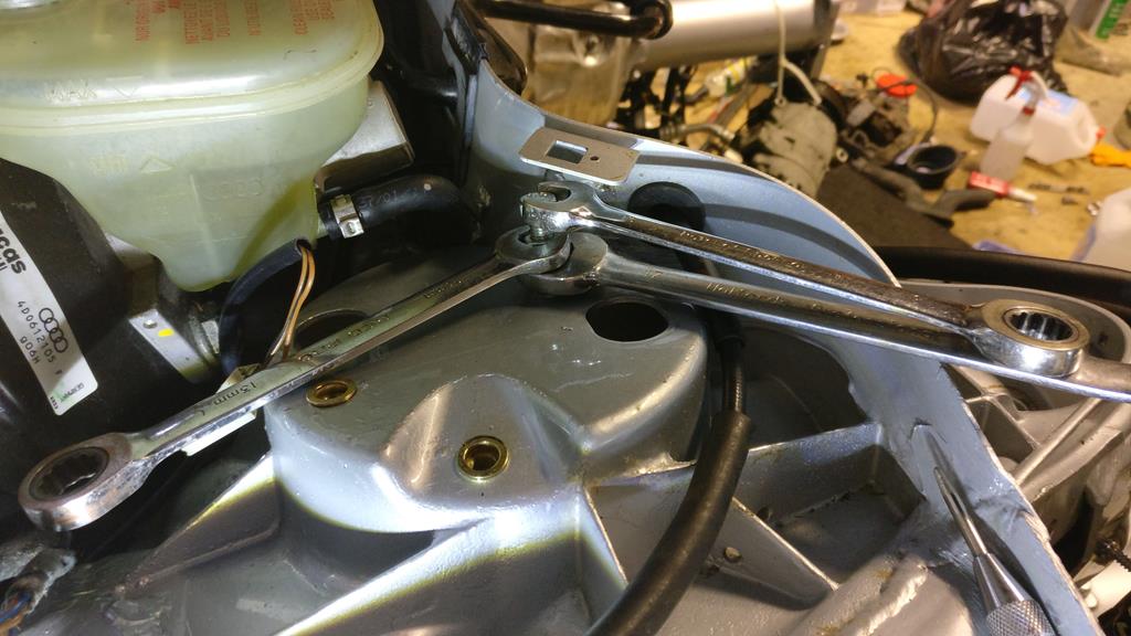

This one will need to be set the old-school way. The nut in the middle compresses the rivnut against the larger nut at the left, allowing it to be set with spanners in a much smaller space than the big tool needs
Hold the bolt and the large nut with two spanners while tightening the small nut with the 3rd spanner
Done

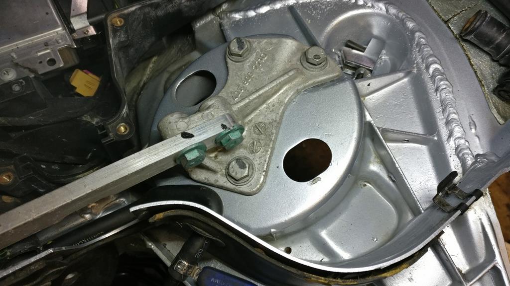

ESP hose back on
Proper clearance now

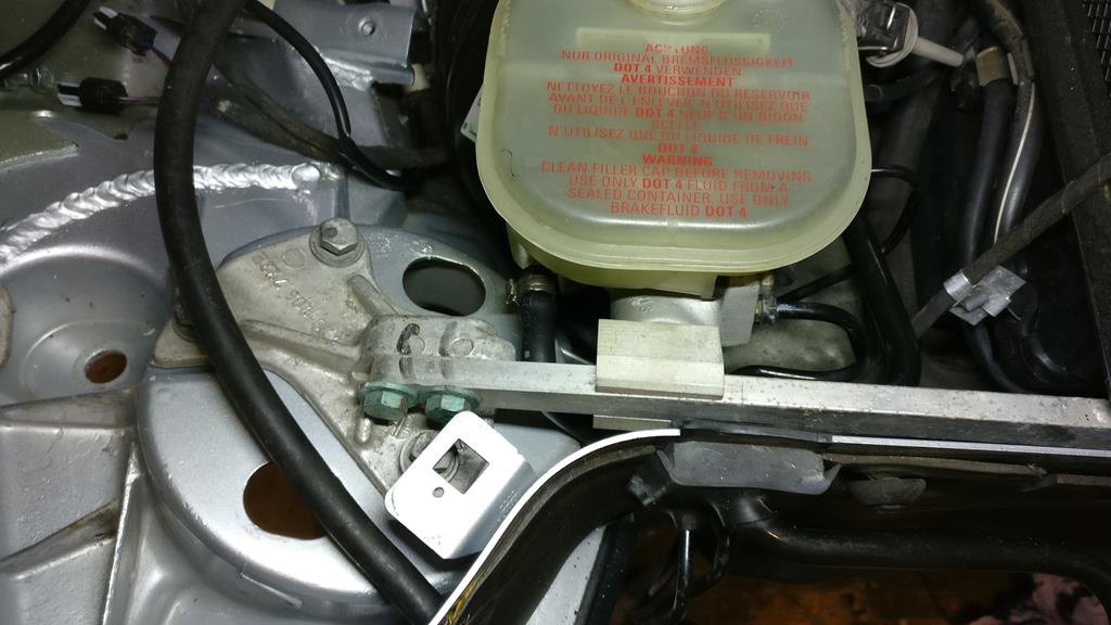

Bolted in place with the brake block
Brackets left in place but the bar is removed as it needs to be out to replace the wiring harness when the engine goes back in. The inner bolt for the bar is still a little tight on the bonnet switch, but its not like the bar comes out very often so it won't be a problem
I've never seen this done before, and these parts are only listed for the FL so this might be the first PF with an upper brace and brake block?
Done
More attention to detail. Most mechanics would just bend the switch bracket out of the way to use the rivnut tool. As for the spanners, are you tri-dextrous?
  #49
Old 19th August 2021, 11:12 AM
It didn't even occur to me to bend the bracket
If you get the orientation of the bolt and larger nut right then both those spanners can be held with one hand while tightening the smaller nut with the other

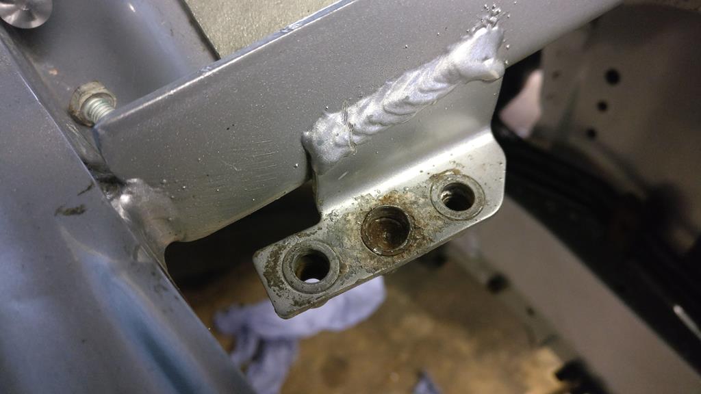

More rivnuts This is what remains of the screw holding the airbox trim
grind the stump down so I can get a drill on it
Drill out the bolt and the top bit of the rivnut
Remove the rivnut
Ta dah!
