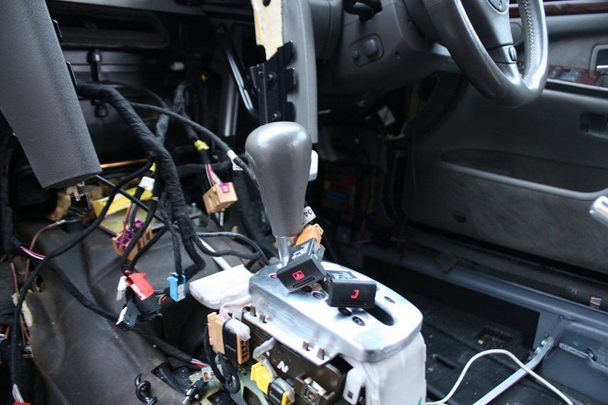

One of the pending items has been to install the extra switchgear. My car was 'poverty spec' with hardly any options, so I needed to add the blinds switch in for the rear blinds that were fitted, and I also need the switch in for lowering the electric rear head rests.
Both switches require independent connections to the rear of the car to do their job, but also require connections to a suitable ignition feed for the +12 for them to work, and also a connection for illumination. As the car was mostly apart, I removed the whole center console, stripped the wires back and connected these in as far back as possible, re-taping up afterwards. The result? Factory looking cabling, and here we have a quick test to see the illumination working, so I must have 2 wires per switch correct anyway

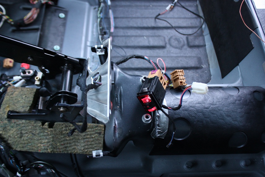

My second problem swichgear is the rear seat heating. These switches are a pain as they are out in 'no mans land' as far as wiring is concerned. No wiring runs over the tranmission tunnel between the rear center vents and the rear seat, so tempting as it is to go directly across there, I have avoided it and gone all the way round instead. This also enabled me to pick up the relevant illumination feeds too on the way round, and again a quick check here once all done:
One thing that has become clear in this project is understanding how something is supposed to work, only then does it become clear how to wire it up. The wiring diagrams are great logically, but physically routing through cables is a whole new ball game. A test meter has limited use too as so many wires are +12, some of the time. But when? For examples, switchgear only illuminates when the lights are on, fairly obvious, but the rear seat auto-retract only works when the relevant rear door is open. The passenger seat in the front only moves from the rear if the drivers isolation switch isnt pressed. The blinds only work with the ignition on, but the rear seat heating only works with the ignition on AND someone sat in the seat.... A nightmare really, but I think I've got it all sussed.....

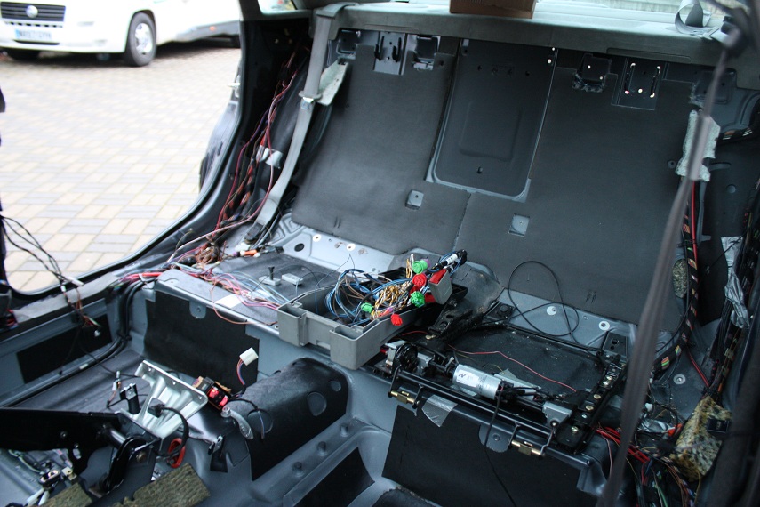

Here is a shot of the back of the car at the moment. 95% of the interior wiring is now home and in place. I've got a few ground connections to make, and the spaghetti in the center of the rear seats to shorten and neaten, but apart from that the front end is all in place.

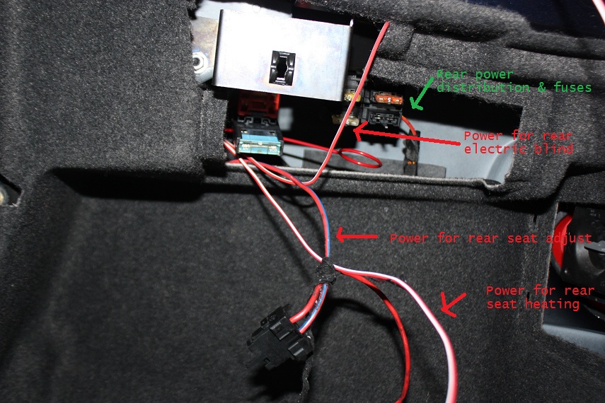

The power for the rear seat electrics, and rear seat heating is independently fused from the distribution board at the rear of the car. I have also decided to feed the rear blind supply from here also. From the factory, the blinds would be fed off an independent fuse down by the drivers footwell, and to be honest it was just easier to run it backwards to here, rather than forwards all the way down there, so I now have 3 wires popping out in the rear that will need hooking up to provide juice. Other items that connect here are the Audio system and towbar power (where fitted)

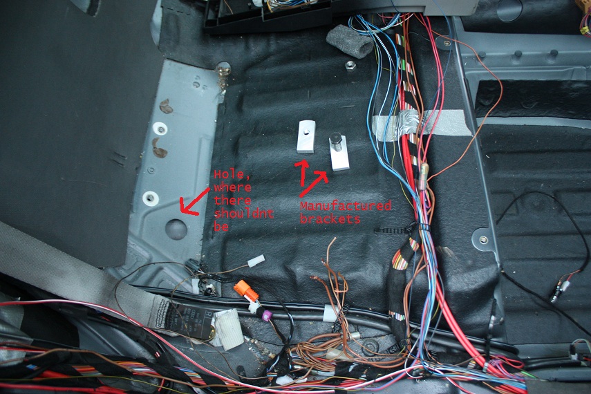

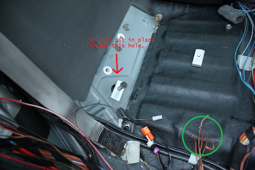

Back to my engineering problem of 4 bolts and only 3 threads for the rear seat frames, I've finally got this one in the bag.
The original Audi seatbelt bolts were some rediculous thread, 11.127 x 1.17 or something equally unrealistic, and this was a stumbing block for a while. I wanted to keep to the original Audi design spec for bolts / threads where possible, especially where safety was involved. Finding this size tap though was going to be impossible.....
.. or so I thought, it turned out to be imperial, a 7/16" UNF thread to be precise, so once I'd tapped my ally bars with that thread my original Audi seatbelt bolts now fit perfectly. The bars will slide inside the original holeand brace up against the body. The more I tighten them, the tighter they will get....
How it will sit, and green circle marks a wad of earth wires I've yet to mate with the chassis...

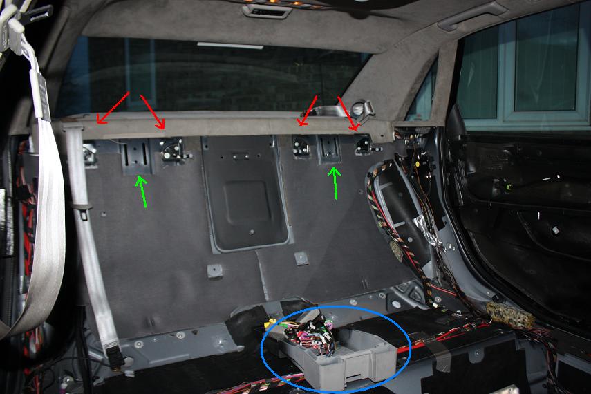

Old seat hooks have been removed (green arrow)
New seat rollers are installed (Red arrow)
All wiring to central seat box is now present, cut to length and good to go (blue circle)
