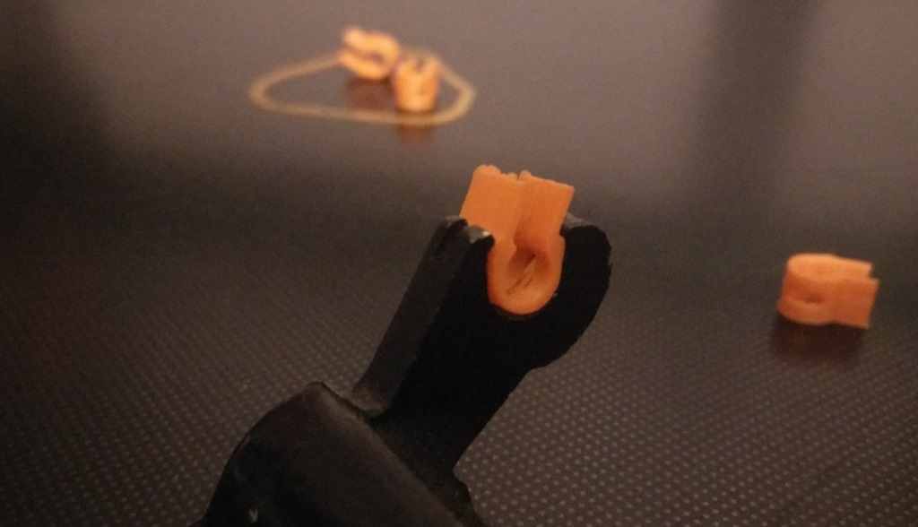

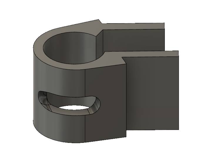

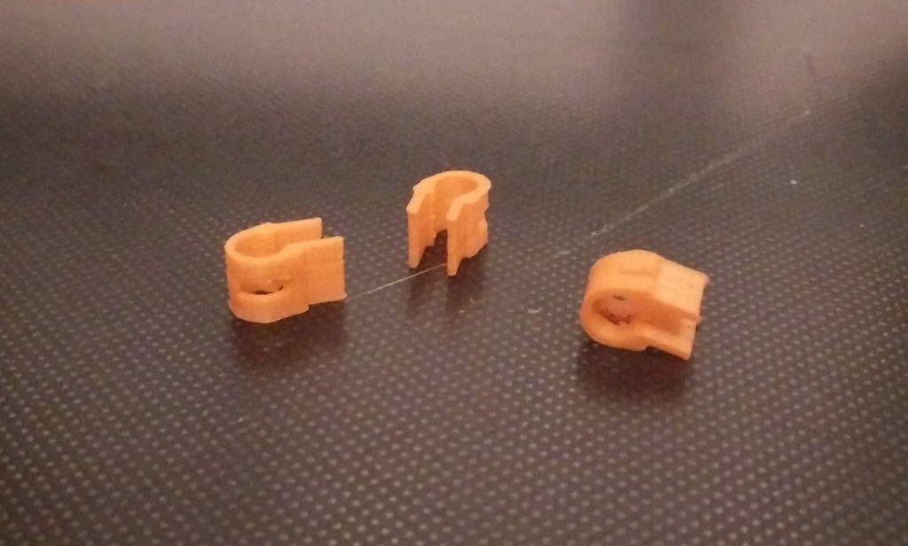

Knocked up the NLA door handle clip in Fusion360 this evening and printed a couple of prototypes:
Needs a bit of fettling but its a good start.
And a lot more easier to spot when you drop them.
I can't now recall exactly how all the parts fit together, but I wonder if there's any way of changing it slightly so that it still does the job but is less likely to fall off?
A couple of little protrusions somewhere that mean it slightly clips in rather than slides in?
Partner that with some door clips that are more reusable and you could have a little repair kit that would sell profitably.

I was pondering that while drawing it actually. There's a tiny little nub which is supposed to hold it in to the handle, but given how loose it is, the nub obviously isn't enough. Its much more square on my printed version so that already holds it in better, but there is plenty of scope to make it larger and I'm also tweaking the design so the whole clip is a tighter fit in the handle. All of that should make them considerably less likely to fall out, and the choice of colour was quite deliberate

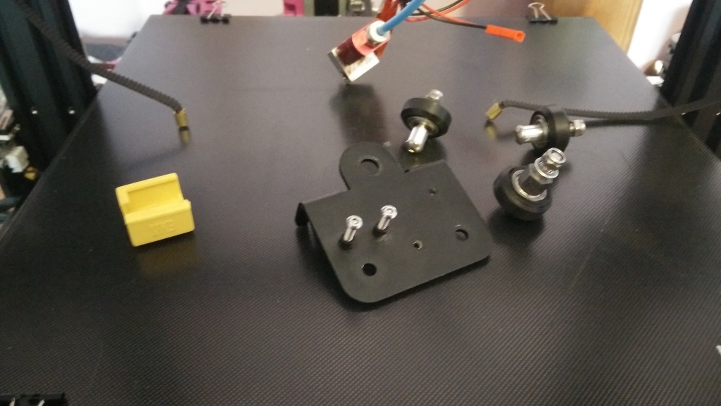

A Raspberry Pi camera just arrived so I can keep an eye on the printer without having to sit in front of it so I went to change the filament to 'printer parts purple' and noticed the hotend was a bit loose (might explain why my ASA print last night was so ugle). Dismantled it to tighten the screws, but its actually the two threaded nutsert things which are loose in the X-carriage That doesn't appear to available as a spare part either.
Poop.
