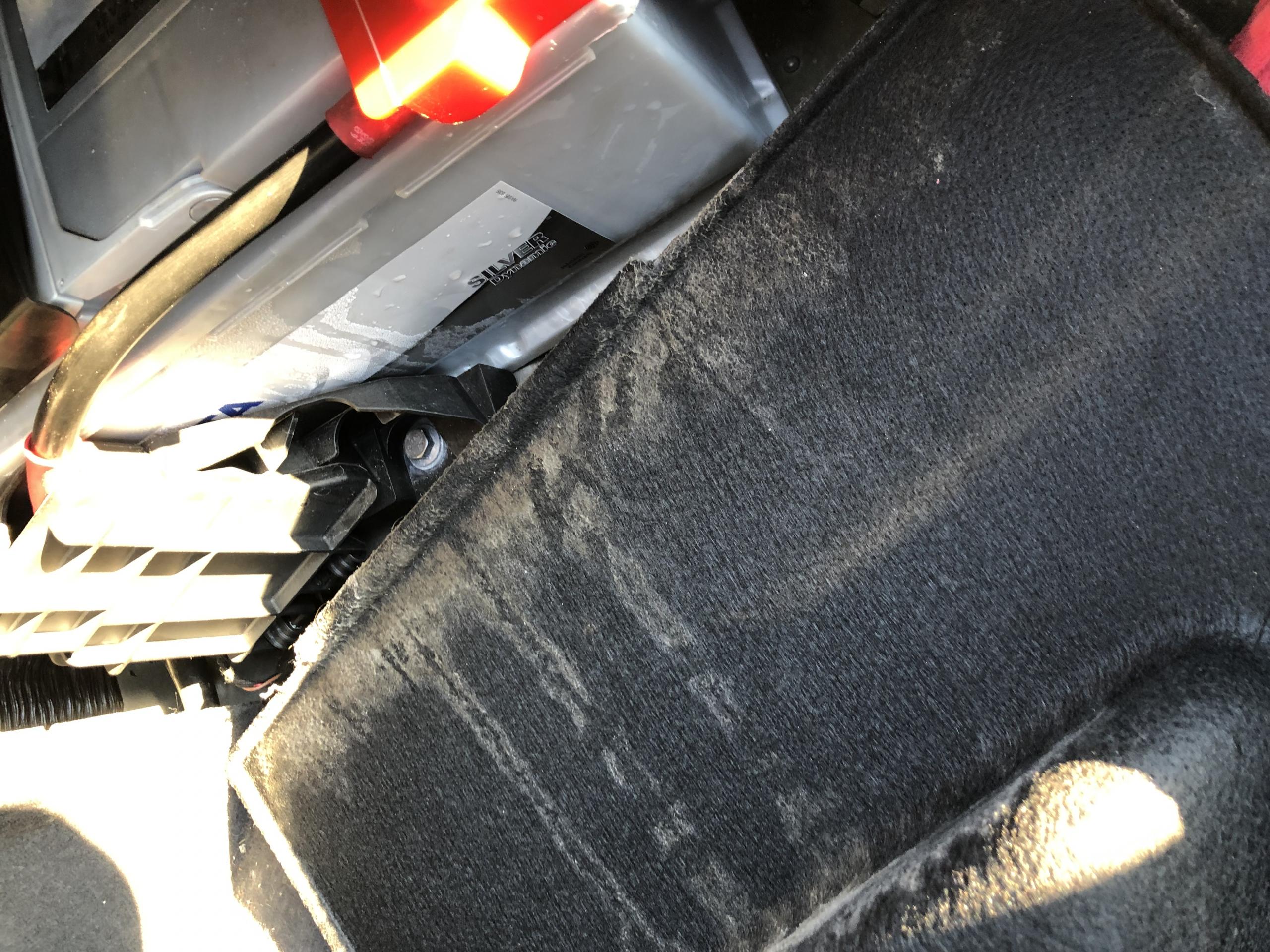

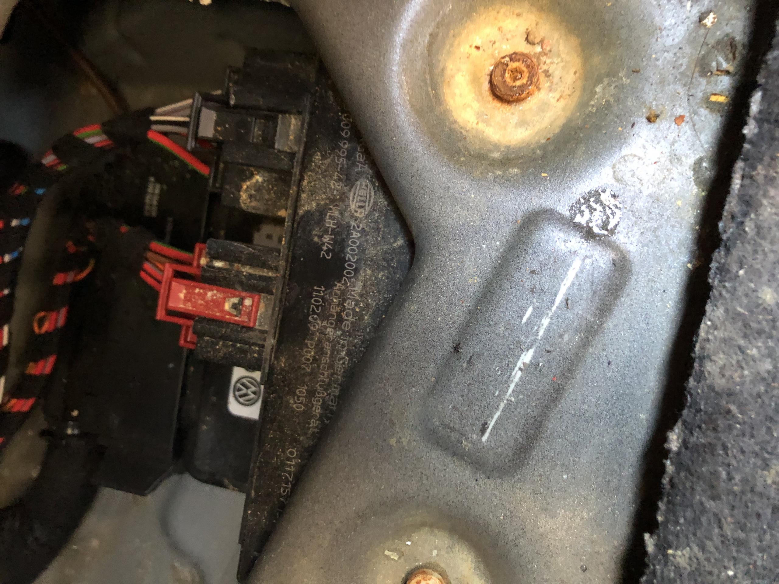

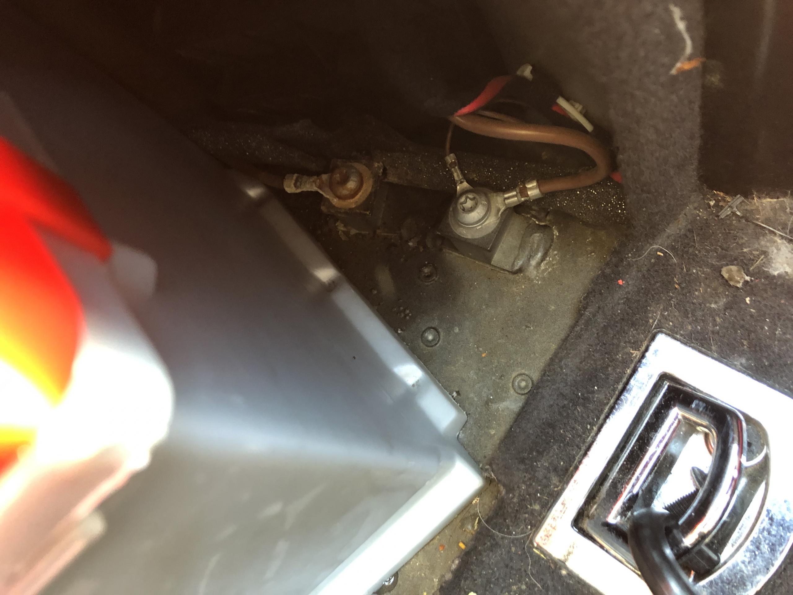

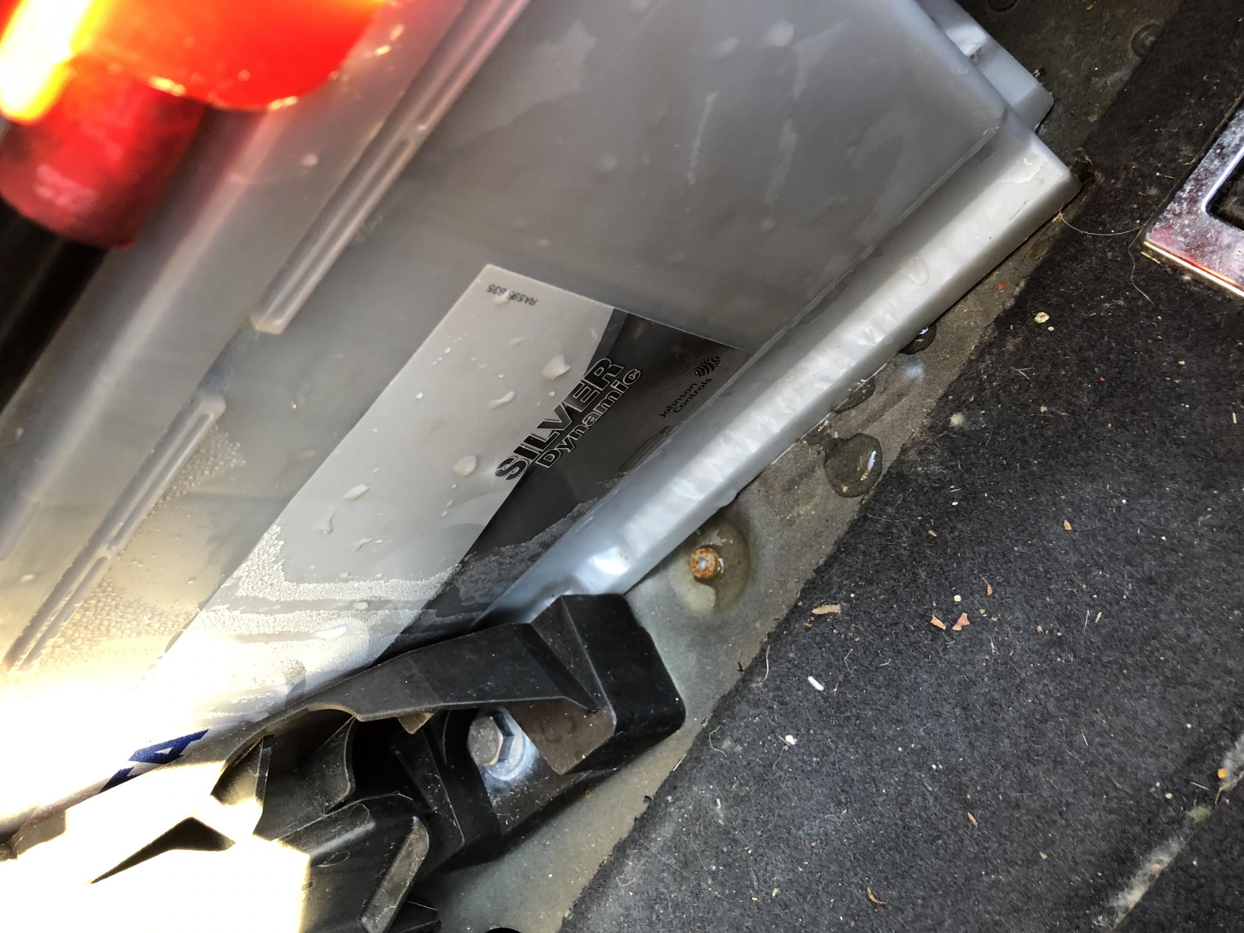

Leaking battery - I took the battery out and everything underneath is covered in a light film of battery juice, lots of yellowing and corrosion. The corner of the boot closest to the battery was dampish. The outside of the battery was wet.
Please see photos. Any ideas what those modules are? I have disconnected and checked, visually they look ok.
Do we think I have found the culprit?
I hope this is going to be ok.

Old 15th February 2019, 03:01 PM
Posts: 1,669
Wow, never seen that before. I would put sodium bicarbonate all over it to neutralise it. Does the battery have that 5mm hole in the end that that pipe plugs into like the original? Did it come out?
Do you think it boiled up or is it cracked?
