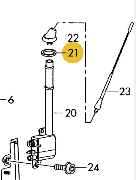

Old 3rd September 2024, 01:49 PM
Where does the O-ring go? I didn’t come across one when I took the antenna out.
Old 4th September 2024, 08:24 AM
Posts: 3,233
It looks like it just sits underneath the grommet, next to the body work.

Old 4th September 2024, 12:43 PM
Thanks Sean. I’m sure there wasn’t one there when I took the grommet off. Instead, the grommet was partially split so that it fit either side of the bodywork to make the seal

Old 5th September 2024, 09:47 AM
Posts: 3,233
Looked up the O-ring to see what it looked like i.e. to see if it was split as you mention, but even the one on the Audi Tradition site is just a normal looking O-ring. Also checked the size and it's listed as being 11x2.5mm. Going by the dimensions, I'd say the previous image I posted is possibly misleading, as it shows the O-ring being the same size as the grommet, whereas it might be just big enough to fit the hole in the bodywork. Not sure if that helps or not.
